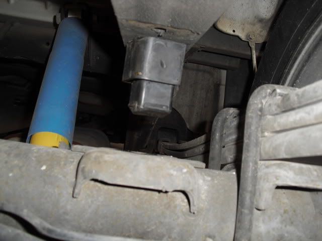

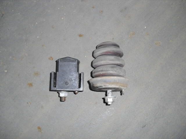

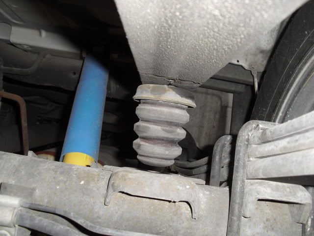

Well I may end up redoing this thread but here's an update. I removed the rear bumpstops and installed the 2WD ones I ordered. The ride was a little harsh on bumpy roads with the 4WD stops in. You can see the difference in the height of the two here.
This is how much clearance the 4WD stops had.
2WD stops installed.
