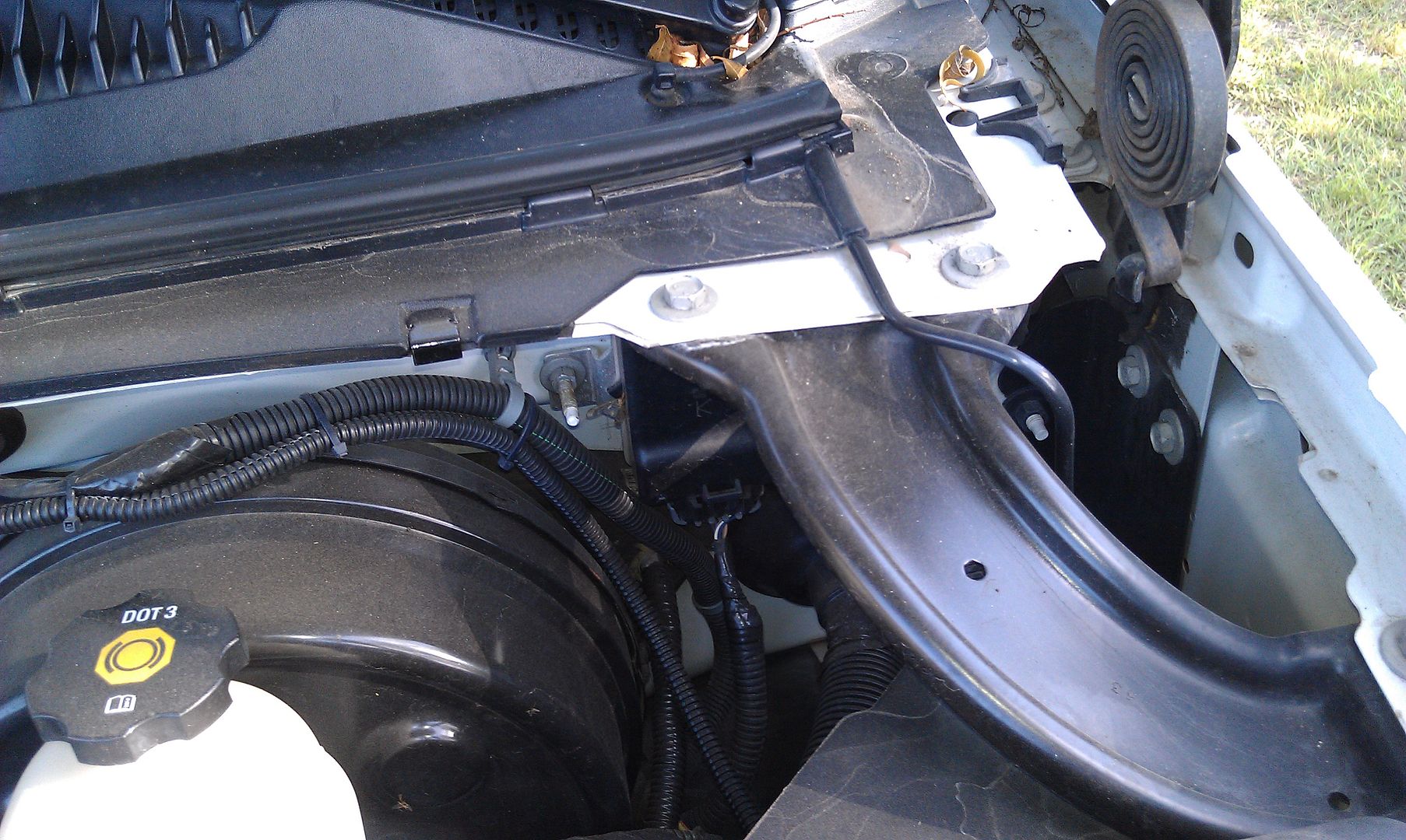

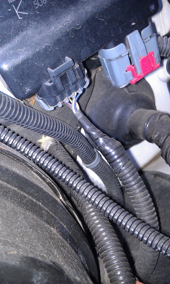

Alright, best I could get considering how tight everything is.

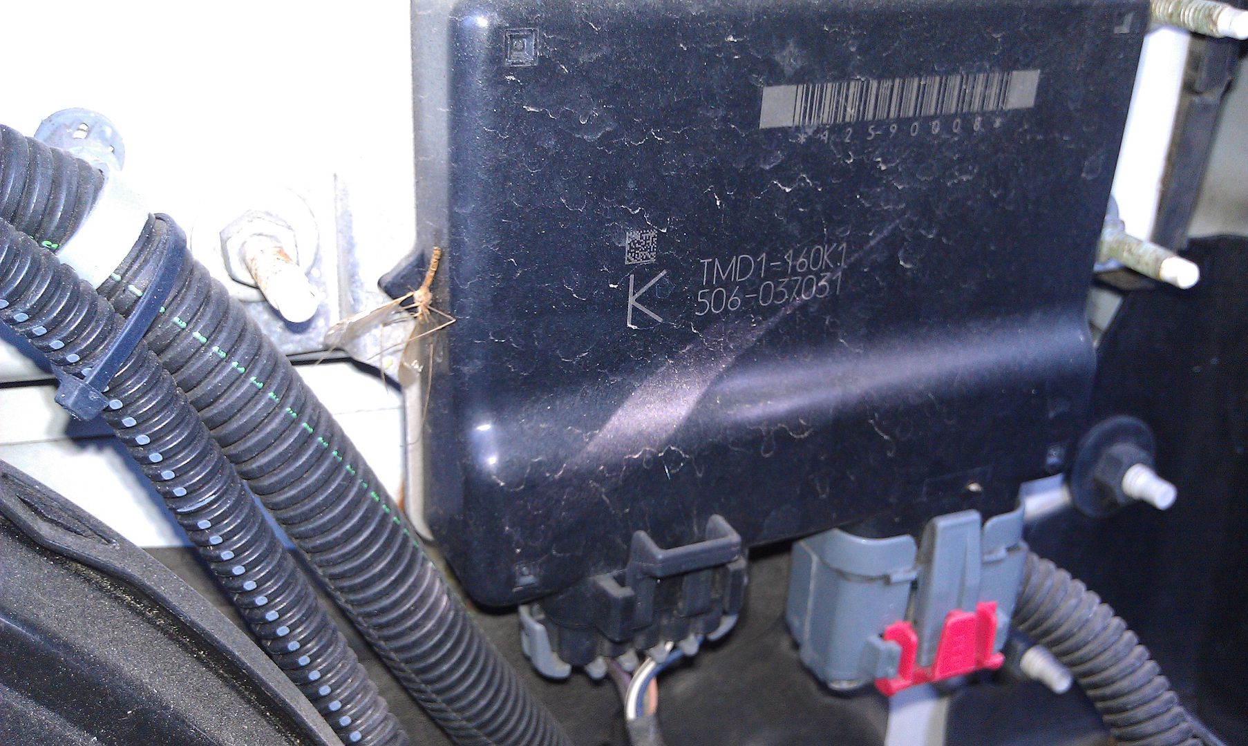

Throttle position module, just need to unbolt it and unplug it.

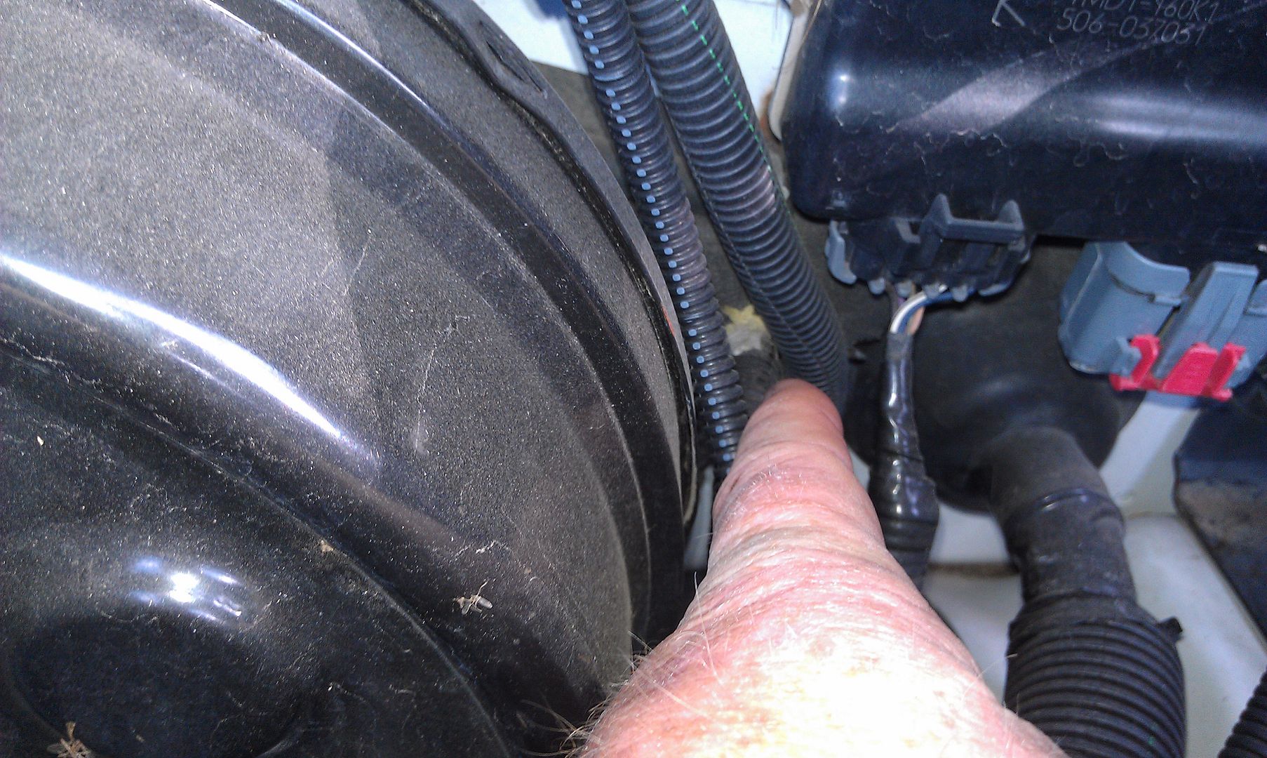

My wire is coming through in the wire loom, just to the left of the tip of my finger.
IIRC, I used a razor knife and trimmed back that plastic covering before I put the fitting in. That shaft you see in the pic is the brake booster shaft, look to the left of it and see the gland and wire loom coming out. Pretty tight up in there.
Hope these help some.:tmc:

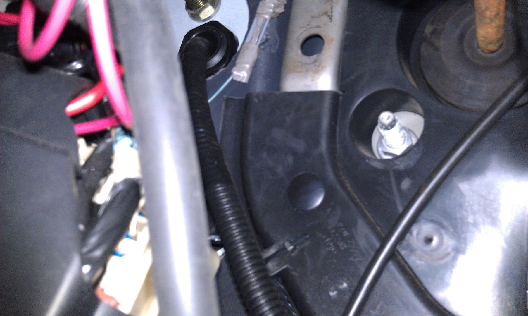

Where does the wires come in at on the other side of the firewall under the dash ?
Mine looks like there is a bunch of stuff in the way .

The last picture is the wires coming in under the dash, yeah there is a bunch of shit in the way. I have them routed all the way into the center console, if I pull out the cup holder it gives me access to the modules I am powering for the gauges.

ah ok i understand now, i was trying to figure out what that pic was, lol thanks .
