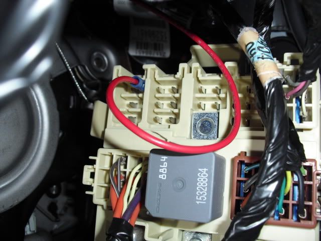

Just run wires to the fusebox on the left side of the dash. That is how I wired the CB in both my '99 and '07.
Yep or the fuse block under the dash, in the floorboard, left side.
