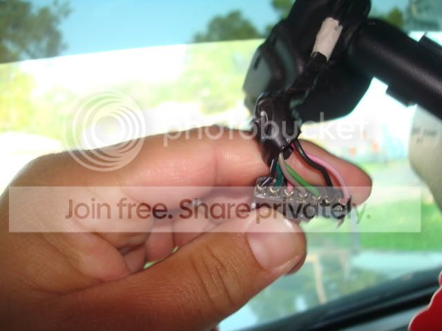

Anyone know where the reverse light lead is on my Tahoe? BCM? Any idea which wire?
My backup cam will be here on Monday and I'll need to tap into that wire to tell the head unit to display the image. The cam itself is powered by the reverse lights but I don't want to have to run a lead all the way to the front for the actual trigger on the HU.
I've looked at several diagrams they all say its a light green (+) wire. But 3 different locations. One says the tail light, one says at the switch on the transmission, and says "inside the rearview mirror".
I'll post back if I find out anything else.
I've heard it's the light green wire from the black plug (pin F) on the BCM but that was for an '05. I know there were some changes between '01 and '05 but I don't know about the BCM.

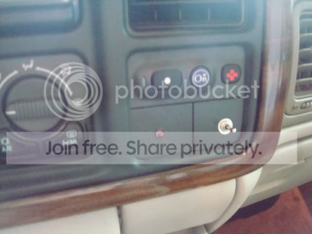

Hey, Scott, you don't happen to know a part number for the little dash cubby that replaces my OnStar switches and cover panels, do ya? It's pointless for me to have the OnStar buttons there. Maybe I'll swing by the Chevy dealer today!
No, don't know that number but I know what cubby you mean. My brother has one in the Tahoe as it didn't have Onstar. I don't use On star either, but I have my alarm LED mounted on one of those lower blanks and a toggle switch on the other blank. I had that toggle switch hooked to my stock radio Aux input adapter to switch the audio btween the DVD player and my MP3 player. Even though the stock radio has been replaced, that switch is still there.
UPDATE: Ok I just found it for you. You owe me another beer you sumbitch.:cheers:
Unplug the harness from the rear view mirror, its the light green wire in that plug, the third wire from the right. I just metered that wire and it switches to 13volts when I put the gear in reverse.
I'm sure you can trace this harness to one of the windshield pillars and grab the wire there.

Yeah that must be on the 03 on up BCM's. I looked and my BCM doesn't even have a black plug, it has a purple, blue and brown. Although I did see a few light green wires, maybe one of them is a reverse wire? :dunno:
