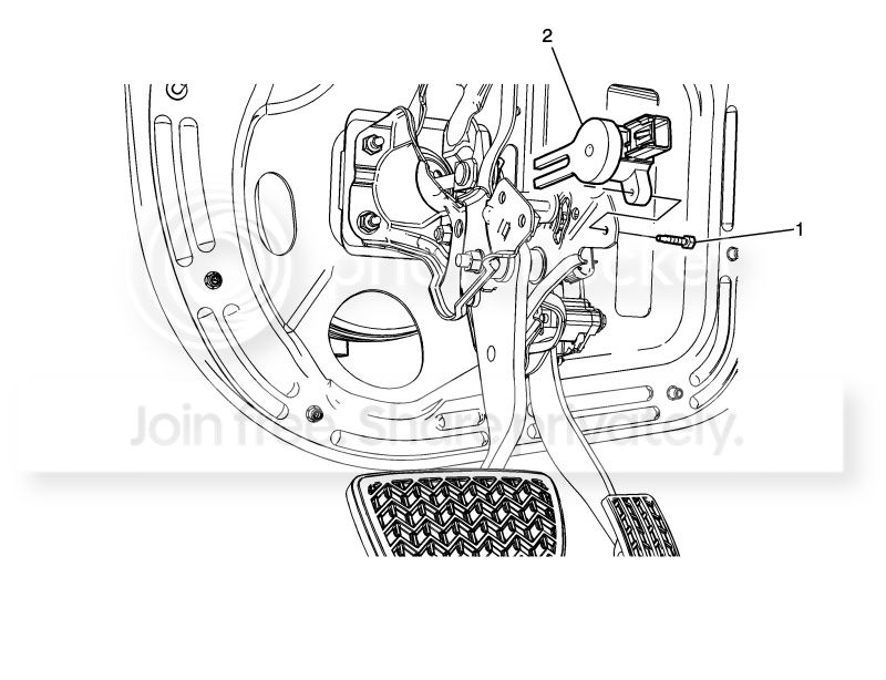

Here is the procedure to replace the brake pedal sensor.
xTooltipElement
Service Information
[Related Documents \/]
2011 GMC Truck Acadia - 2WD | Acadia, Enclave, Traverse VIN R/V Service Manual | Document ID: 2151824
________________________________________
Brake Pedal Position Sensor Replacement
Callout Component Name
Preliminary Procedure
Remove the left instrument panel insulator panel. Refer to Instrument Panel Insulator Panel Replacement - Left Side.
1 Brake Pedal Position Sensor Bolt
Caution: Refer to Fastener Caution.
Tighten
3 Y (27 lb in)
2 Brake Pedal Position Sensor
Procedure
1. Disconnect the brake pedal position sensor electrical connector.
2. After the installation is complete, calibrate the brake pedal position sensor. Refer to Brake Pedal Position Sensor Calibration.

OK, so it IS a rheostat / potentiometer...
You are right, it will have to be calibrated by using the TECH 2...
Hope you are still under warranty... :dunno:

Well and update to this is that it was the brake pedal switch/potentiometer or what ever it is. Total cost was $118 to have the dealer replace it and then calibrate it.
While I was there the did a recall on the air bag harness update. Keeping fingers crossed that nothing else goes wrong and this thing will hold out for at least 5 more years.
