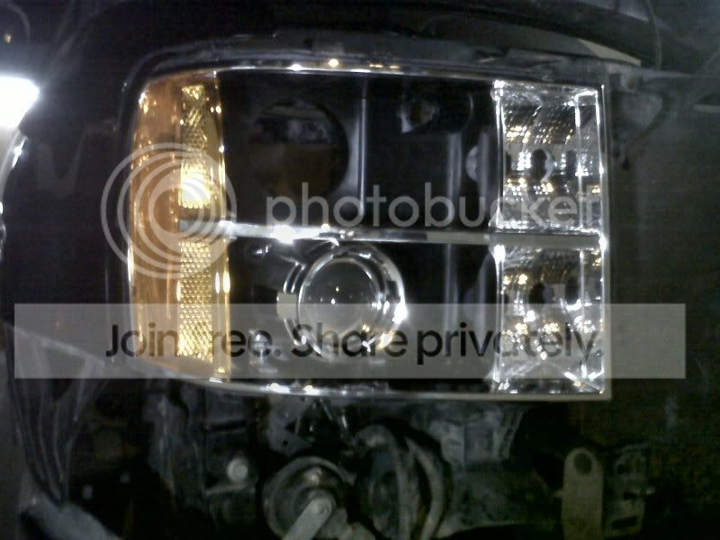

i thought about the mounting method , what to chose from , the cheap and easy epoxy/silcone rote or the better JnC method..
i wint with the JnC , the adjusting option is always appricated.
no more jokes about my toe...:lol:

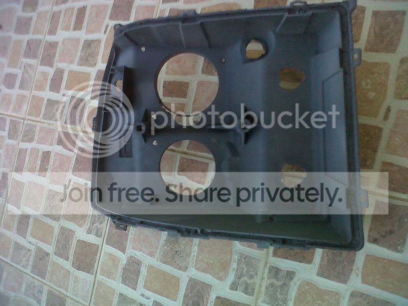

i cleand the housing from the old robber PITA, for any one that will use this as a "how to" heat the rubber with a heat gun and use a small flat blade screw driver,and a wide paint removeing blade

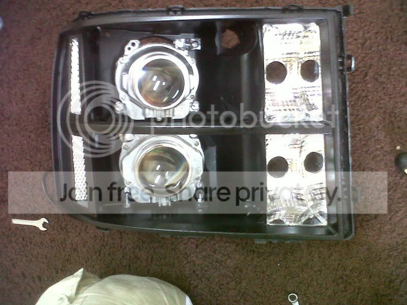

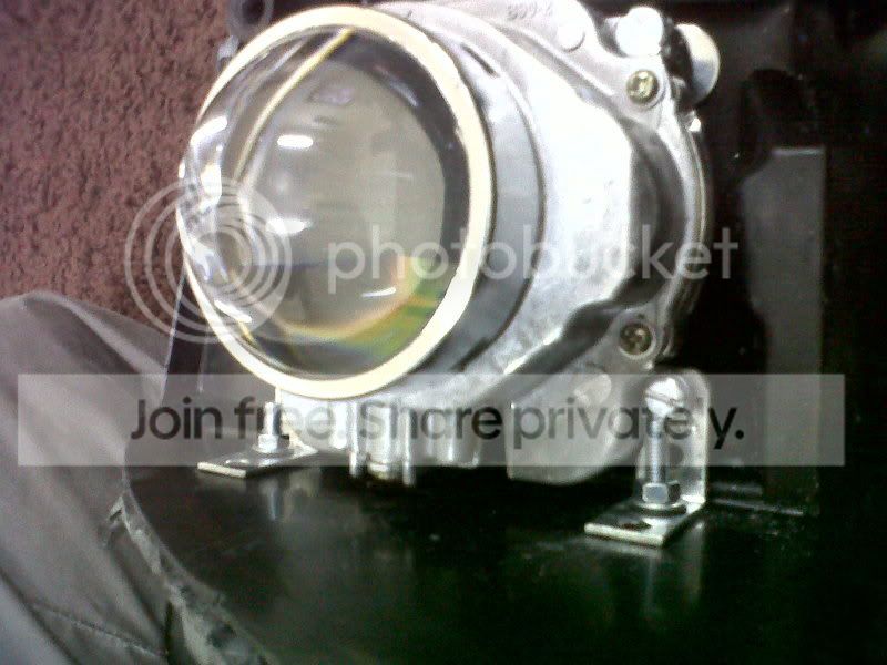

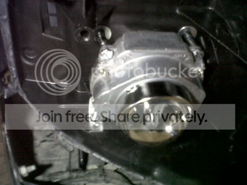

set the projector temporarly to adjust and mark the drilling holes

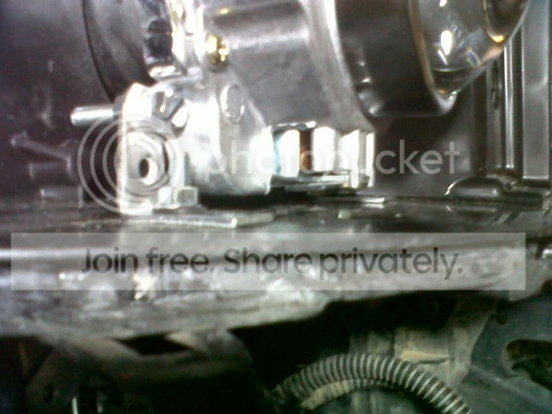

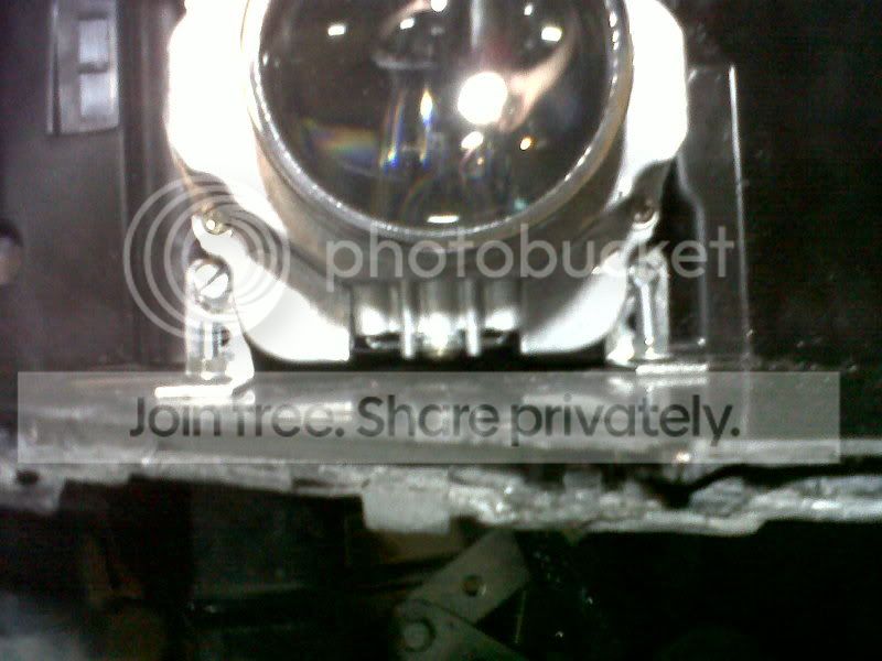

drilled the holes and monted the two " L" braket on the bottom of the projector using 8 mm to adjust the beam hight
this is how i used the bolt
nut
washer
rubber grommet
L bracket
=housing=
rubber grommet
washer
bolt head

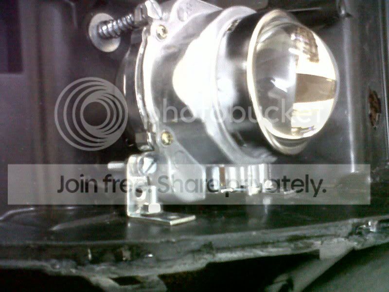

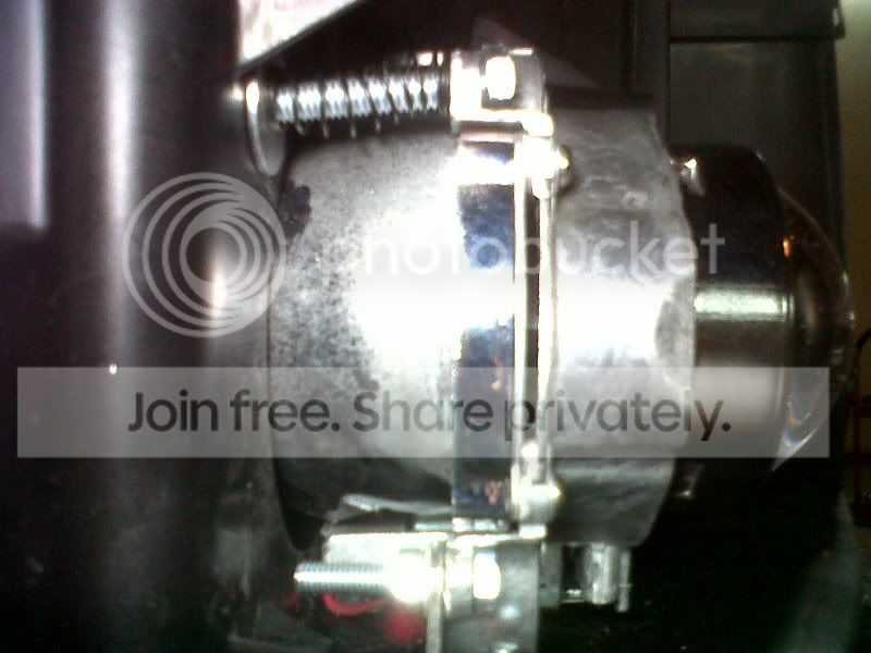

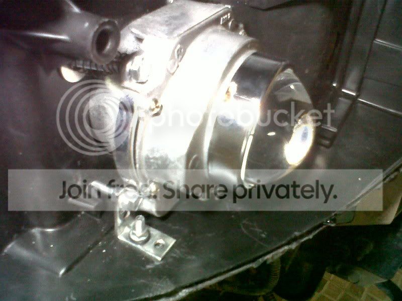

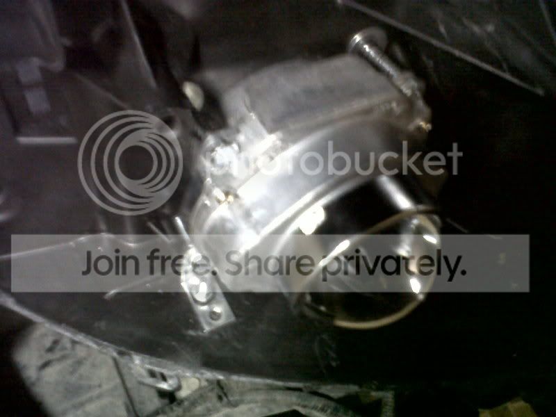

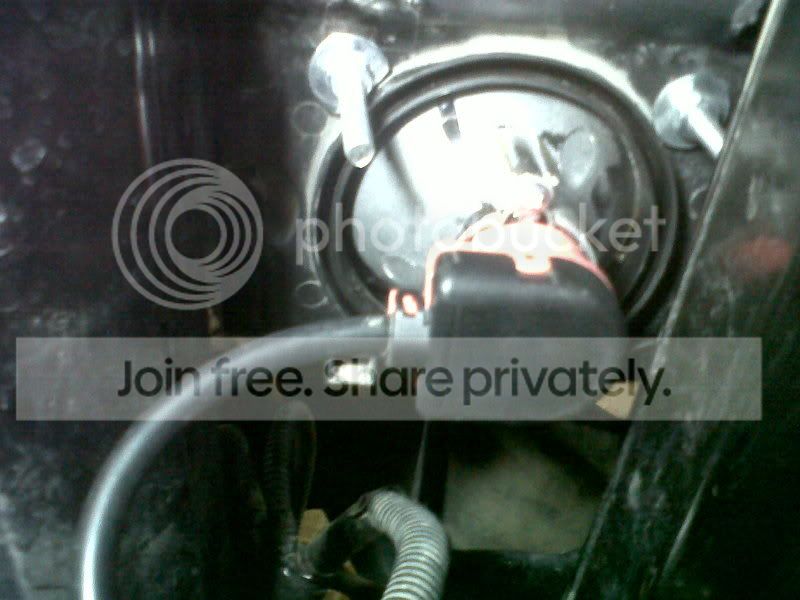

here i did the upper mounts/ adjusters i used 10mm bolts with 80mm length
here is the upper adjusters/mounts setup
10mm bolt x 80 mm length
projector
coil spring
10mm washer
housing
10mm washer
10mm nut
10mm nut
i might add another nut cause the first 2 can be moved easy

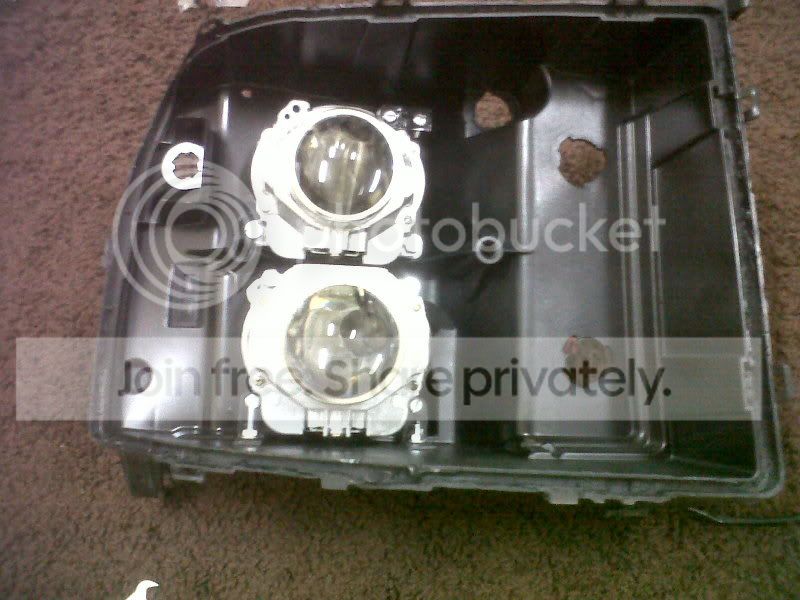

here is a back view of the projector and adjusting bolts
side

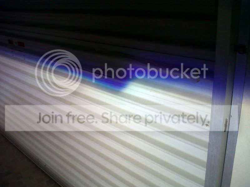

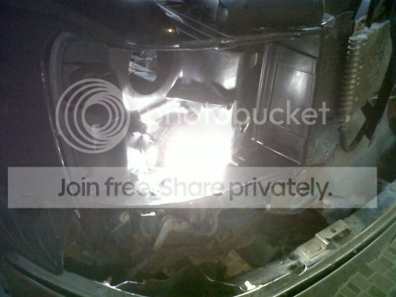

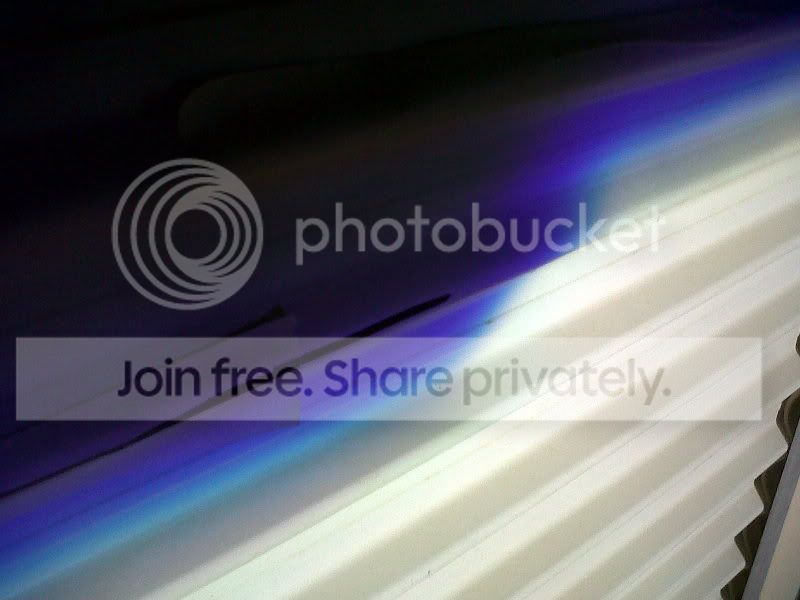

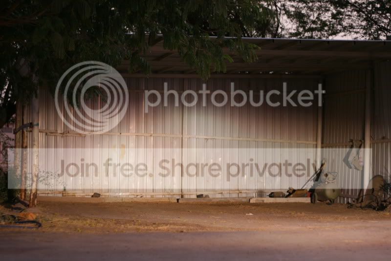

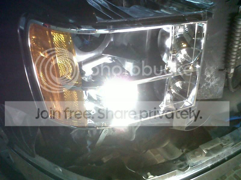

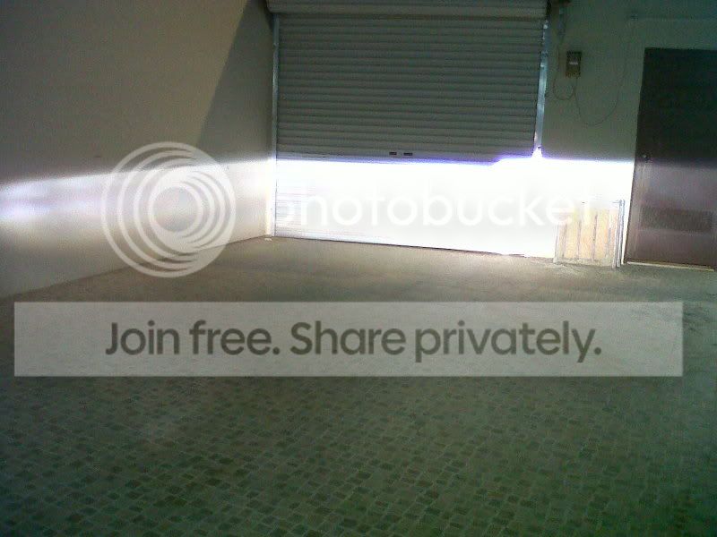

low beam after adjusting...this is ONE projector
high beam after adjusting

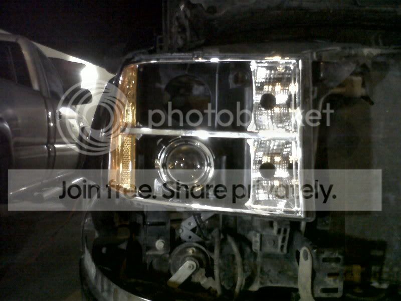

testfitting to make sure it fits with no probs with the otter reflector
more pics
thats all i did for now... im taking my time because im waiting for a replacement for the broken projector...i orderd 2 acctualy

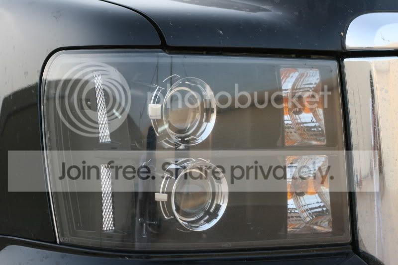

the last two days were dusty...and hot so i couldent work..here is what has been done..

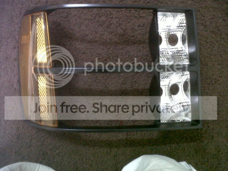

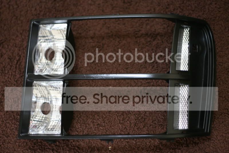

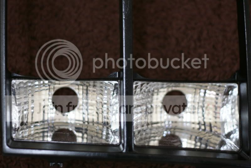

because the housing will show and i wont cover it with acrilic or chrome
i paintd it with a primer and then gave it a mate black color

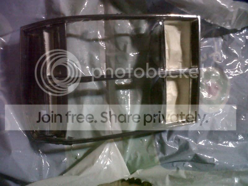

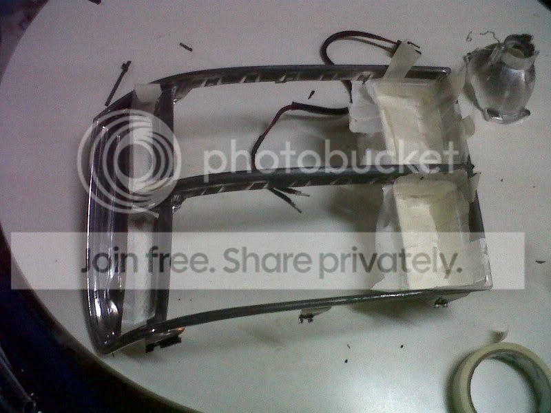

as for the outer reflector.. i cleared it and removed the chrom with sand paper and coverd the parts that i want to leave chrome
result

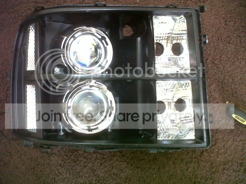

just to see what it looks like...ugly

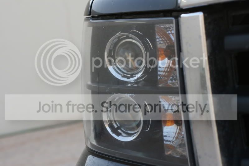

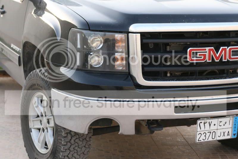

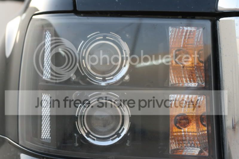

mounted
shrouds on

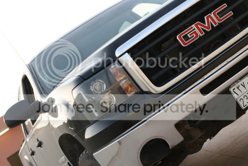

here it is...im not finished yet still needs adjusting the beam..im happy with the outcome

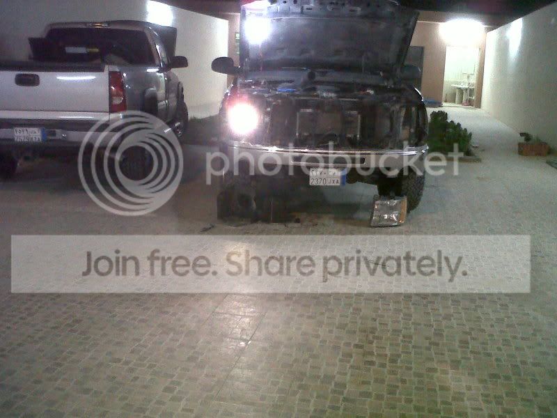

as you can see from the pics if finishd only one side ill do the other tonight by gods willing...

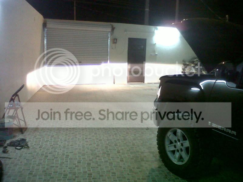

also ypu can see if u foucs on the projectors that they arent aimed the same way
here
the lower ones will be operated through a switch just for boosting light on dark roads and such i think a pair will do enough

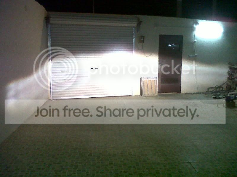

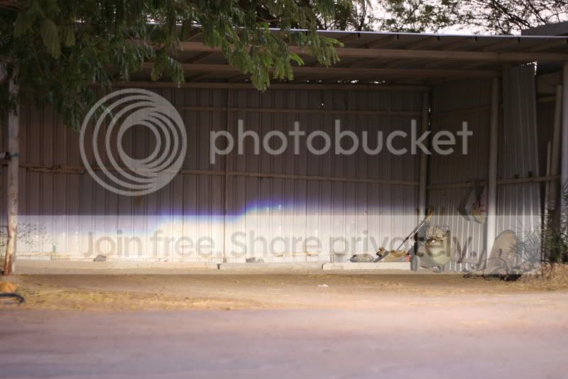

here is the beam pattren of one side with bothe upper and lower turend on at 50ft this is without adjustment( they are aimed way down than they should
hope you like it..
