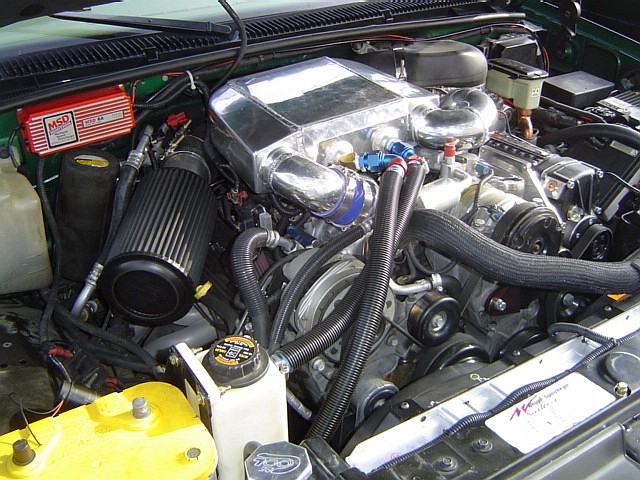

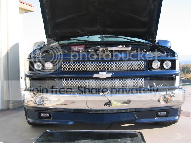

Here's a few inter-cooler setups. I personally really like the second one the most; the third one requires a lot more modification to get the huge cooler to fit.

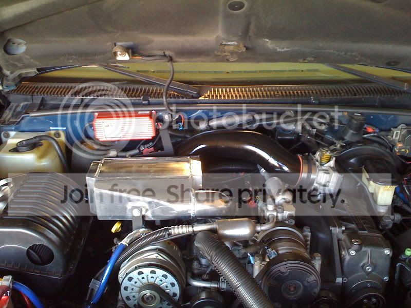

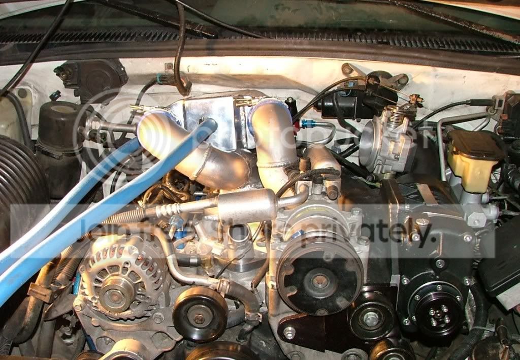

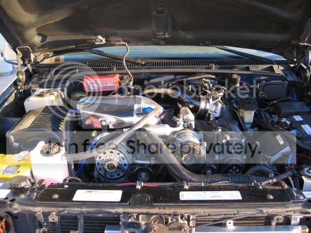

here's some pics of mine from when I was running the whipple and intercooler, these are the only pics I have, I know they kinda suck and are in-progress shots, I don't have any completed pics of it...
this is when I was doing the install, you can see the whipple output has been modified to point back towards the cab, then there is a kindof spiral piping going from the intercooler to the intake manifold, the blue hoses are the coolant hoses for the intercooler:

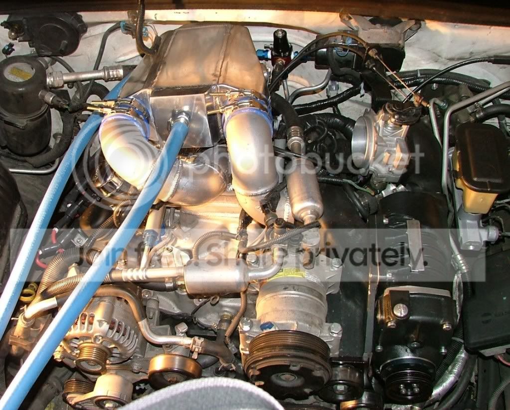

same thing, different angle:

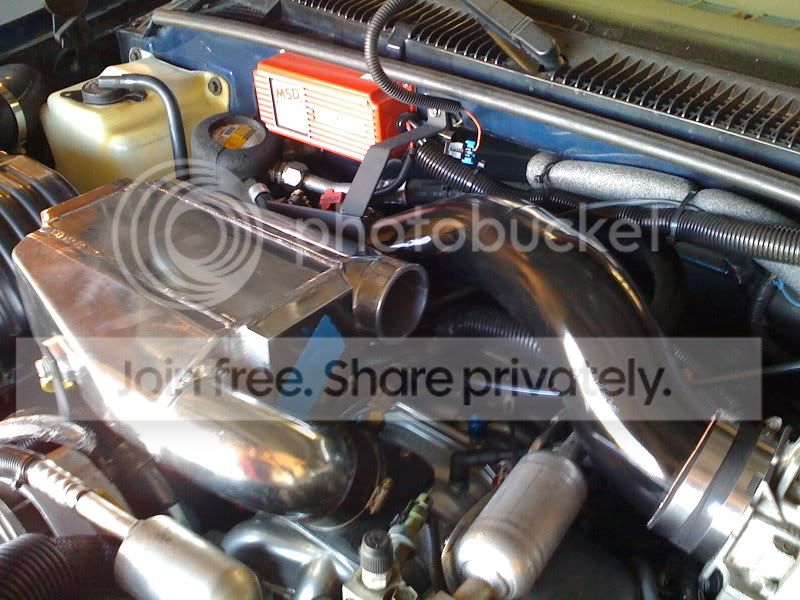

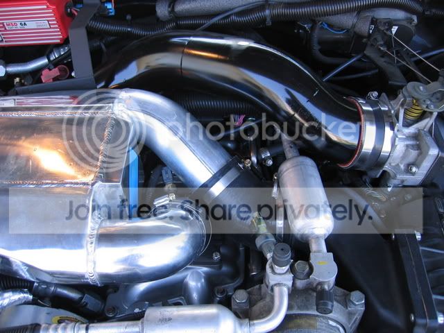

this one is closer to being finished, you can see the black ABS pipe running over the intercooler, thats the air filter to TB pipe, I used 3" ABS, but it was a little too big to fit over the intercooler and still let the hood close, so I had to heat it up and deform it into a slight oval. you can see I put some black covering over the coolant hoses, just as a kindof protection layer
thats about all the pics I have of my setup, nothing of the radiator or pump or anything. I hope they don't mind, but I'll put up some pics for 99bluetahoe's intercooler setup that he ran using the same intercooler as me, but installed differently, and James B's massive intercooler setup he used to run.

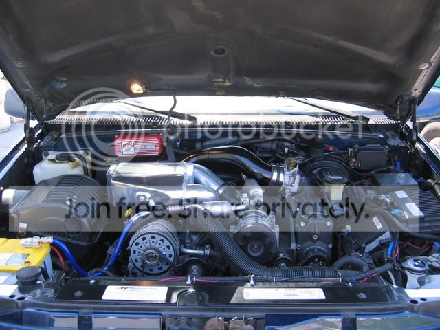

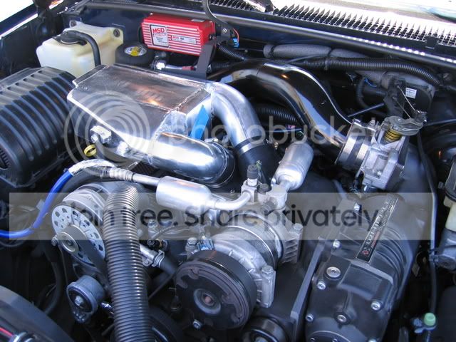

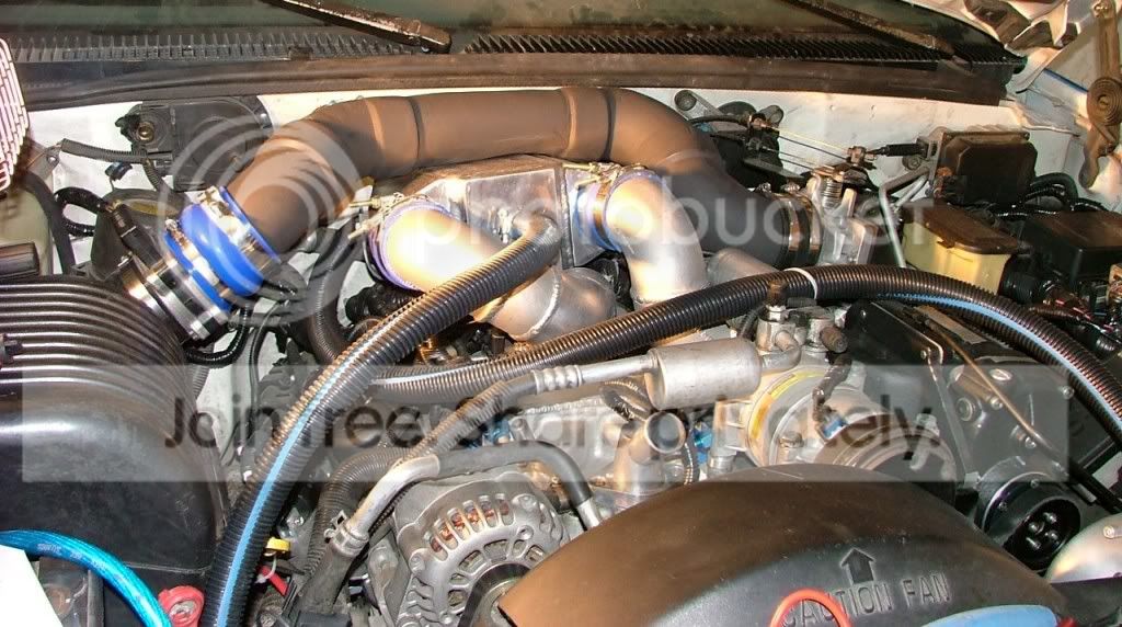

here are some of 99bluetahe's setup he used to have:

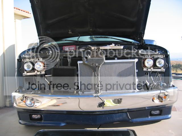

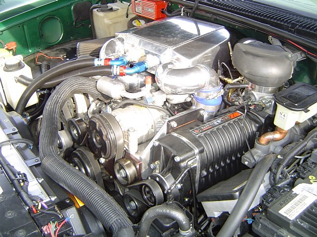

and here are some pics of James' huge intercooler setup he used to have:
his is ALOT different though, he fitted a larger whipple compressor and different whipple input elbow on and altered his master cylinder and did a bunch of other stuff to get that huge cooler in there.
