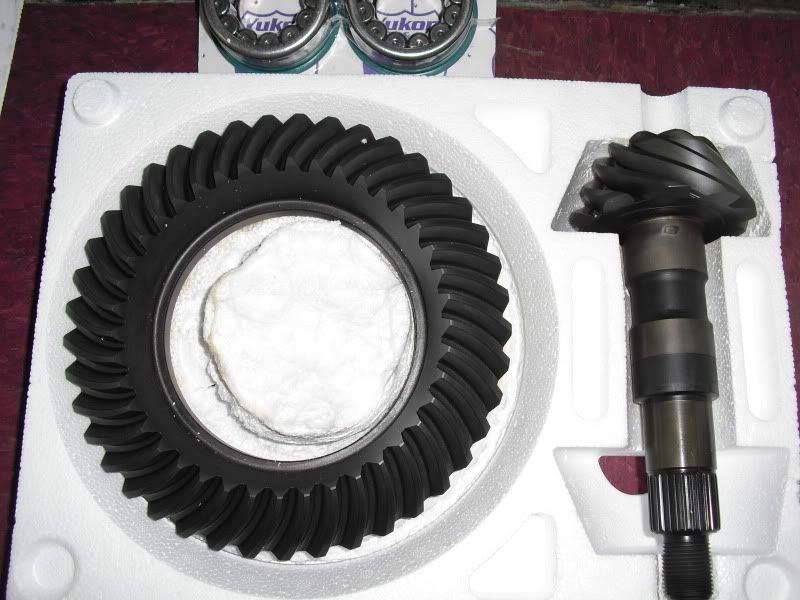

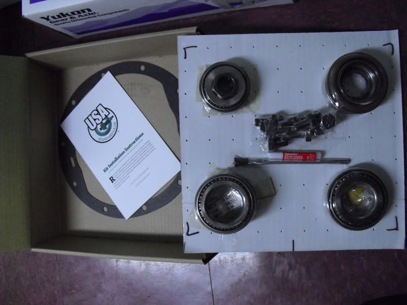

Print out the attached Yukon Gear Installation Instructions and read them several times so you are familiar with what you are about to tackle.

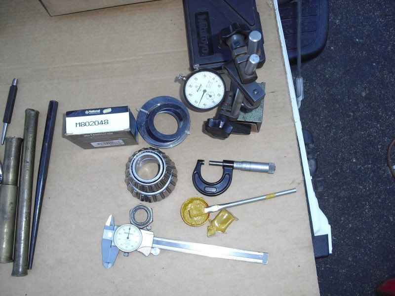

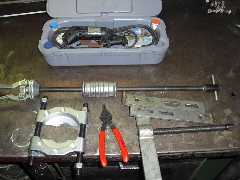

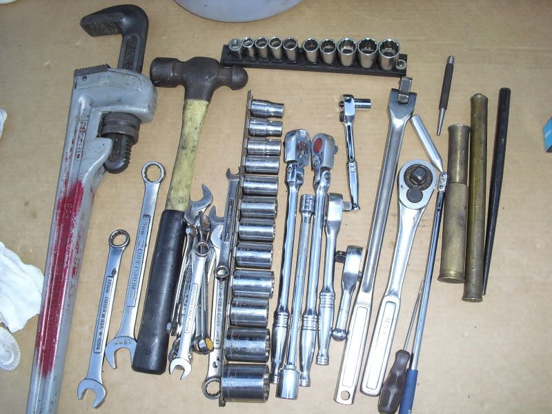

Tools needed:

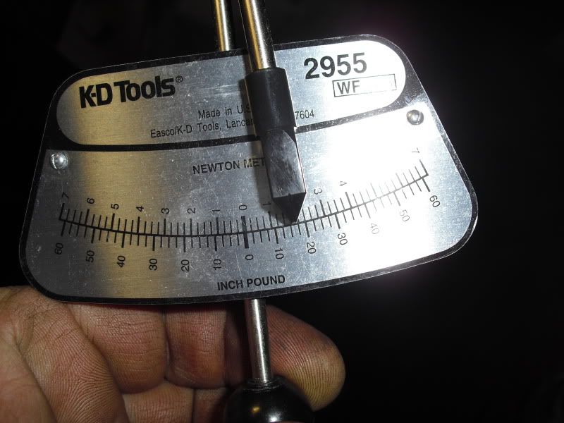

Basic hand tools, brass punches, hammers, slide hammer puller, bearing pullers, torque wrench, inch pound torque wrench and a shop press. An appropriate jack and jack stands or a lift if you have one. You will also need a set of good slide caliper or a 1 inch micrometer, a dial indicator with magnetic base, your setup bearings and gear paste. ( the paste is included in the master install kits).

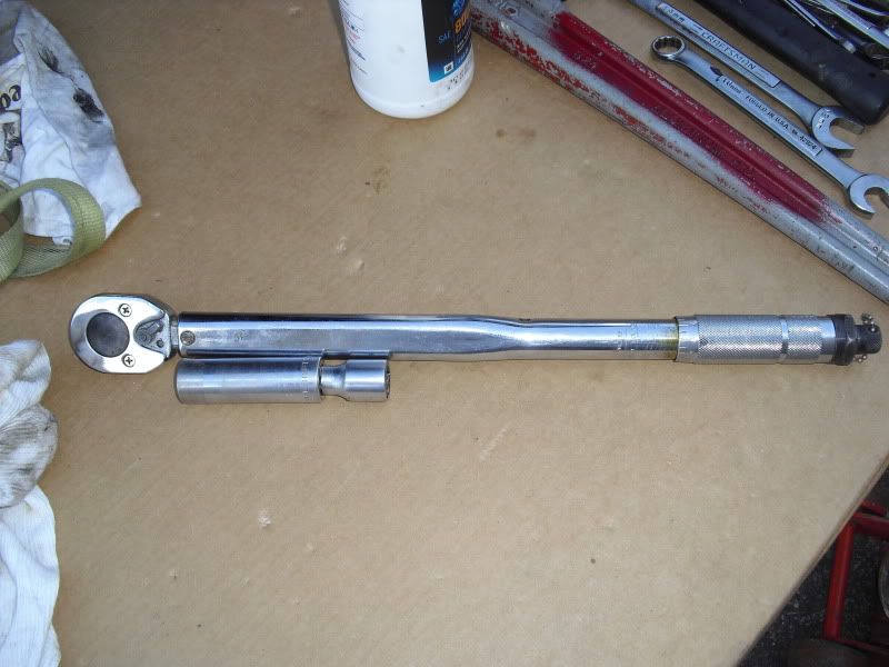

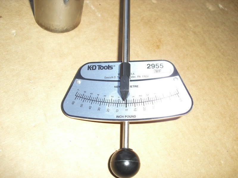

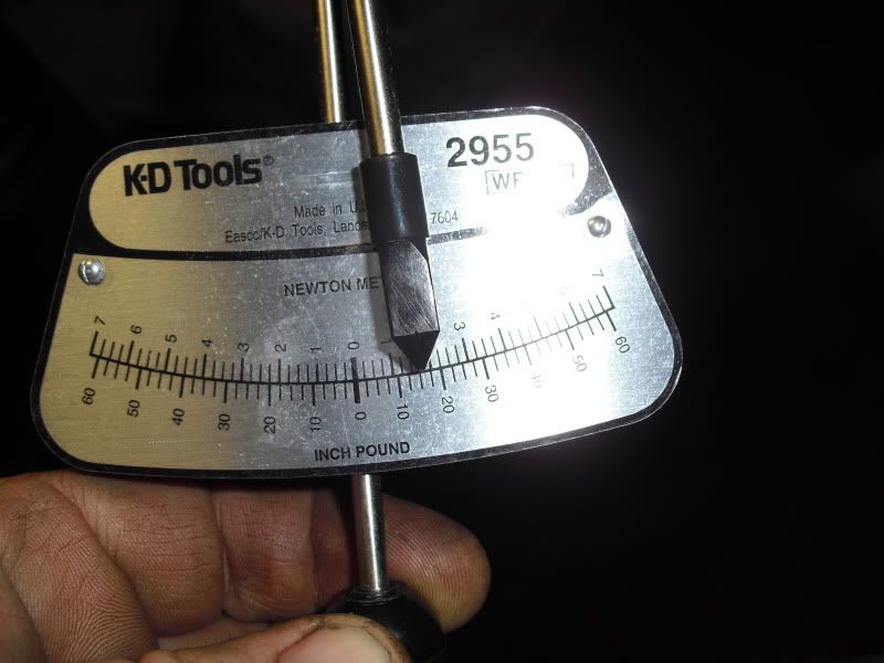

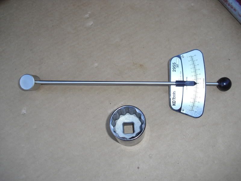

The inch pound torque wrench can be puchased from Randy's Ring and Pinion here: http://www.ringpinion.com/Search_Results.aspx?Requery=True&SearchType=ALL&SearchPhrase=tlsm10
The pinion nut is a 32mm or 1 1/4" so you need a socket and adapters for that. The small torque wrench is 1/4" drive.
