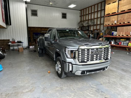

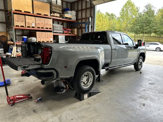

That's a beast! Those ramps look like the ones I have.
It is. I was installing an airbag/compressor setup. I’ve always used AirLift but he decided to go with Firestone.
Don’t ever go with Firestone.
There stuff is well made and it’ll live a long life but it was a giant PITA to install. The Wireless One from AirLift has u-bolts that mount the compressor and solenoid (all one unit) right on the side of the frame rail.
The Firestones were separate units and I had to build a base and mount out of aluminum bar stock, mount the Devi es to that, then mount the entire thing on the bed’s cross braces using the heat shield bolts. Way too much work for no good reason.
Just an FYI for anyone thinking about it.
