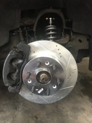

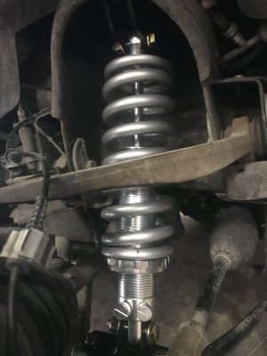

Gave the wife's burb some attention over the weekend.....
Rotated tires
Brakes front and back
New hubs on both sides
Installed coilovers on the front. This thing rides like a dream especially for a lowered suburban! I should have done this upgrade a long time ago.
