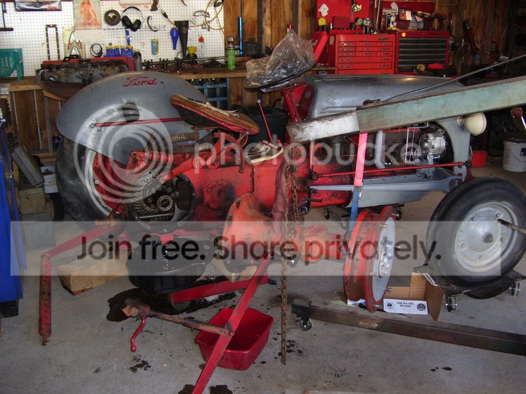

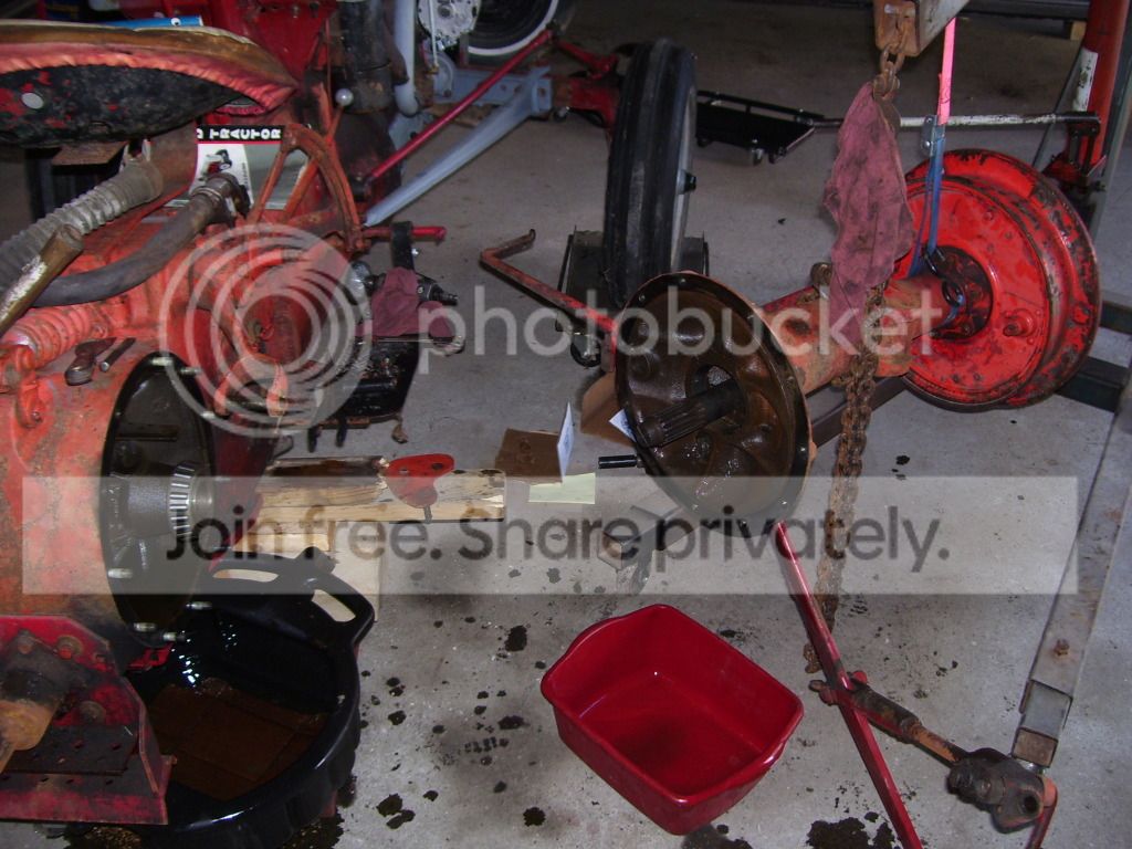

Here are some updates. I got the tractor back together and filled the trans/rear axle. Had another leak so I pulled the axle housing off. Had to replace the differential bearings.

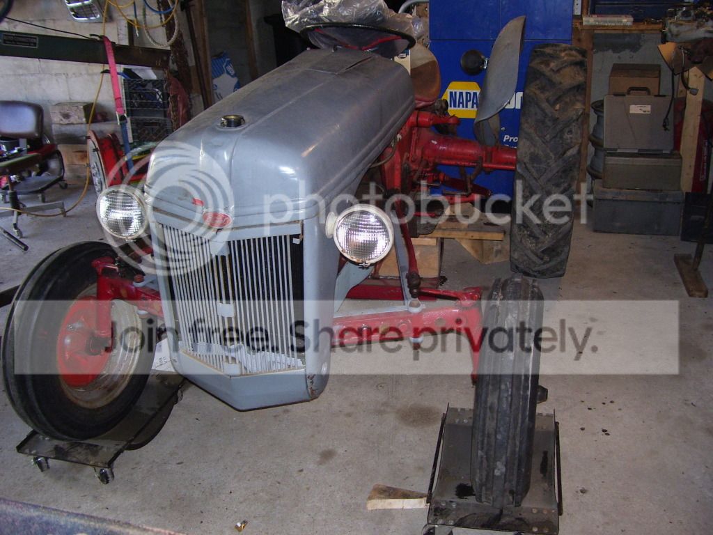

Found some original Ford headlights. Bought them for $20. I think they look good.

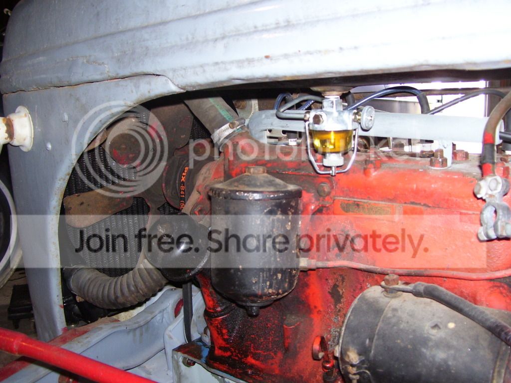

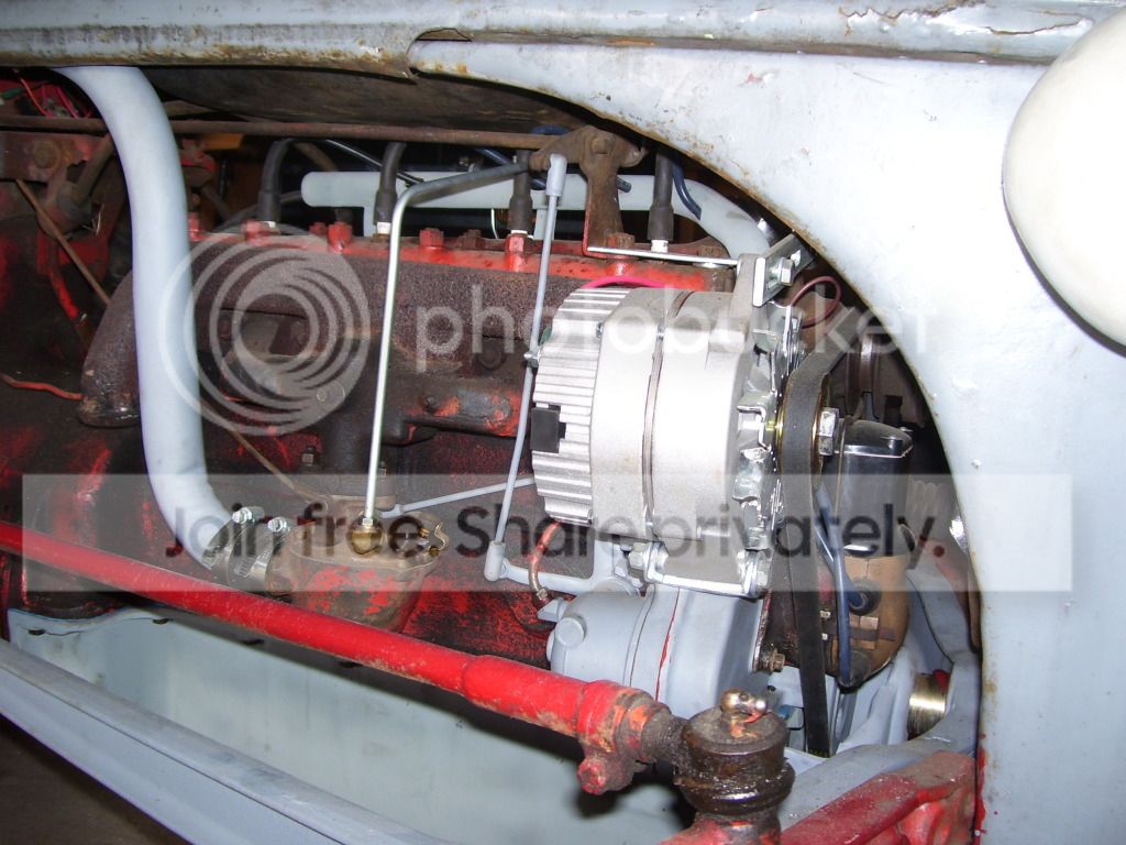

I did a 12 volt conversion kit with alternator and all new wiring. Also made a new fuel line and installed the correct fuel sediment bowl. I had to remake the steel tube on top of the engine that the wiring runs through. Because of the alternator mounts I had to move it to the left a little.

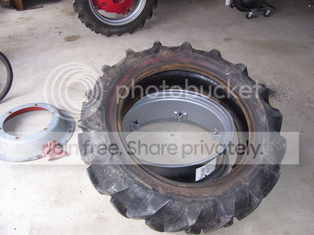

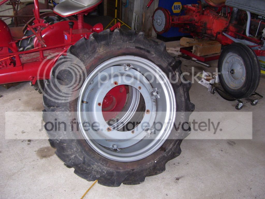

I had to buy one new rim. I mounted the tire up on the new rims and installed a new tube. I am just waiting for the new lug studs to come in so I can mount the tire and put it on the ground.

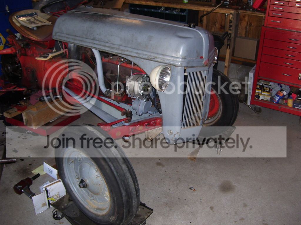

I have been very busy. When its back on the ground I am going to bring it to the shop and pressure wash the hell out of it.
