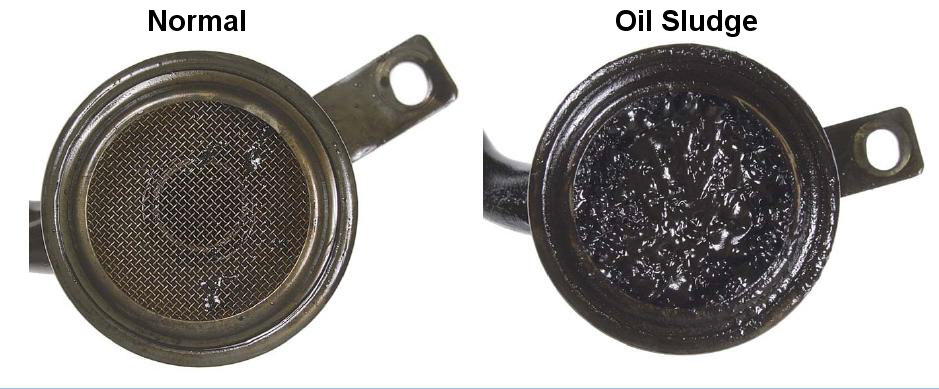

But how can this kind of crud get inside the pump, you ask? The screen that is on the oil pump pickup tube in the crankcase only prevents relatively big pieces of debris from being drawn into the pump, and even then it does not always do that because most pickup screens have some type of bypass valve or vent that allows oil to bypass the screen if the screen becomes plugged or the oil is too thick to pass through the screen. The holes in the screen itself measure about 0.040 inches square, which are huge openings as far as debris is concerned. But the holes are large by design so the screen will flow an adequate amount of oil when the engine is cold and the oil in the crankcase is thick (which is why you should always follow the vehicle manufacturer recommendations on oil viscosity). All this means the oil pump is the only engine component that is continually lubed with unfiltered oil! The oil does not pass through the filter until after it leaves the pump. So any abrasive debris that finds its way into the crankcase will first pass through the pump before it is trapped by the filter. No wonder oil pumps wear out and break.
Restrictions in the pickup tube screen can choke off the flow of oil into the pump, reducing flow and pressure. Even a relatively small amount of varnish buildup on the screen can restrict oil flow at higher engine speeds. A coating only .005 inch thick on the screen will reduce the total "open" area of each hole to .030 inches, causing a whopping 44 percent reduction in oil flow!

The next step would be to drop the oil pan and check the oil pump pickup screen. If the screen is clogged with debris, you have found the problem. Also, check to see that the pickup tube is properly mounted and positioned, firmly attached to the oil pump (no leaks) and is not obstructed.

Toss the old pickup tube and screen and replace with a new one. Yes, you can attempt to clean and reuse the old screen but it is risky. The bottom cover often hides a lot of debris, and solvent can loosen "hidden" debris inside the tube that will later be sucked into the pump.

OIL PUMP PICKUP PROBLEMS
The pickup tube has a screen on the end to prevent large chunks of anything bad that ends up in the crankcase from being sucked into the pump. But we are talking BIG chunks of debris, not normal wear particles or carbon or dust or other microscopic-sized abrasive particles that can cause pump wear over time.
The only way to inspect the pickup tube is to remove the oil pan from the engine. If the tube is clogged or full of sludge, replace it. Trying to clean out the tube and screen is very difficult as debris can remain trapped inside and out of sight.
