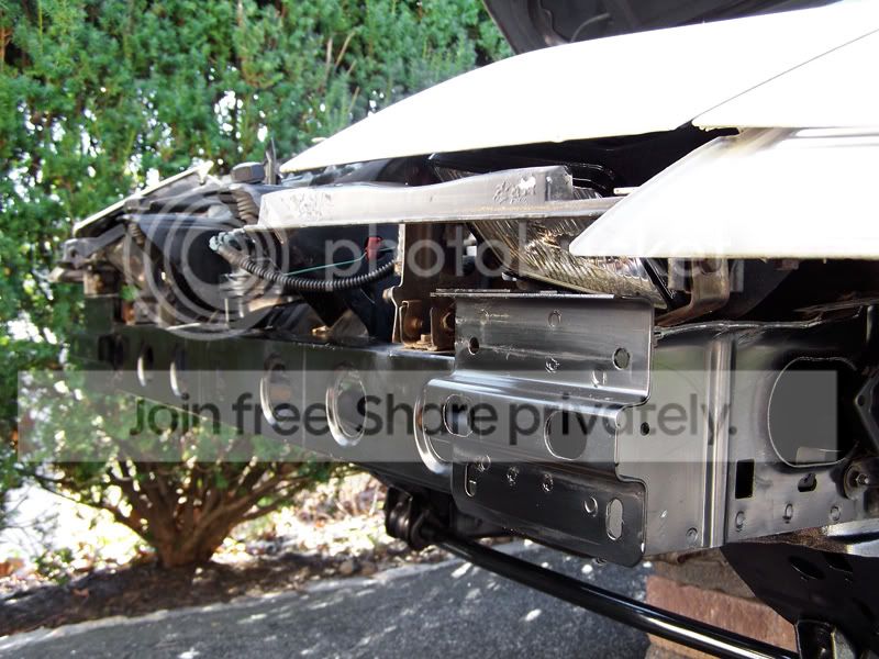

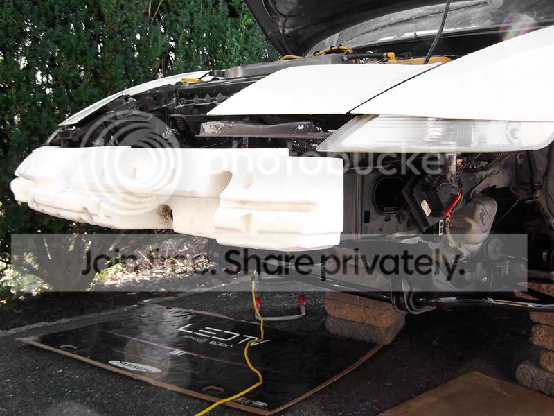

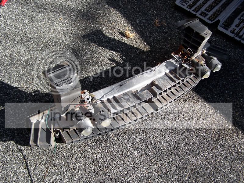

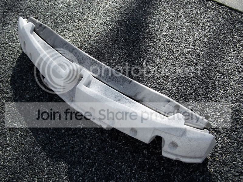

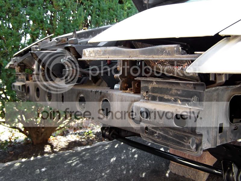

Little more progress from last week, nothing exciting though. Swapped out the inner bumper for a 95-96 nose. From time to time I see few people ask what's needed for a 91-94 nose swap to a 95-96 nose.
Many years of dirt build up
Old plastic off
Cleaned up
New smaller foam cleaned up (I have an extra of the foam piece if anyone needs one)
Installed

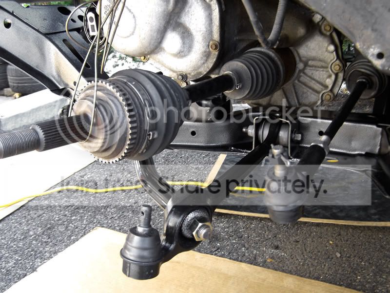

Sanded off the rust and painted the outer tie rod/shaft, Moog tie rod which was bare metal and was already showing spots of rust, and the CV shaft. Small details make a difference.
Tomorrow, the plan is to wire my stereo, install the new carpeting and put back some or most of my interior.
Over Christmas break, the entire suspension and brakes should be close to completion.

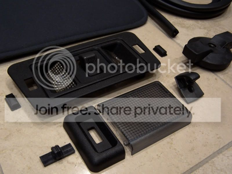

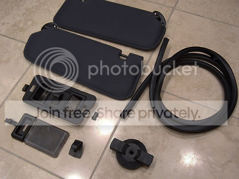

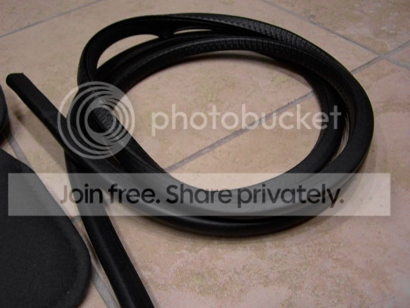

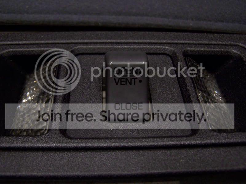

Tonight it was time for plastic black soup. In a pot of boiling water I added dye and broiught it to a roling boil, turned down the heat and dropped in some light grey plastic that would look out of place.
Put the smaller pieces in some panty hose, tied a knot, dropped them in the pot, waited a about 10 min then went fishing with a coat hanger. Some of the plastics took the dye faster than others, the sunroof switch had to stay in longer, as did the spare tire nut which was white. I even was able to dye the light grey rubber sunroof trim. The color is black, not a perfect match to the charcoal material I used, but it'll certainly looks better than the light grey, and it won't scratch off like paint would. I included the visors for color comparison.

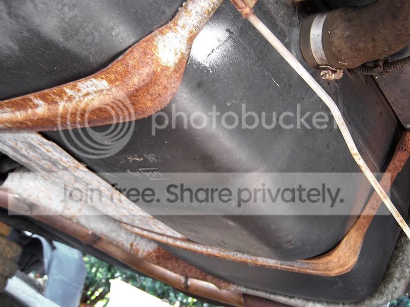

Also got around to sanding, brushing on rust reformer, taping off, and painting the gas support satin black(short of dropping it, this was the next best fix)
