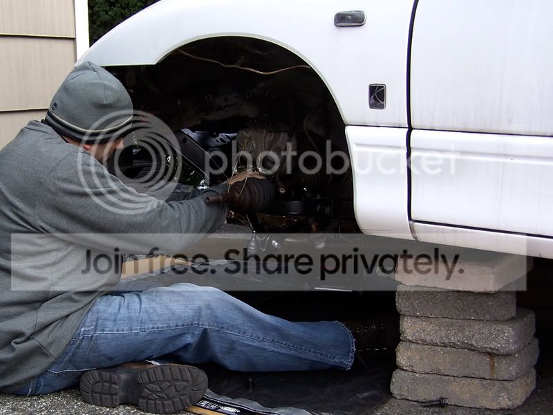

Made some serious progress on Saturday and Sunday(today), would've had all four struts on and maybe the pcoated knuckles and rotors if it weren't for a problem retainer. Thanks to Dan and his buddy for lending a hand.
Pics kinda suck, was more concerned about the work needed to be done on the car.

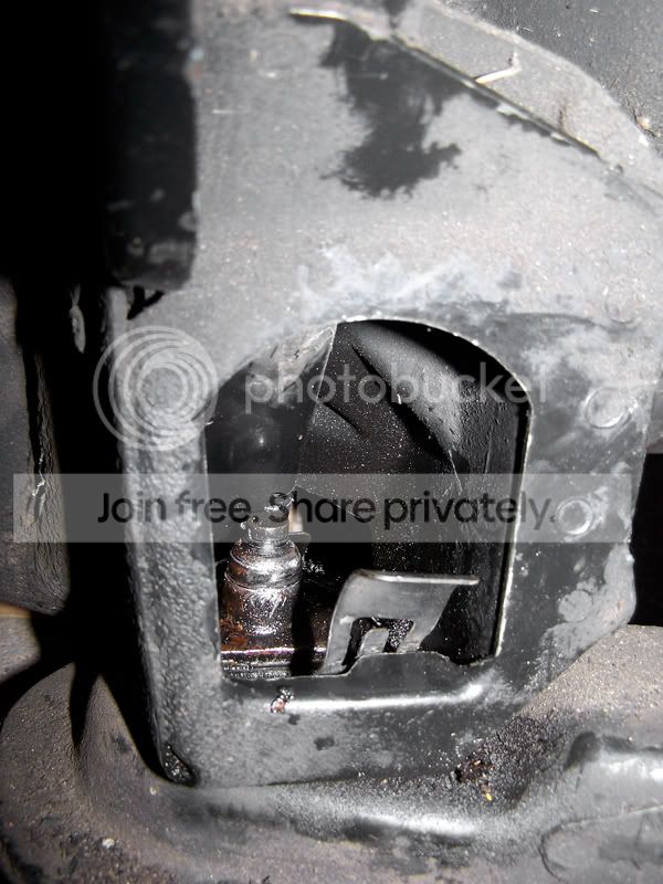

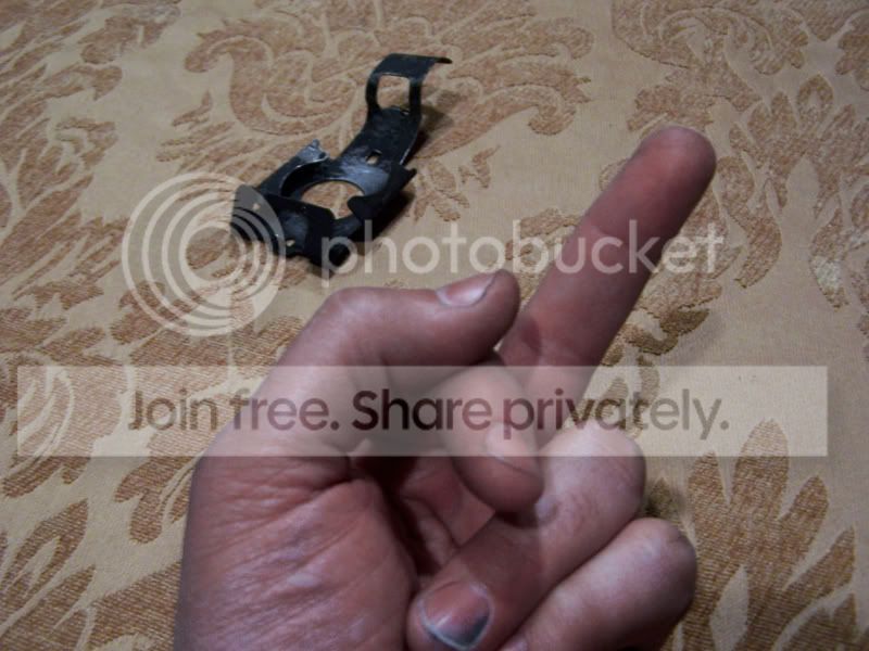

My friends and I spent over 4 hours trying to keep this lousy POS retainer on the passenger side from spinning while trying to loosen the passenger side cradle bolt. We tried vice grips, demolition bar, screw drivers, adding small pieces of 1/8" steel to try and keep the square piece from spinning...etc even PB blasted the hell out of it. We finally got it out by clamping down on it with a C vice clamp.
Wasting hours on one damned retainer clip pissed me off. I have an anger issue and while cutting through steel plate to make a small piece to throw in there to try and jam it up, at the end instead of slowing down I kept sawing at a high angry rate of speed and slammed my finger into the vice, it hurt like a bitch and I thought I broke my finger. You can see the blood in the nail, the swelling has since gone down lol. There's the culprit, a mangled retainer.

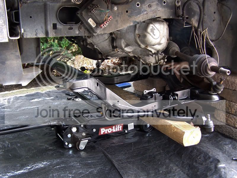

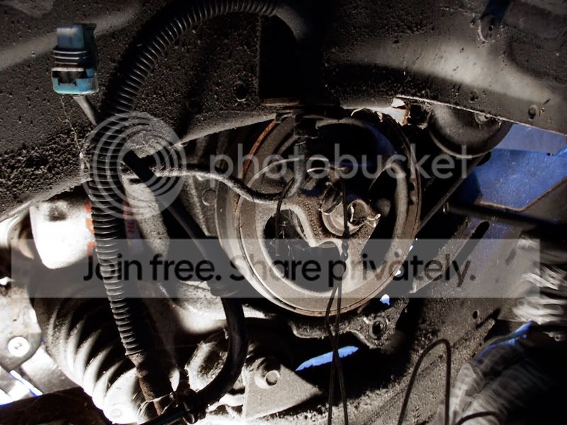

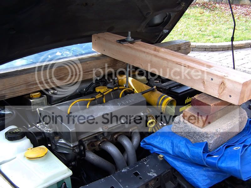

Jig I made to hold engine while we dropped the cradle...worked perfectly.

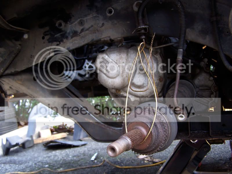

Passenger side dogbone area looks NASTY.

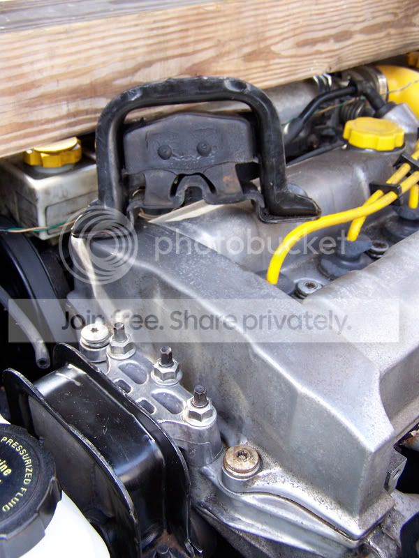

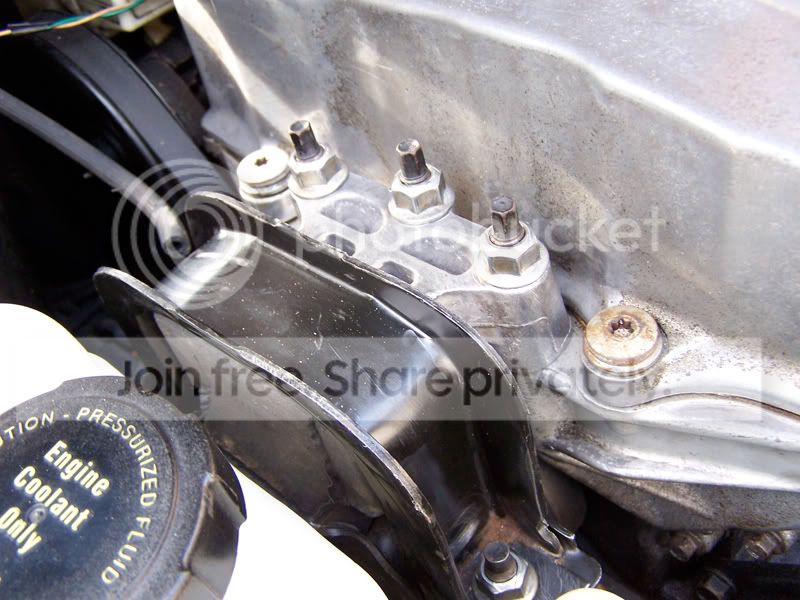

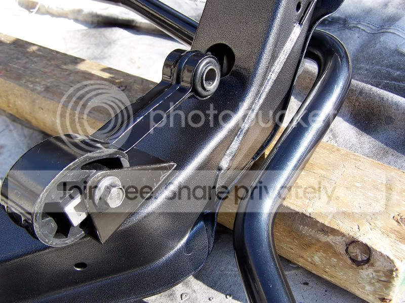

Replaced the upper engine mount (TAM), notice the old crappy 'sad face' TAM I removed. Apparently this 'sad face' TAM is known to be of a poor design and fails quickly, I could fit my finger inbetween the rubber and metal bracket, it's supposed to be tight, no gap.

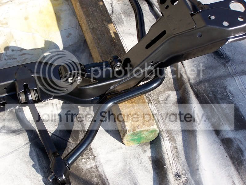

Ugly, rusted cradle.

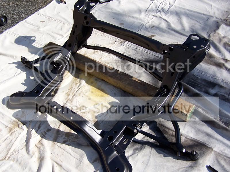

New cradle with everything bolted up to it.

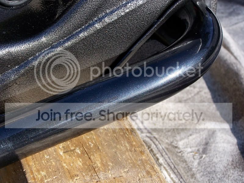

I love the Harley Black Pearl powder on the sway bar, in the sunlight it has green and blue metallic specs in it. Too bad under the car it'll just look like dark grey/black. The antique silver vein looks good outside too.

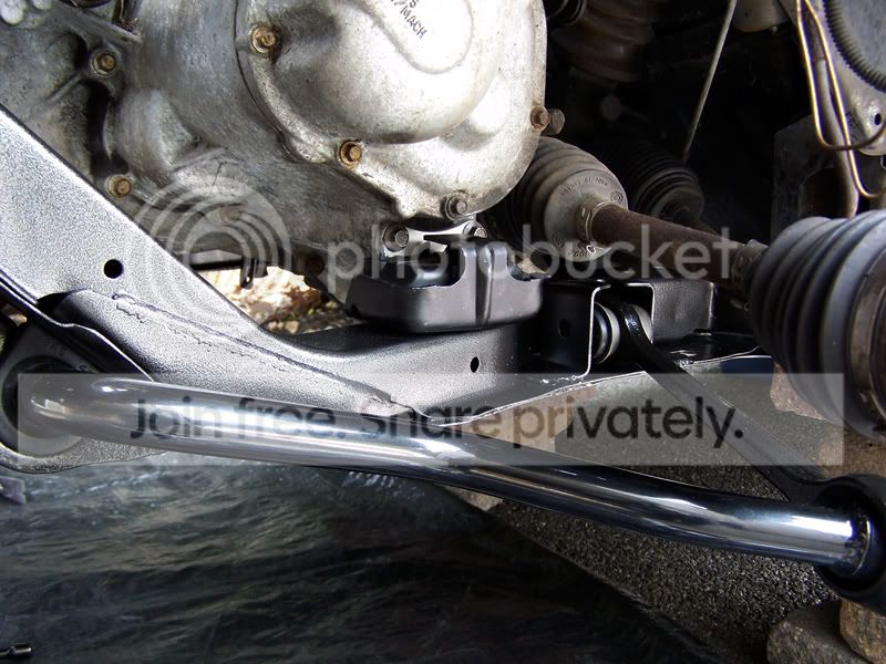

Me tightening the bolts on the trans mount. I got like 4 shirts on, it was cold out in the morning but warmed up later in the day.

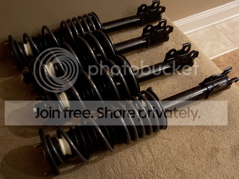

Monroe Gas Struts, Monroe Boots/Bumpstops and Progress Springs ready to go on next weekend.

Every bolt and nut was wired wheeled before going back on the car. I know it has a long way to go, but it will look a million times better than it does now when it's done.
