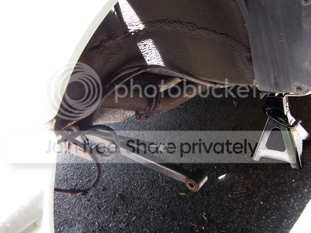

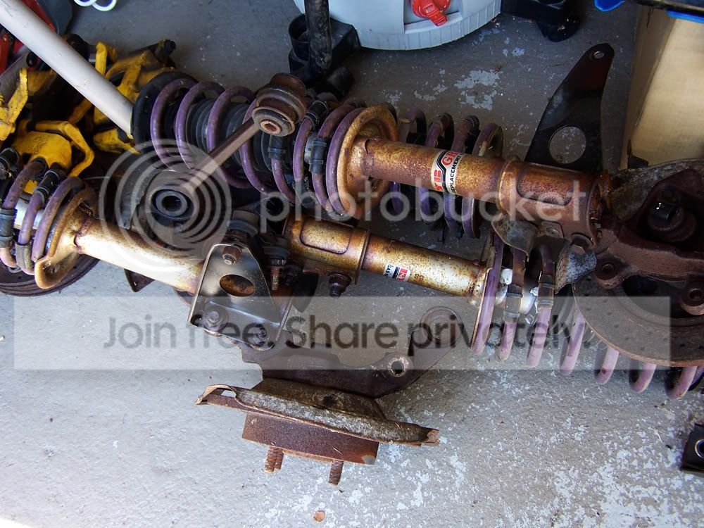

Look Dan :willy:

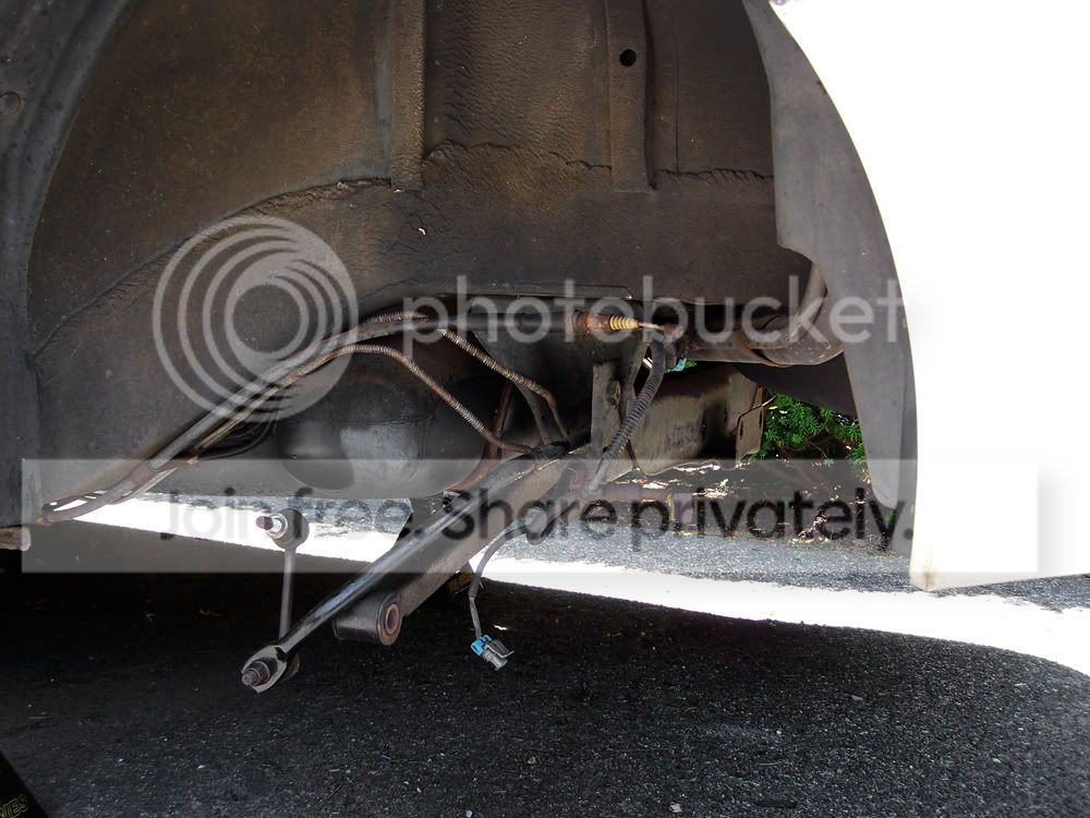

Getting out these stupid long bolts holding the Fr and Rr lateral arms in the rear knuckle proved to be the biggest pain in the ass so far.. I had to use a lot of heat , a 2lb sledge hammer, and some anger thrown in for good measure. They held on 'til the very last fractions of an inch.
Now to get the other last two lateral arms, the subframe has to be dropped (which is another assache) since there are hard brake lines running through them. Fun Fun Fun
The Northeast owes me new struts, knuckles, bearings, hubs, springs :fume:
