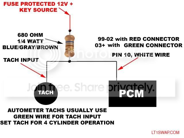

Need any help with wiring info hit me up foo, wiring up the tach scares some folks off but it's not that bad. Hell I'll send you the resistor for it, the local Radio Shack didn't have the right one.
Thanks man,
I made a living in 12 volt electrical for better than 20 years, hope I can figure it out! :ohnoes:
Nevertheless, I may pick your brain for something, I'm sure! :lolup:
Thanks man,
Screw that I hate wiring now :lol:
Prior to the engine swap the most extensive work I had ever done on my truck was install shorties...so that should tell you it was pretty straightforward!
