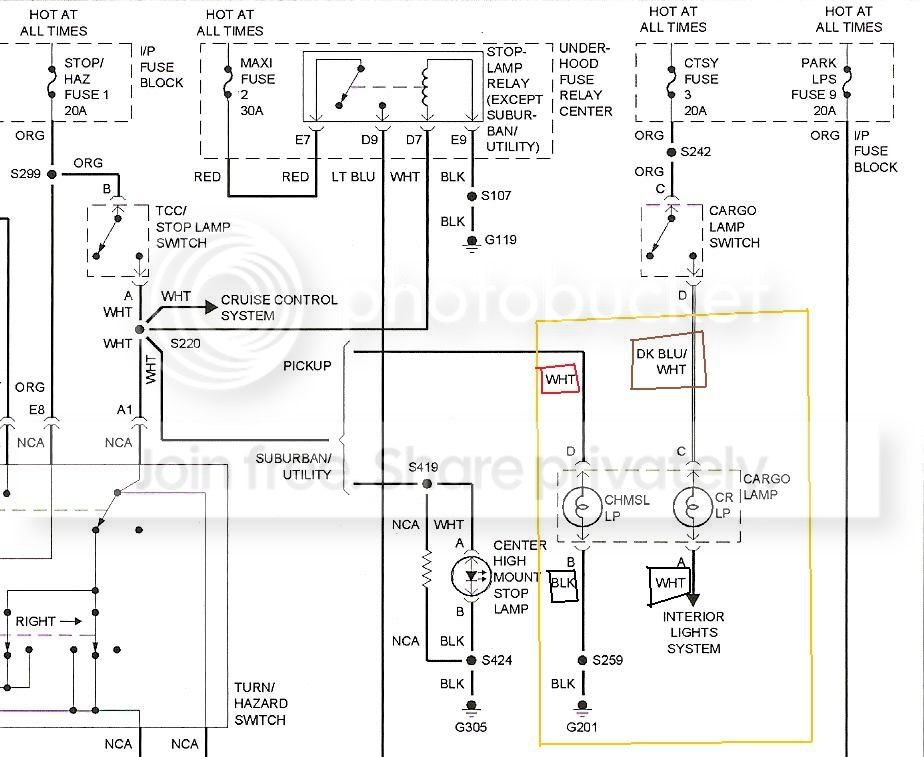

I think that's what it was doing. But when I turned on the interior lights, the 3rd brake light worked just fine which is why I think its a resistance problem due to the LED's VS conventional bulbs.
Post pics.
So you have 2 light circuits, and a ground, correct?
If the door is open, the cargo light is on. If it was backwards, it would be opposite.
If the ground was not complete, the cargo light will "find" a ground through the brake light circuit.
Post pics, we can help. If you have a meter, we can see what is happening on the ground circuit.
Just parking this pic.
Yep. No problem. My bet is the ground circuit is the issue. It grounded through the brake circuit, lighting it up. Poor ground in the connector on that new light.

Here's what happens
with the LED tail lights and LED 3rd brake light plugged in
-plugged in 3rd = brake light on on 3rd only
-push brake pedal = tails come on, 3rd goes off
-let off pedal = tails stay on, 3rd comes on
-turn on interior lights = 3rd goes off and tails go off
.......................................tails and 3rd work properly
-cargo light = can turn on with the interior lights off (they're supposed to be on for it to come on)
If I plug back in the factory 3rd or leave the LED 3rd unplugged, everything works just fine.
I know the turn signals are working properly because they aren't "hyper" with the new tails. I think there are resistors or something mounted on the back side (probably in the gray box mounted on the back of them).
