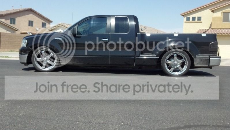

Might be going lower!

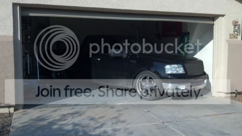

Sorry for the dirty truck, it is getting washed once the sun is behind the house and I can wash it in the shade.
It almost fits diagonally...

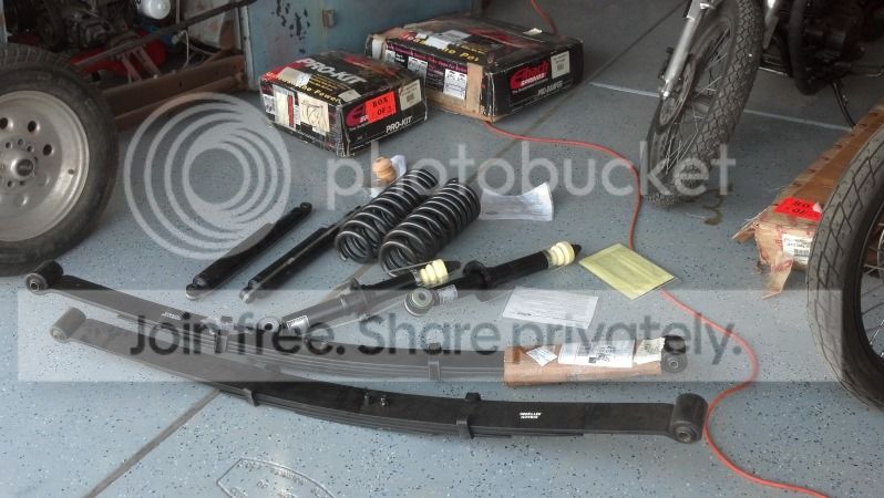

New Eibach struts, coils, and leafs, the Eibach rear shocks are too long for 8" of drop so I stole the shocks off the rear of my 32 ford

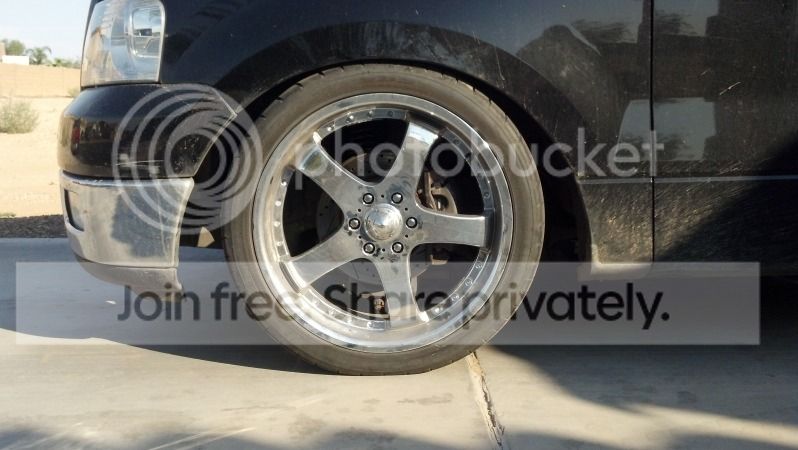

Front ended up almost an inch lower, so I will be ordering a new spacer for the front to lift it back to the 4.5" of drop. Don't get me wrong I love it and would drive it like this and even lower the back to match but my frame hit the ground 4 times on a 10 mile drive around my city.

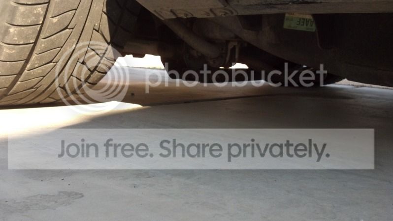

Front crossmembers are about 2" off the ground...
