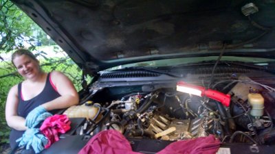

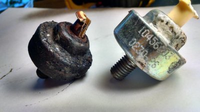

I finally got around to tackling this. I've had the parts for months now, just been putting it off. BeBut I finally started working on it this weekend. Back was killing me though, had to keep stopping and take breaks. John, I did take your advice about the oxycodone. :lol: There was 15 years of funk underneath my intake. And the rear sensor was rusted to hell, while the front one didnt look bad at all. But I got em sealed up good with some blue RTV sealant all around the new harness. I made a 1/2 inch high wall around the rear sensor with the rest of the tube of the sealant. I followed Dan's write up, and got a torque wrench to torque them to 15 ft/lbs like he instructed. And then the inch/lbs on the intake. But I didn't even own a torque wrench, I have always borrowed one the few times I've ever used one. But just so happens that Harbor Freight had them on sale this week for only $10 each! So I bought two, one for ft/lbs and one for inch/lbs. I've read a lot of reviews about the HF torque wrenches, and people say that they are surprisingly accurate for how cheap they are. For as often as I use one, a HF tool is perfectly fine for that IMO.
It was hell on my back, but at least I had a decent lookin helper. :thumbs:
