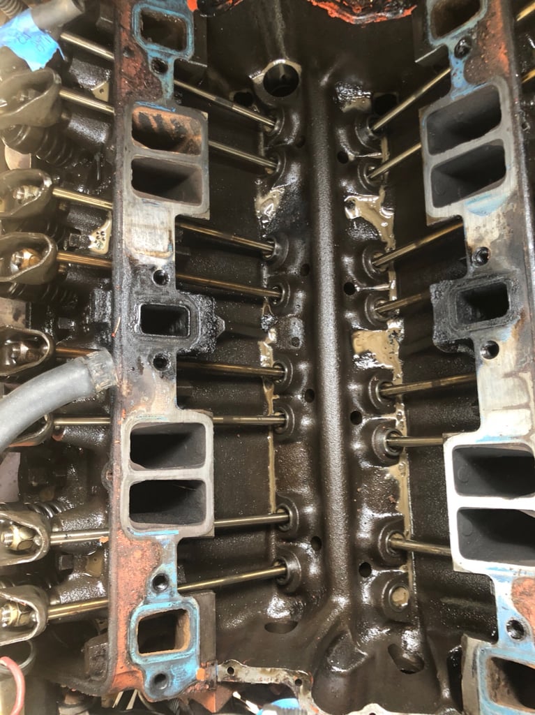

Yes we’ve torn the the engine down to the block. Is there a way to check if it’s good? I thought you had to take to a mechanist for block to flushed, pistons to get honed, mil the heads down, and run the valves. I honestly don’t know how all this works or even places to start lookin for either rebuild kits or motors when I find out what I need to do. And I’m looking to get out the cheapest way I can.

Not sure how many miles are on it, but I'd go ahead and pull the intake and replace the camshaft and timing gear and chain while you're in there. Those cams wear out at around170K.

OP, what is your mechanic skill level? They don't get much simpler than that 350, but if you are overwhelmed, then swing an engine.
To reply to your 2nd post; that is NOT torn down to the block, that is the intake removed, and that might have been all that was wrong. Did you find evidence of a blown gasket?
I would remove the heads, and take a look at the head gasket surfaces, and then you can see what shape your cylinders are in, and make a better call on replacing the engine.
