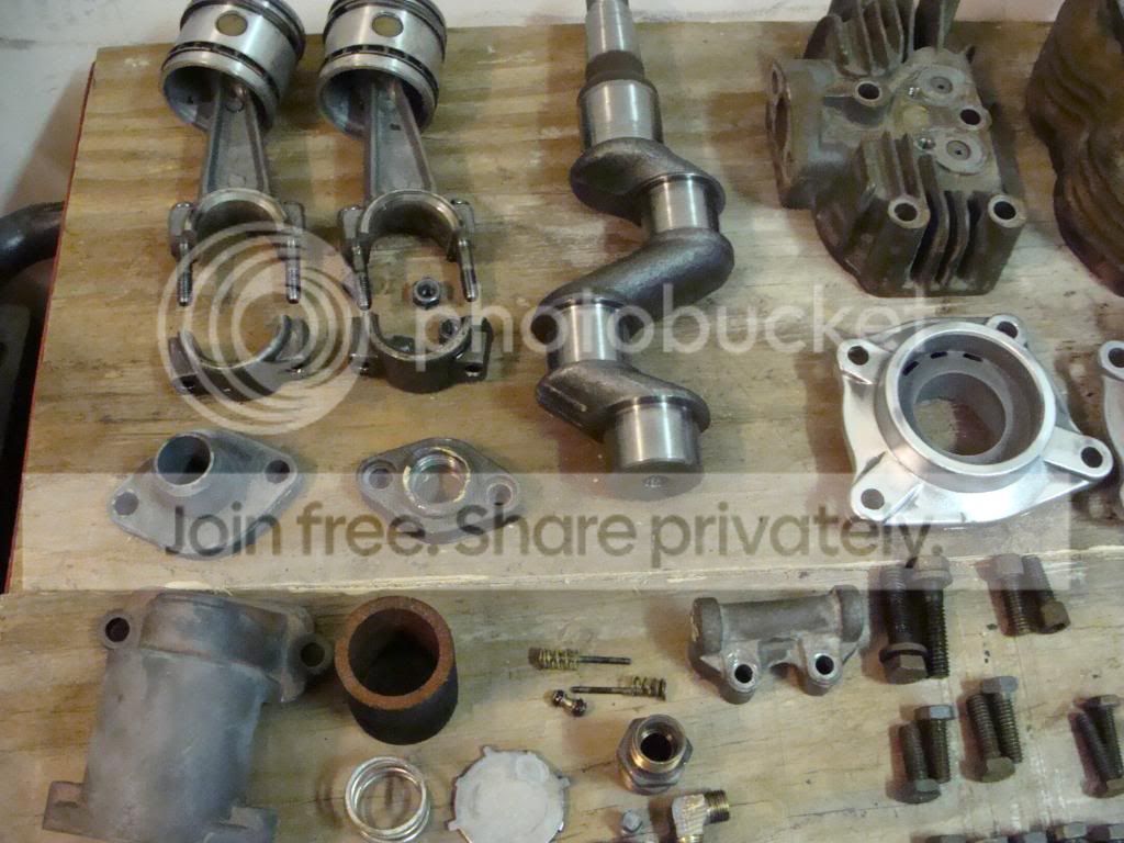

I need some help rebuilding my air pump
Lonesome7.3
By whatever means necessary …
Mar 25, 2010
3,296
Columbus, GA

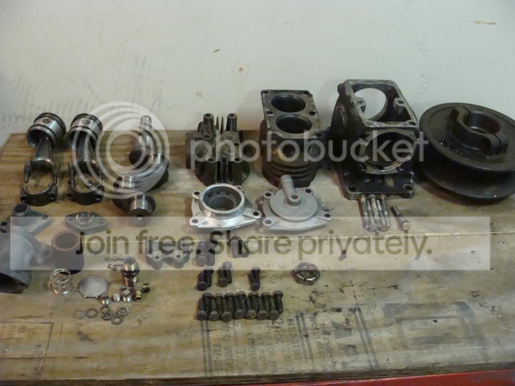

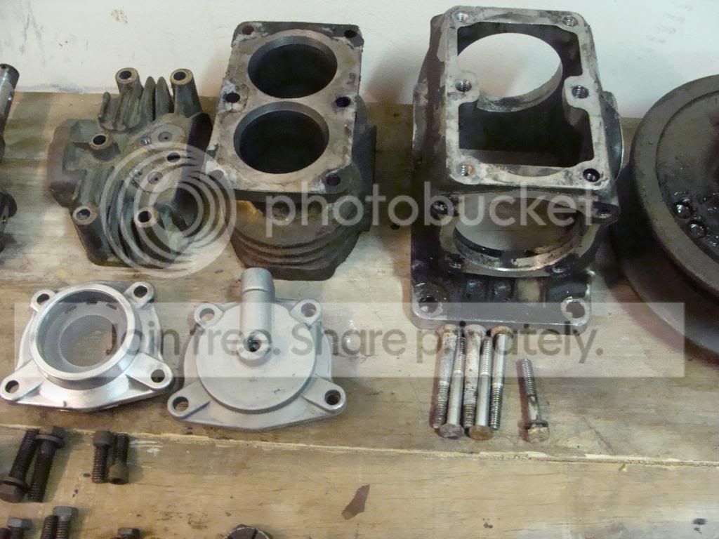

This is the air pump I have torn down and I have already made some mistakes. It came off a M35 military deuce and a half. I got for my deuce because it was missing one when I bought it. From what I have researched so far it is a Midland twin cylinder base mount. My intention was to just take it apart and replace all the gaskets. It was covered in grease so I figured they were leaking. It turned out the gaskets were all fine and the inside of it looked great. But it needs a good blasting and a new paint job anyway. I did finally find a company that can get me the parts but I only found one. I was hoping you all might know of some others so I can compare prices. Also, what are the torque specs on everything? And now for the biggest mess up I made. When I pulled the rotating assembly apart I got the pistons and caps out of order. I know that was a big screw up but right now I need to know how to fix it. I do not know which cylinder goes with which piston and with cap goes with which connecting rod. The cylinder walls look great and you can still see the hone marks on them. Being since all that looks new, do I still have to replace the piston rings? Any help will sure be appreciated; I have to get this slapped back together quick, fast, and in a hurry.
