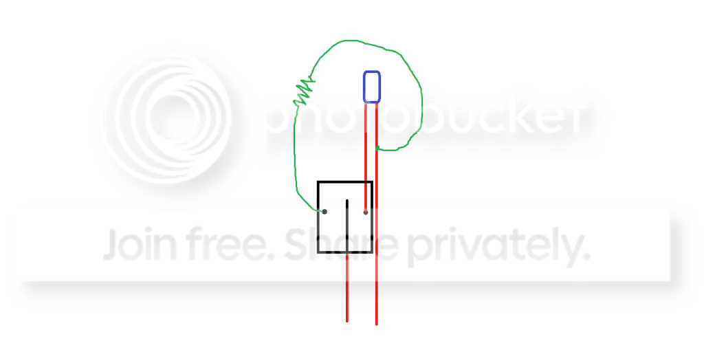

Chances are if you do the resistor mod, you'll lose your auto headlights, unless you wire up a switch to bypass the resistor.
This is my plan for that. The blue square is the sensor. The red lines are the existing wires. The black box is a SPDT(single pole, double throw) switch that has ON/ON positions. Not to be confused with on that has ON/OFF/ON capabilities. Lastly, the green line is an added wire with the 1k Ohm 1/2watt resistor.
Should work in theory right?:)

In theory :lol:
You're better off with the AHL's off with HID's in your headlights anyway... They don't always like being flicked on and off a lot, lol
I bypassed mine on purpose. I will decide when to turn on my headlights, damnit. :D
