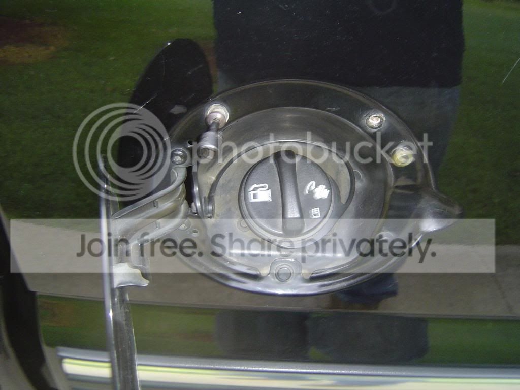

Here you have to remove the filler next bolts, then once it is loose, I tied it down to the spring to keep it out of the way.

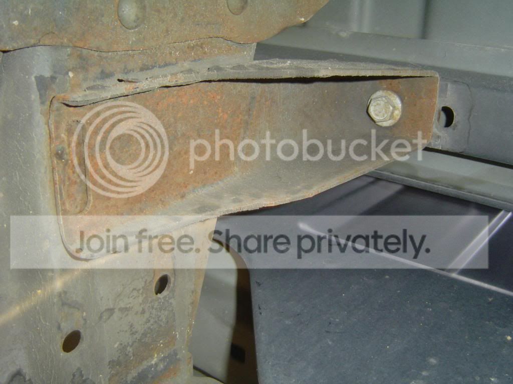

This is one of the eight bolts holding down the bed, size 18mm. My air wrench made short order in getting them out.

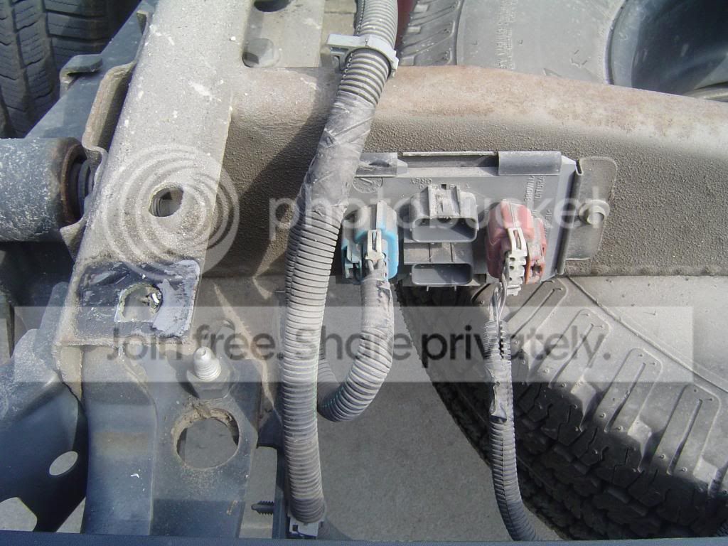

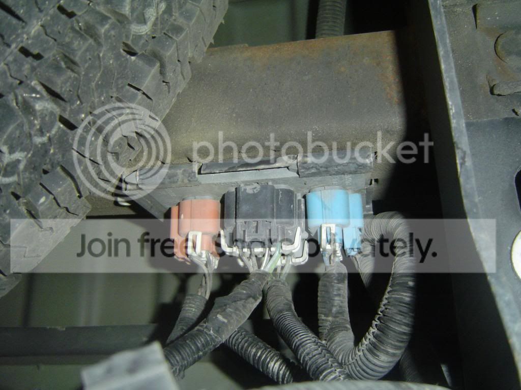

Here is the electrical plugs, the 2 that need to be removed are in the middle, one on top and one on the bottom.

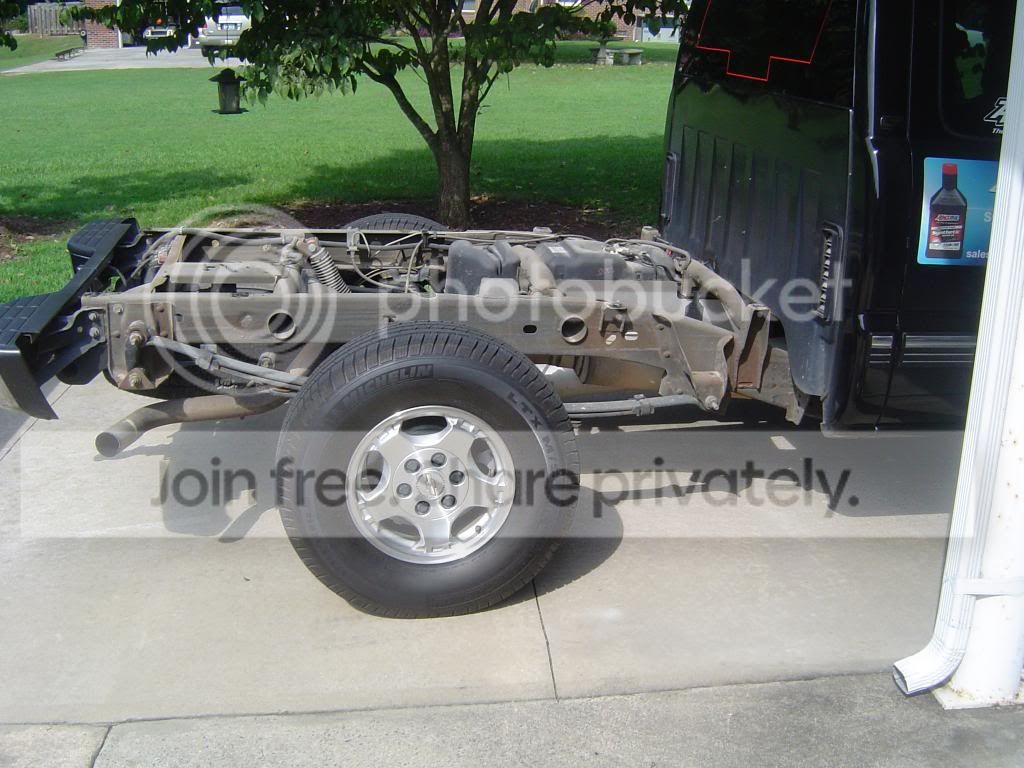

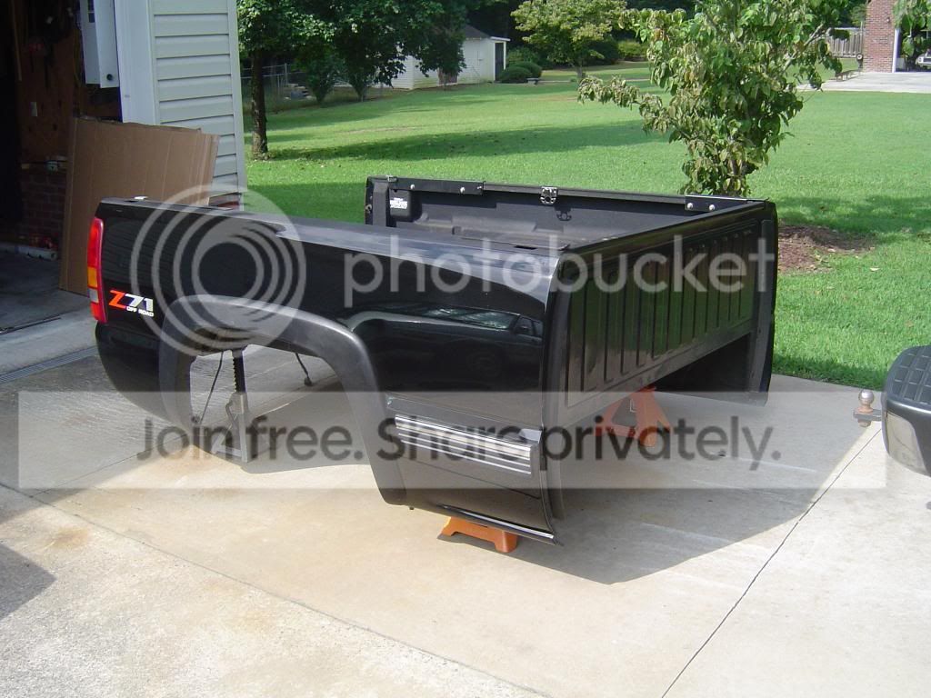

Bed removed from truck.
I just set it down on my jack stands.

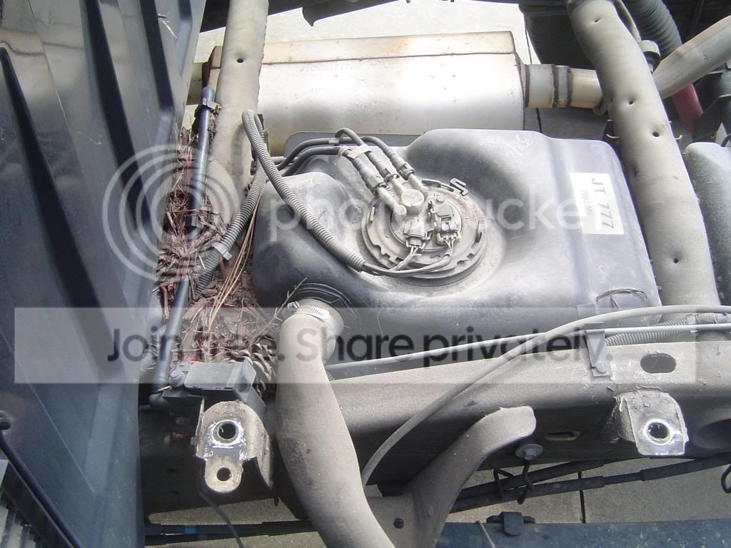

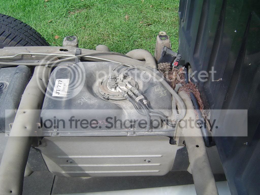

The nice mess of mulch and stuff on top of the tank.
What the plugs look like after the bed was removed.

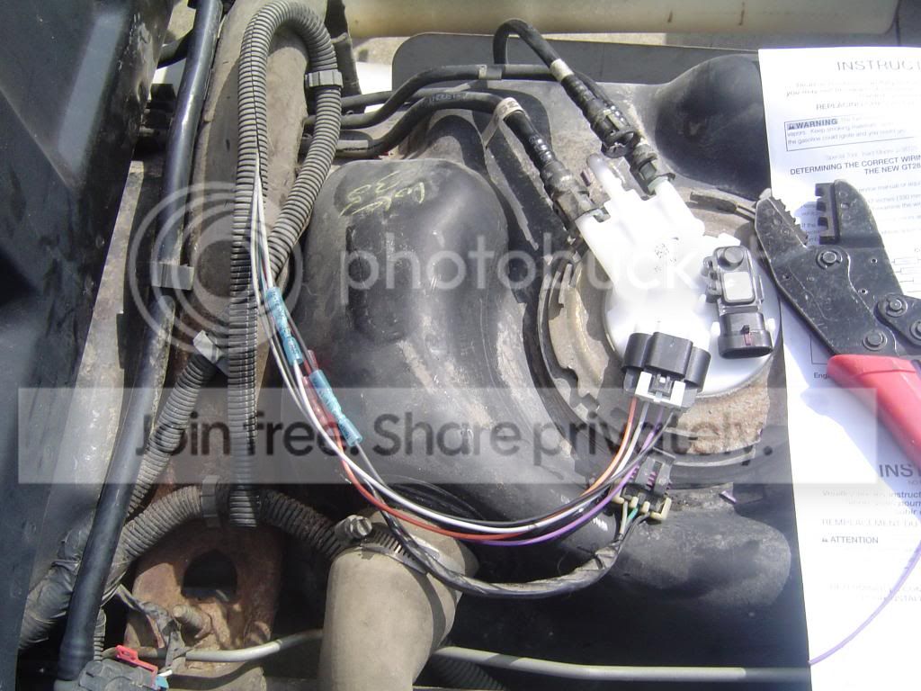

New pump installed and connected to new harness, just needed to heat shrink and wrap.

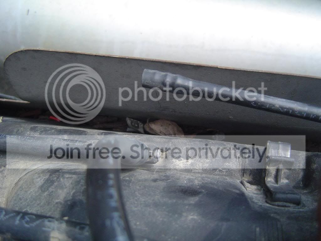

My screw up! I have to say, it seems I can't do anything with out something adding some excitement to the mix. :lol:

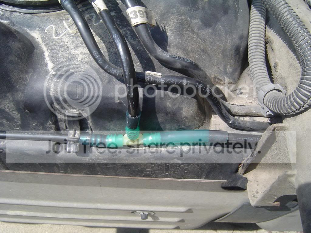

Here is the fix to my screw up!
Hope this helps the next person that might want to tackle this. I can say to keep from breaking that middle line, you might want to pull it out of the clamps that hold it down to the side of the fuel tank, to give it some room to move. I didn't do that and I think that was why it broke.
