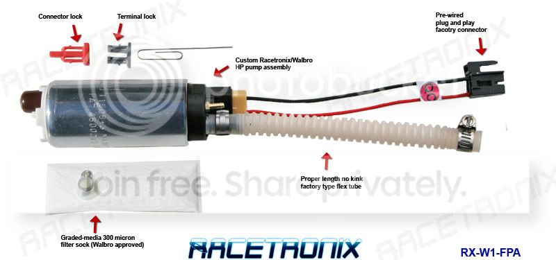

Hey guys if your fuel pumps out in a gm truck 96 (4 bar fuel system) and up consider a walbro replacement pump, or a racetronix pump. they usually run 100-150 bucks, which is much more affordable than a 4-600 dollar factory sending unit assy.
all it requires is removal of your factory fuel sending unit dissasembly and hooking the new pump up in the housing, then re-assembly. I have done this to my truck, the pumps are quieter and are rated for 255lph!
save yourself some cash and consider this modification. its very easy and self explanatory, but if you have any questions, pm me or post up your question here. i can walk you through it. i wish when i did it i documented by pictures of the conversion its sooo easy.
the ractronix part number is FPA-007, W1 Fuel pump assy.
the walbro part number is GS342 Fuel pump individual
