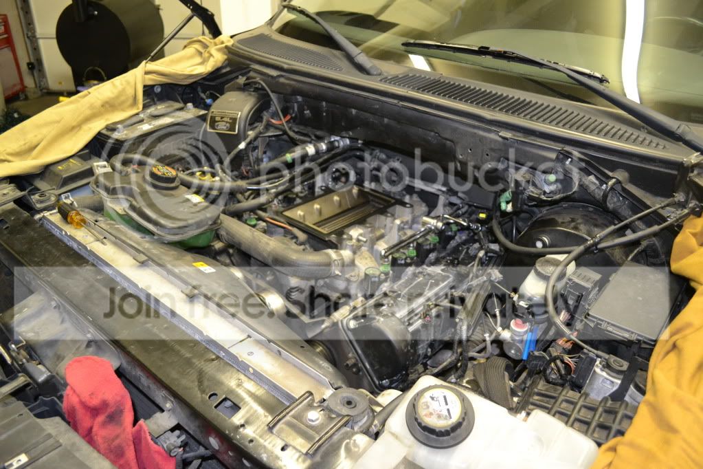

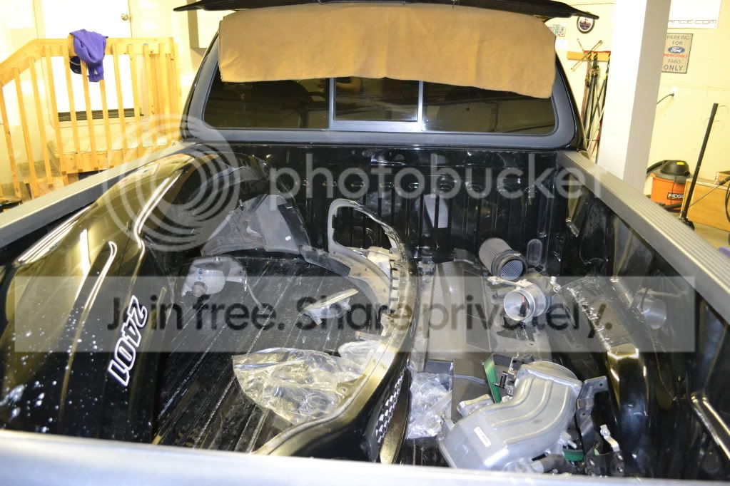

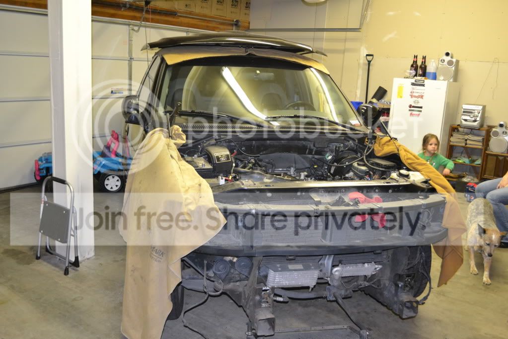

I'll update this post later with pics as I remove the motor and get the new one put together and prep for install.
If anyone local feels like lending a hand, or just wants to point and laugh, feel free to swing by.
