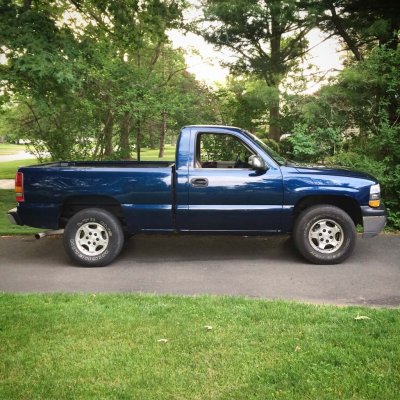

Guys, my truck is officially NOT STOCK anymore!
Tore off the moldings and badges the other day. Super exciting, I know.
Paid the truck off this weekend, so suspension parts should start to get ordered in the next week or so, and I'm working on a frame notch design and finding someone with a press brake currently.
Also ordered a buffer, and a few things from Adam's polishes last night so hopefully I can get the paint looking halfway decent.
If it's not raining when I get off work today I'll probably throw the tint on the front windows as well.
