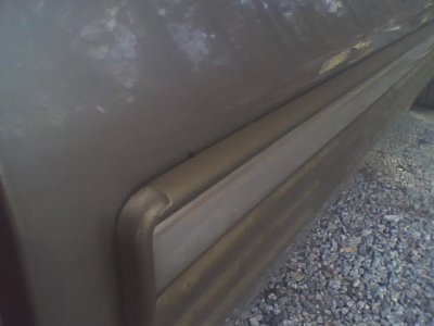

Here are the pics that Jeff wanted to see. They are from my cell phone and no the greatest but show what I am talking about.

I'd say pull it. I'm 99% sure that it's just held on with 3m adhesive. some goo gone and fishing line will do the job
I'm a 100% sure. I watched my neighbor remove his. He has a 2004 Silverado and he removed all the badges and trim in like 2 hours using that wheel I posted earlier. It takes a lot more time with the Goo Gone or acetone. I spent 3 hours on just my door before I decided to go get a pinstripe wheel.

I had clips and metal heads holding mine on. i took it off and the body lines are much smoother.
Oh I know. The older body style Fords trim was on there brother! The 97-03's is just trim tape. The thing that pisses me off about Ford is the damn badges ALL have guide holes. So if you want to remove the badges you got to do body work. I guess the Ford employees had trouble putting the badges on straight so Ford decided to punch guide holes in the panel where there's badges!?!? :dunno:
