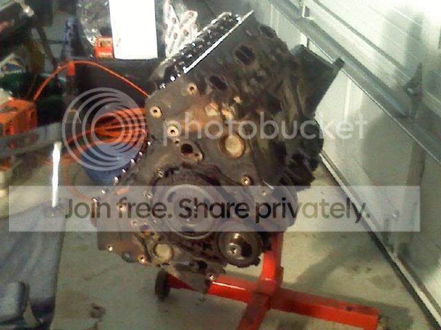

Got everything off of the old motor.
Just about got everything back on the new motor. Just primed the new oil pump. I couldn't find my Haynes repair manual cause I wanted to set the time before I put the motor in the truck.

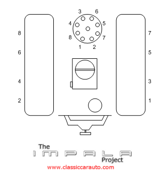

Looking for the firing order... FUN
