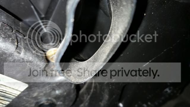

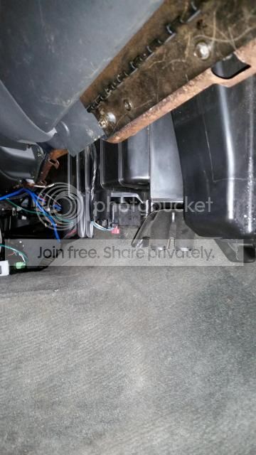

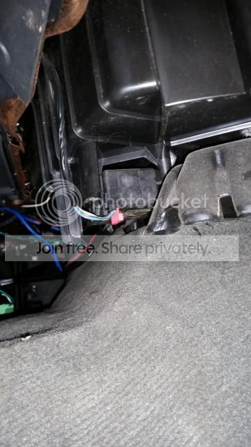

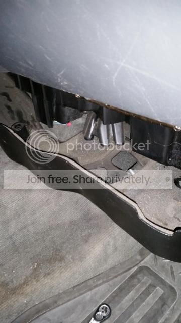

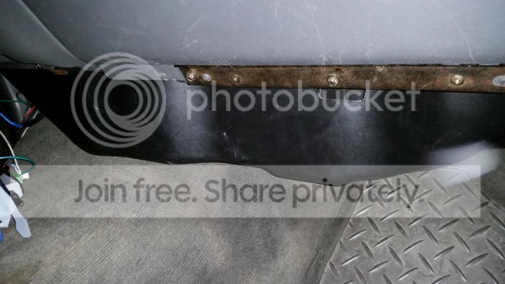

I dont have the center console, but just as easy. I just pulled some of mine apart to show how easy.
Turn on the ignition set the HVAC to cold. Turn off. DO NOT TURN ON until the actuator has been re-installed. There are 4 , 7MM bolts holding the under the passenger side dash. Two by the floor panel, one on the tunnel and one by the driver side.
Unbolt them, then pull the panel. The actuator is held on with 3 screws. Pull the connector and unscrew. Reverse for install.
My phone cant get in the tight spots.
Cover
The actuator has the red clip on it.
Remove HVAC fuse.
Reinstall HVAC fuse and wait 1 minute while it calibrates. DO NOT touch the HVAC settings.
Start vehicle.
