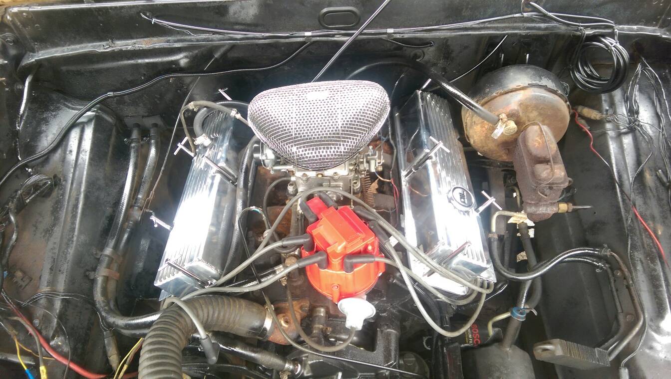

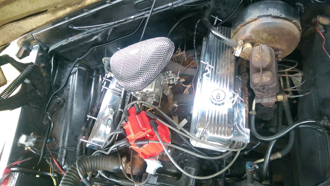

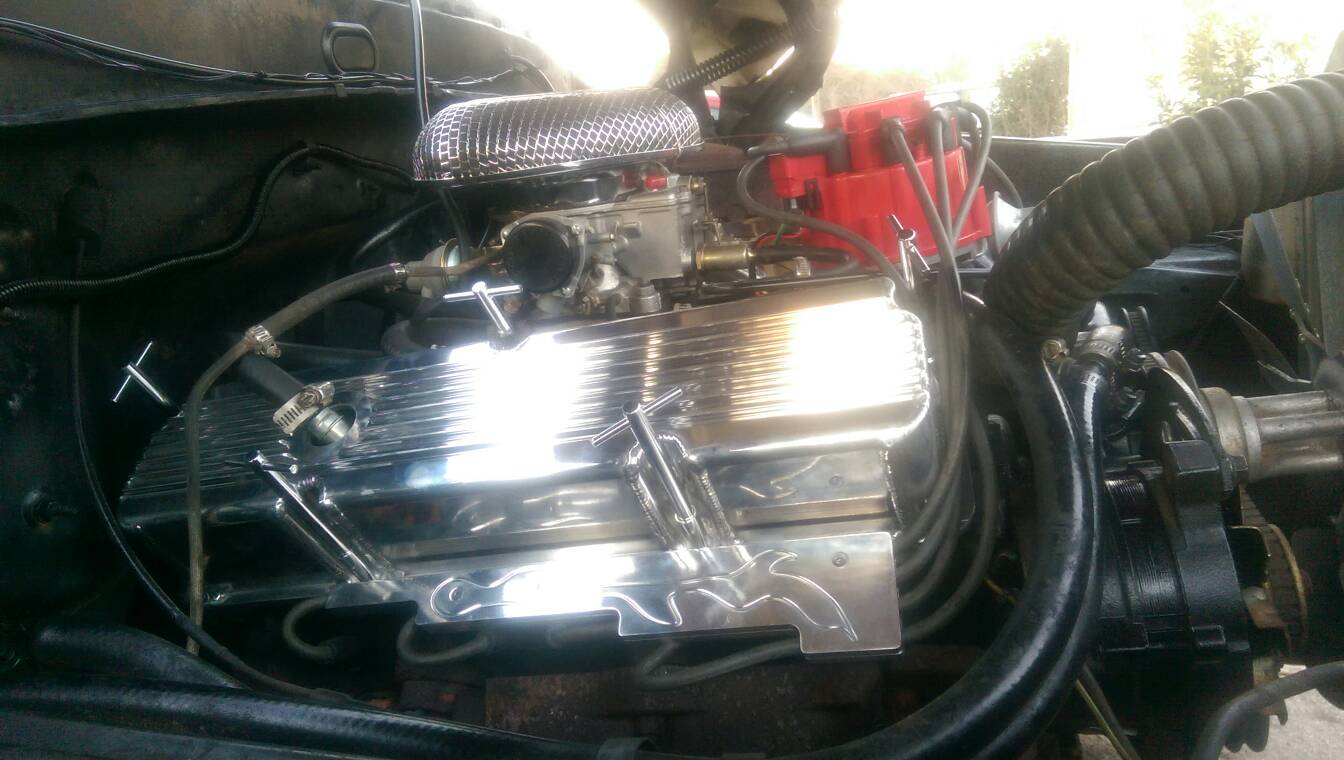

Finally had a chance to do some work on the truck. Yesterday I did the first coat to blacken the engine compartment. When the temperature gets above 65 again, I will lightly sand the dull spots and shoot again. This is a trick to save sanding time.
Today I installed the new valve covers and the new wire loom. The loom was initially too long, so I cut it and repolished the edges. I also needed to drill and file the mounting brackets for proper fit. The T handle at the brake booster wouldn't fit, so I installed a stainless steel allen bolt there instead. All in all, a very productive day. I especially like the oil filler plug.

Next I will install the chrome brake booster and billet aluminum master cylinder.

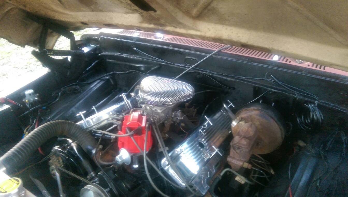

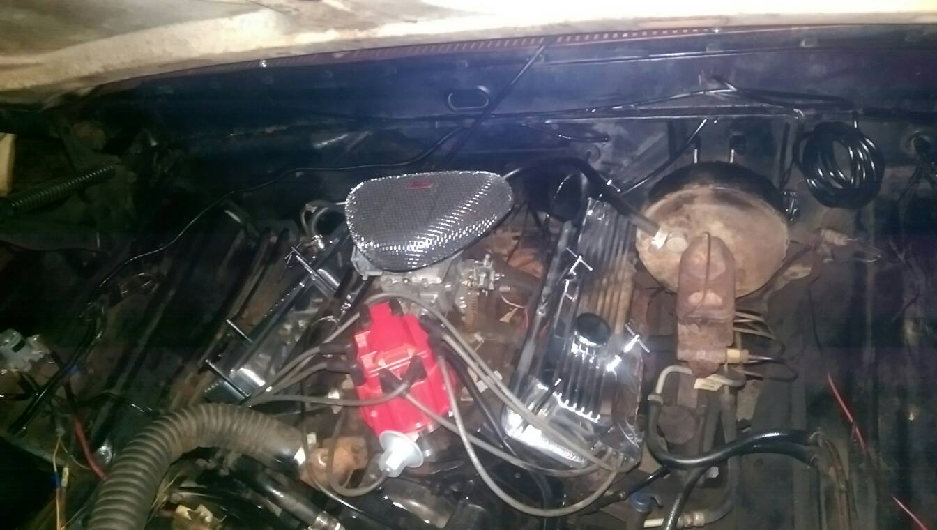

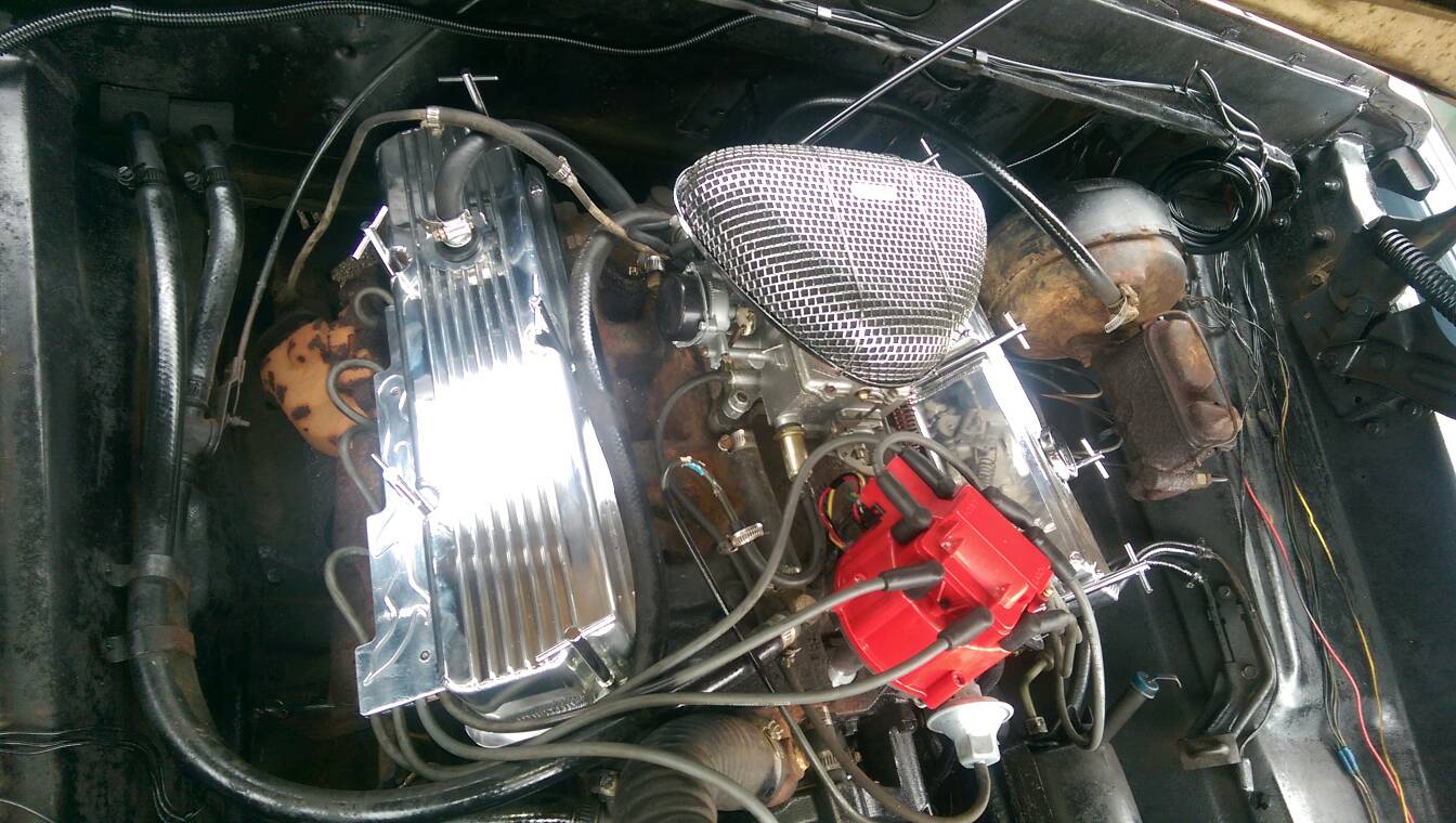

Here are some better photos.
Sent from my HTC One_M8 using Tapatalk
80,091
It looks good, but I think I'd have taken the time to paint the intake manifold. :dunno:
80,091
Upgrading the engine later. These parts will inteechange.
I did the top end in an old '74 350 I had and painted everything Chevy orange and black while I had it apart. I never thought about taking any pics of it, but it sure looked good. :lol:
