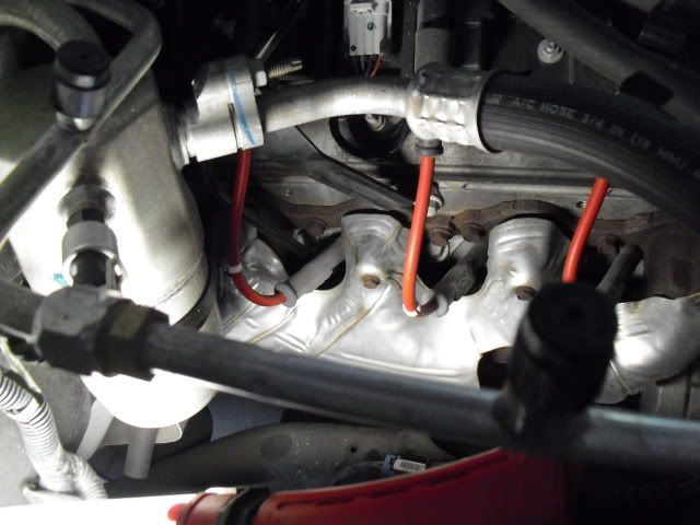

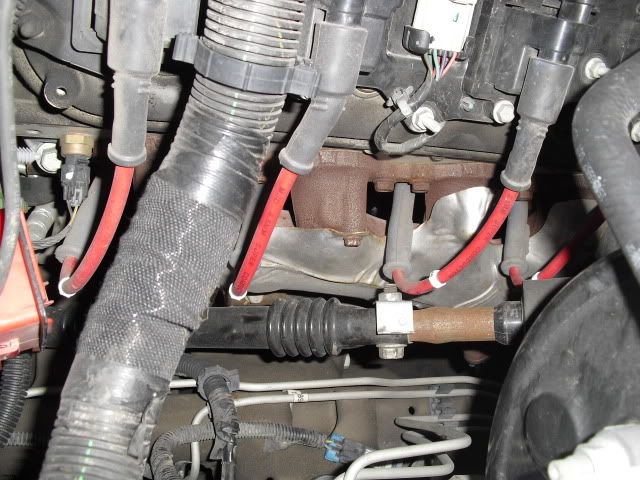

Stock manifolds:

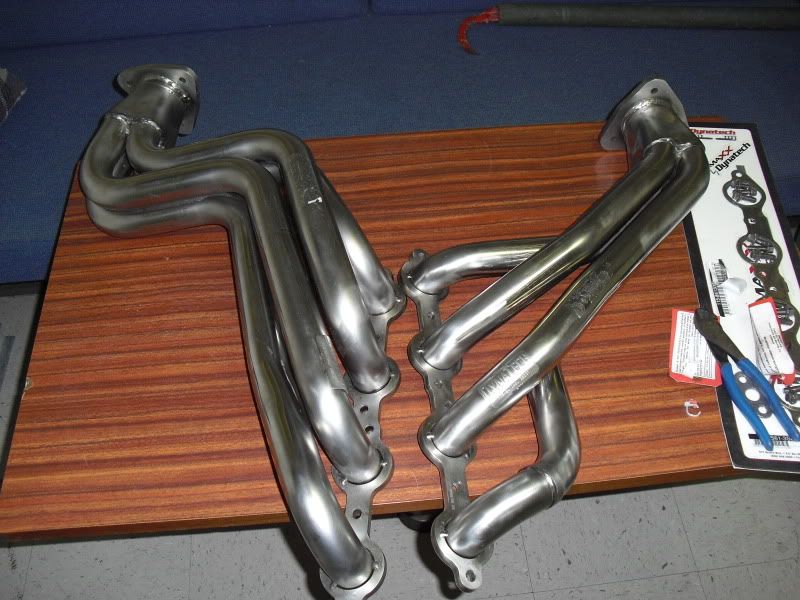

New uncoated Headers:

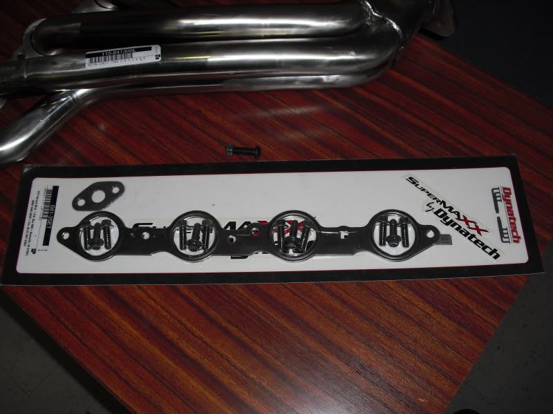

New gaskets and hardware.

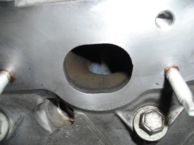

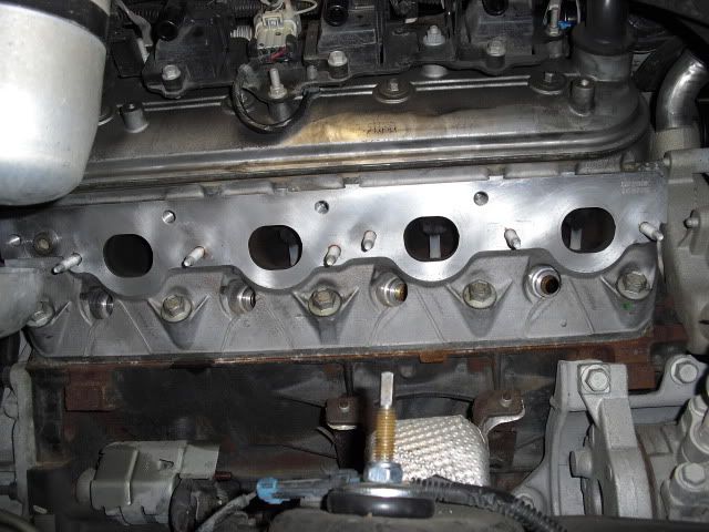

Manifolds removed head cleaned and studs installed. I was impressed with how little carbon build up there was in the engine. Nice and clean for 100K miles.

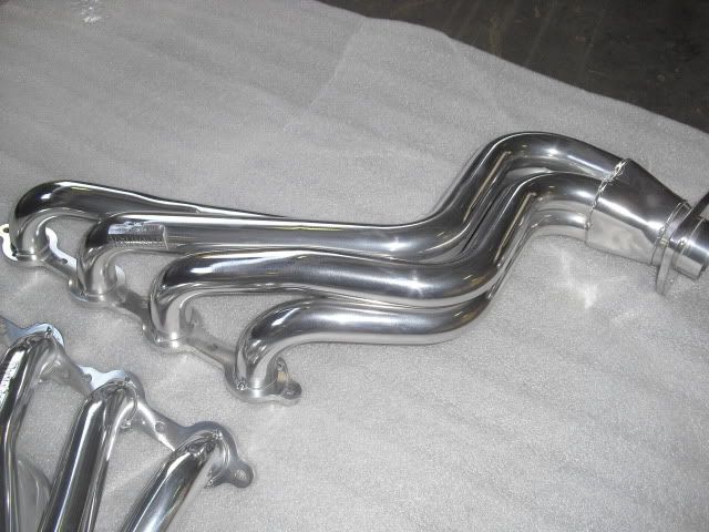

Jet-Hot coated headers:

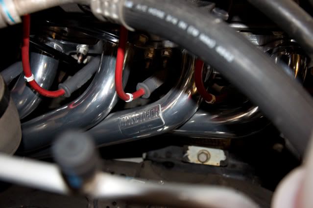

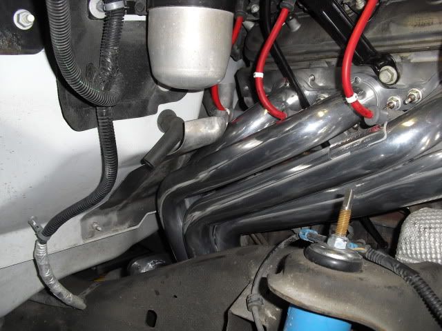

Installed:
I can tell you there isn't a lot of room in there so be prepared to take your time. The system fit great and there was no extra trimming or beating to make them fit. They sound bad ass too sorry I don't have video but will see what my little camera can do later. :thumbs:
