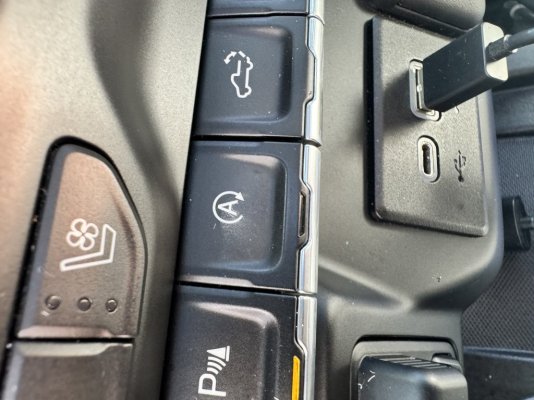

There is another device that easily attaches to the battery and alternator harness. I learned about it on the AT4 Forum.
To be clear, do you have the same switch that I do in the dash?
Different location, but yeah.
