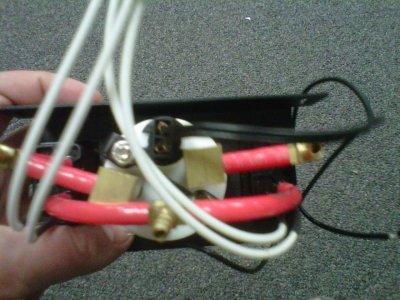

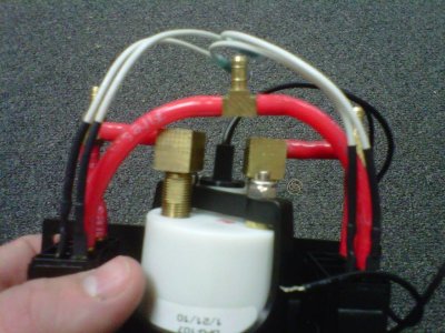

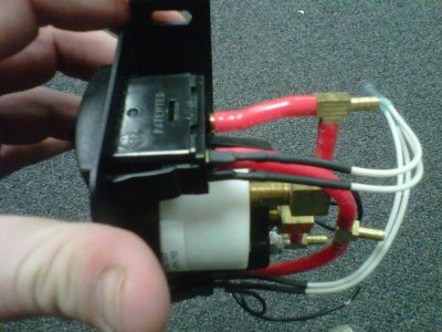

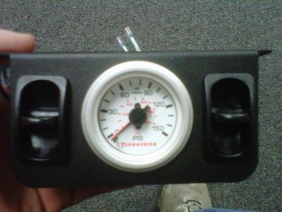

I have an idea that I would like some input on, Maybe OG can come in and help out with it.
I have this controller for my air bags and there is no real good place to mount it without being a danger to use when Im driving. I would like to take the gauge out and put it in a visible spot and put the switches down below but within arms reach. The problem is this...
My thinking is that I can cut the tubes that run together and lengthen them and put the gauge where ever and mount the switches somewhere else.
Any Objections :dunno:
