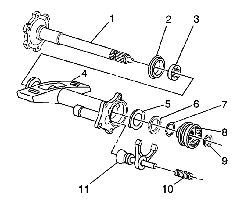

    Now you still need to strip down the long axle tube. Place it up on a bench and remove the 5 bolts holding the two cases together.
    [​IMG]
    Set it aside and remove the spring, shift fork and gears. Remember the order that you took them apart and don't lose the spring.

    Place the axle tube on the bench with the axle flange down. Remove the circlip, thrust washer and tabbed locating washer.
    [​IMG]
    Flip the housing back over and remove the axle completely.

    So now with all of the parts clean let's start re-assembling the differential. Take the long shaft housing and install the axle bearing and axle seal. Smear a little bearing grease on the lip of the seal after it's installed.
    [​IMG]
    [​IMG]
    Insert the axle shaft into the housing and flip it over, resting on the axle flange.
    [​IMG]
    Place your tabbed locating washer, thrust washer and circlip onto the axle. Make sure the circlip is properly seated in the groove of the axle splines.
