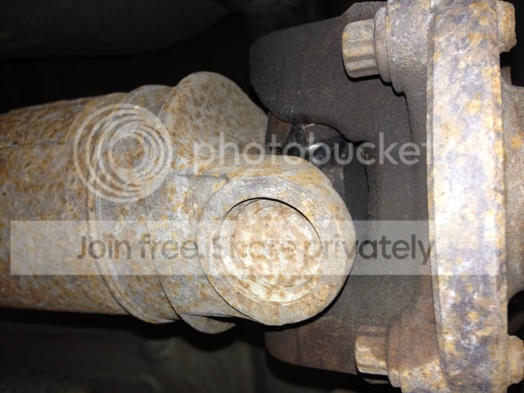

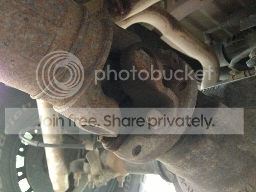

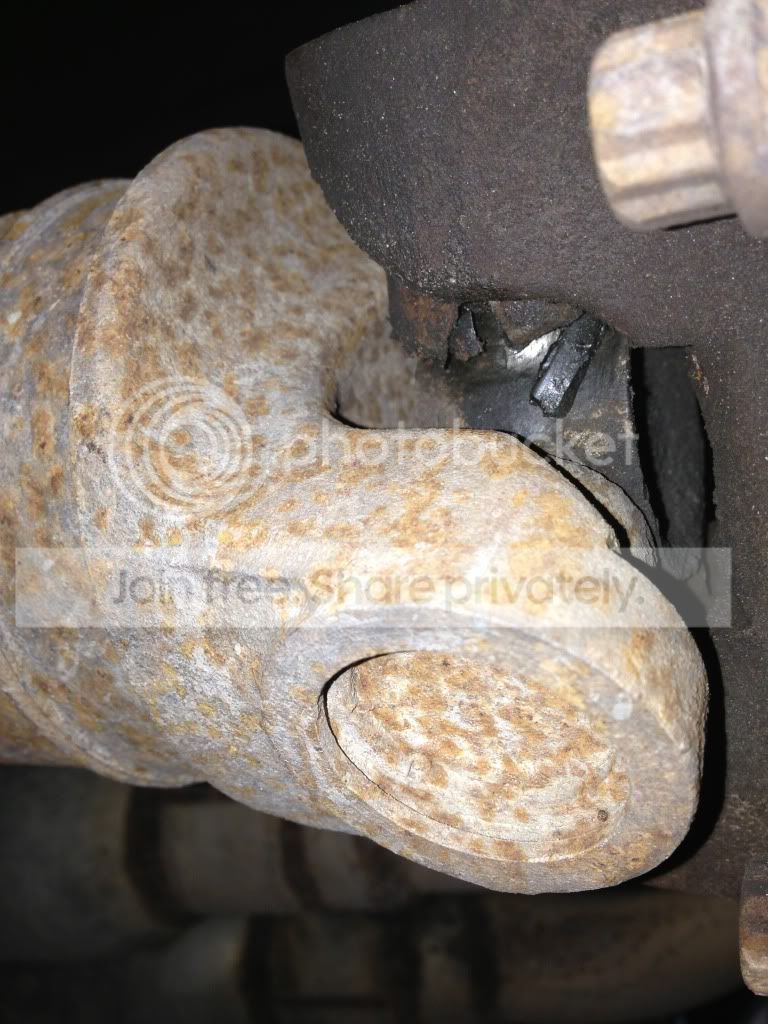

This just started happening about 2 weeks ago, getting a bad vibration at speeds above about 50. Vibrate then if i let off the gas the vibration is about 3 times worst. I had the same vibration in my old truck right after i lifted it. About 3 months after i put the 3" blocks in my driveshaft snapped at the U joint. i've had my lift on this truck for about 5 months. Wondering if the increased pinion angle is trashing my U joints? I crawled under and took some pics. noticed this:
80,093
I'd definitely be changing that as soon as possible. I'd also be willing to bet that is the cause of your vibration.

Yep, pretty much the issue. Good catch. Might need to check the drive line angle and see if you need to adjust it to keep this from happening again. 5 months is not a long time. It would suck to have to keep changing out U joints.
