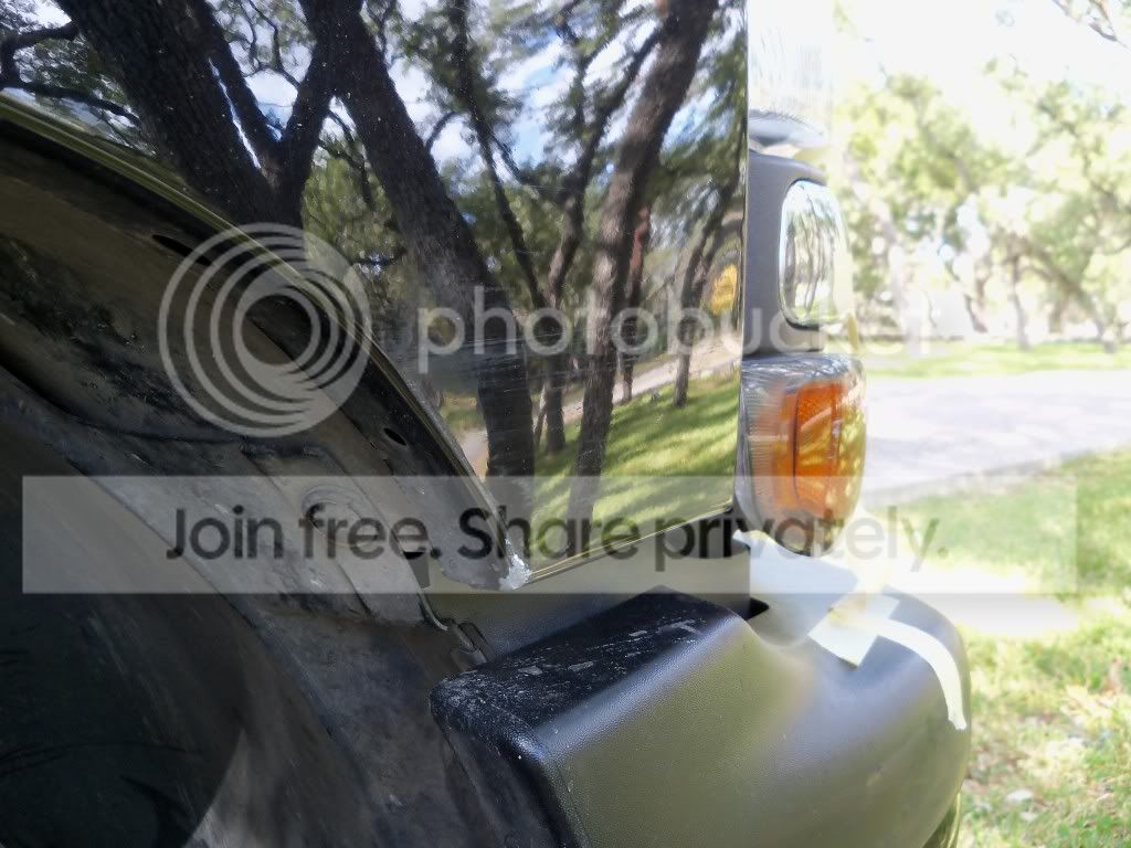

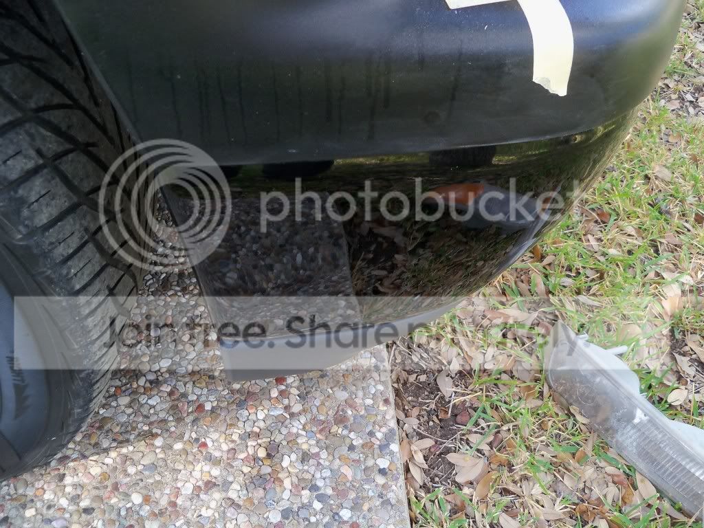

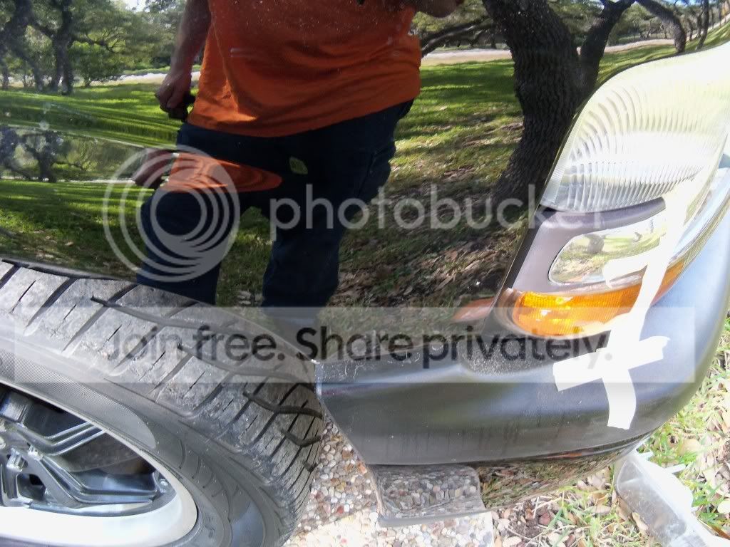

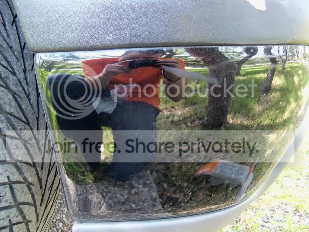

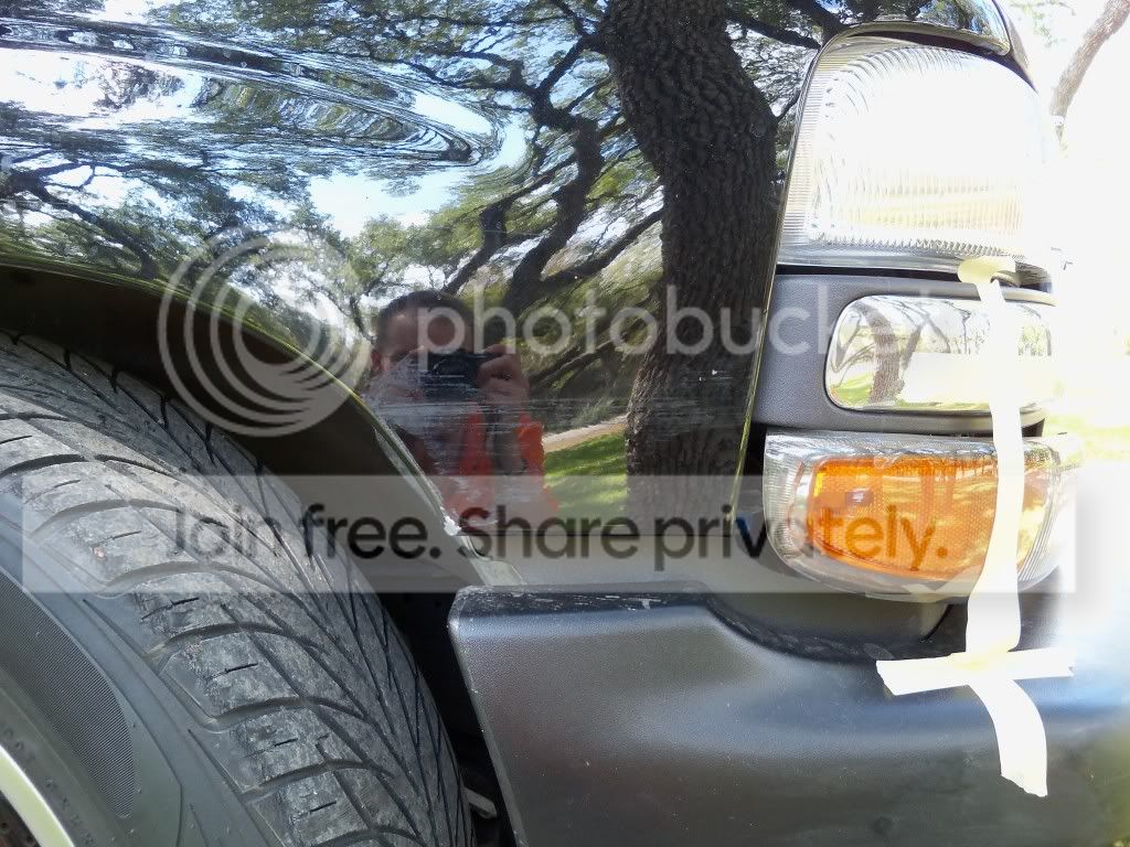

So I got into a minor fender bender. Scuffed the fender pretty good, and as well as the bumper.
Got my shipment of the SSR (Serve Swirl Remover) in. Talked with Dylan to see whats the best pad to use for the spot pad kit. He suggested the orange pad to use with the SSR (Serve Swirl Remover). (They havent released the green focus pad till recently)

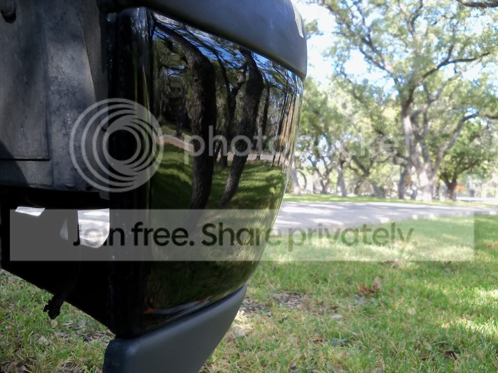

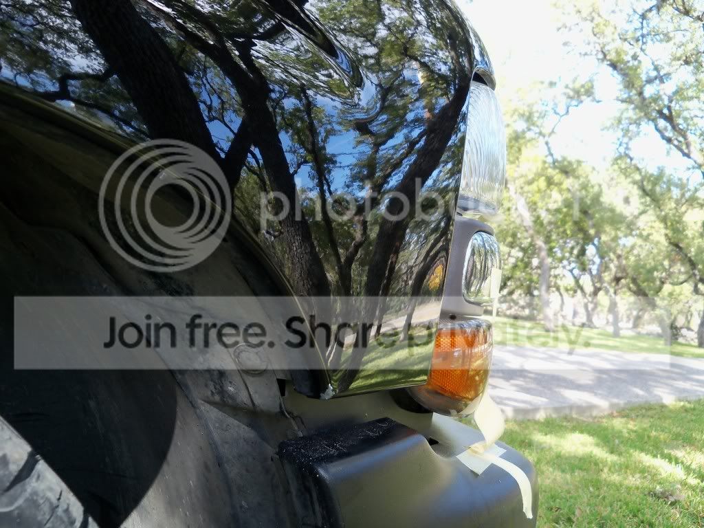

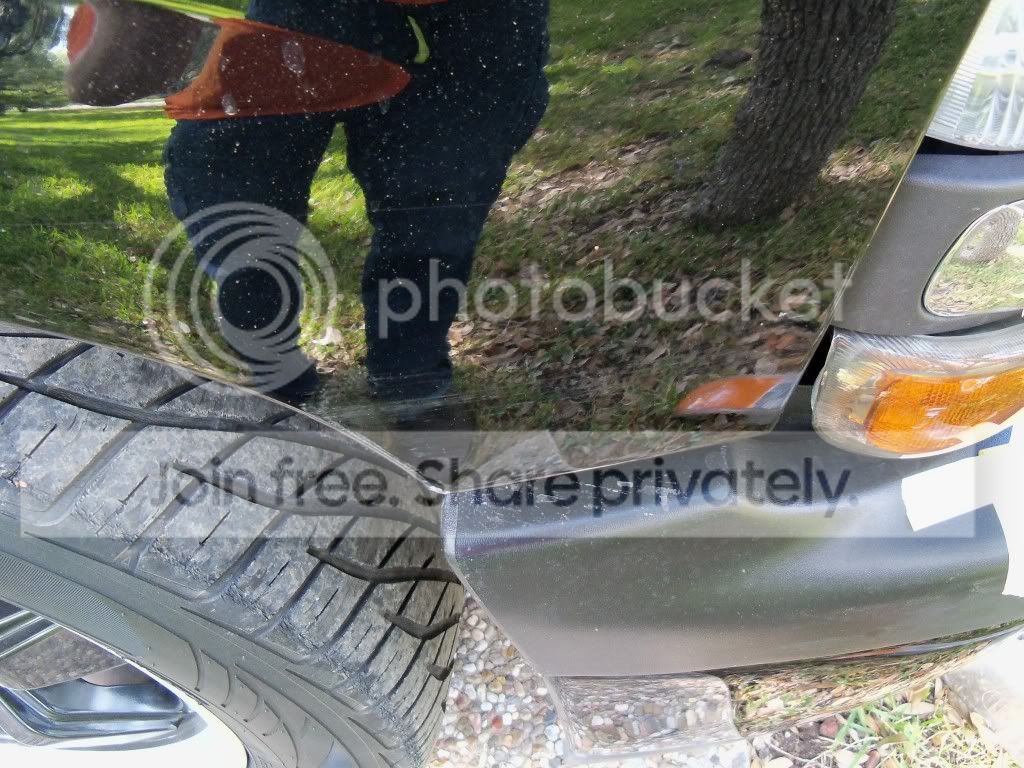

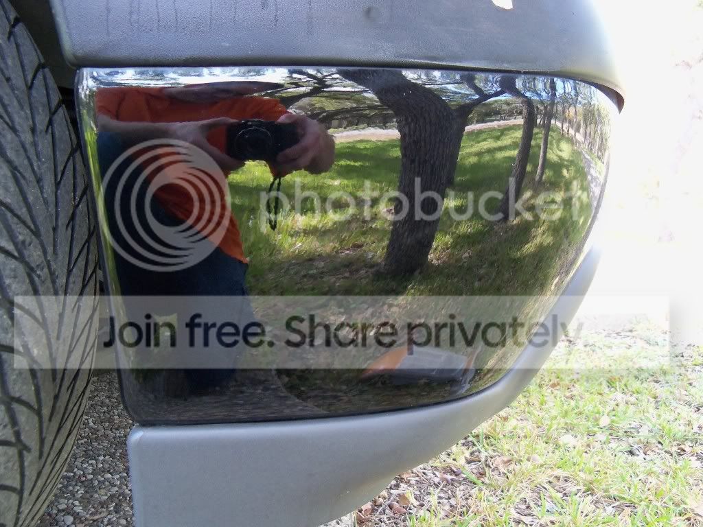

Got to work, most of the time I've spent 30 to 40 mins doing a spot repair/fix. The SSR got it done in half the time. Used my Porter Cable 18v drill.
Steps: clayed, orange pad with SSR (Serve Swirl Remover), a different orange pad with SHR (Swirl Haze Remover), White pad with FMP (Fine Machine Polish).
Excellent results. :thumbs:
