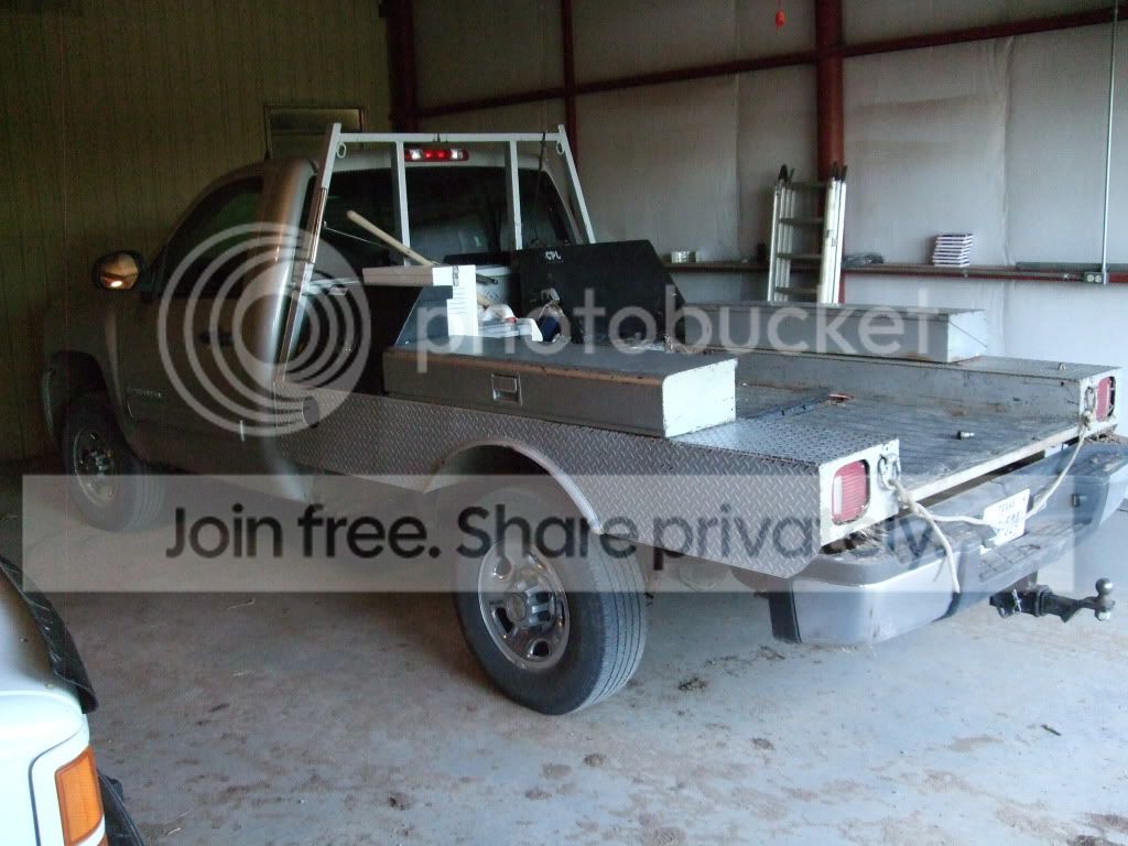

My dad made his out of diamond plate sheet metal and other odds and ends he had. It weighs quite a bit, but wasn't too hard to do.
The side tool boxes were originally over the bed side boxes. He cut off the bottom part that hung in the bed.
