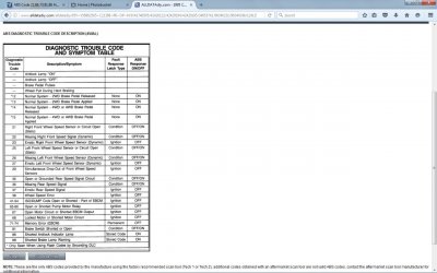

Have you ever checked trouble codes when the Check Engine light is on by jumping terminals A & B by counting the flashes? You can do the same thing by jumping A & H and counting the flashes of the ABS light.Of course this is after you've located the ALDL connector :D Connect A & H before you turn the key on(engine off).
I'll see if I can find my list of ABS codes.

Found my list of ABS codes:
