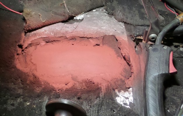

Think that's the old carpet ... ??
I have the replacement .. It's Limo carpet ..
Back when I installed the sound deading mat I didn't know what all would be needed to do to install the overdrive trans ..
Thoughts was at that time to reuse the hole for the t-case shifter .. As the trans was being built seen right off that wasn't going to happen ..
A whole new ballgame was at foot ..
Not a biggie ... Just a bit more work ...

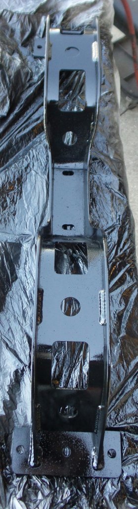

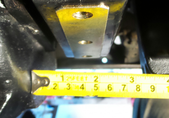

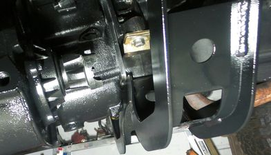

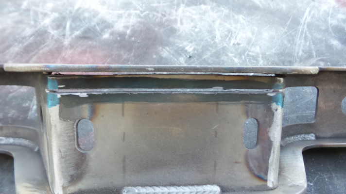

Crossmember came in ...
Not going to be a Plug & Play gig .. !!
As with most all of parts for a Frankenstein there's a need for fine tuning ..

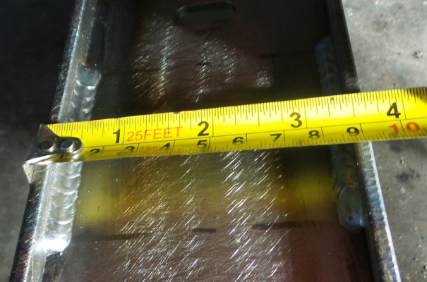

Lets see what a tad of Slice & Dice will do for it ... Want too ??

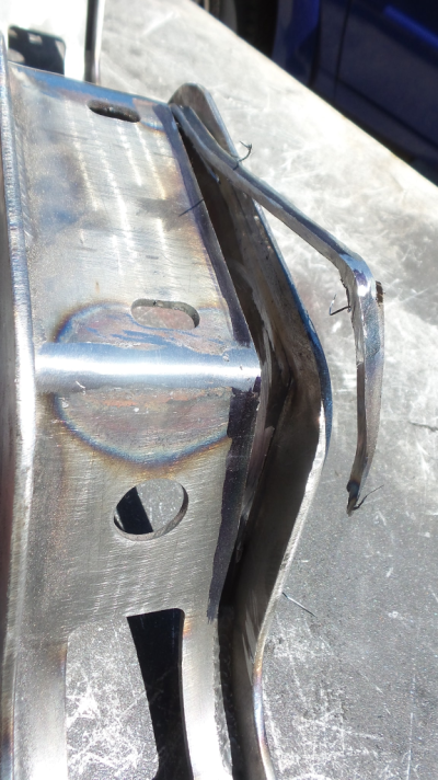

That's one, five more to go ...
Taking 1/2" off each side .. That should get it narrowed enough to fit ..

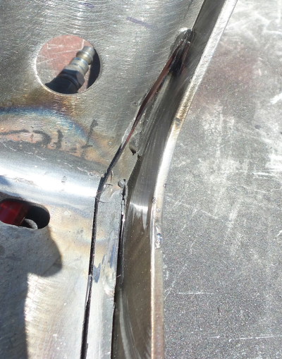

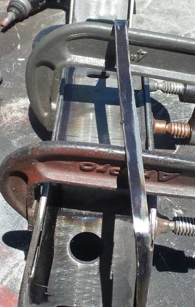

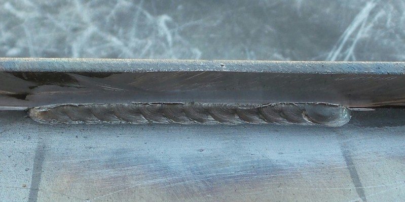

Well ....
The effort is there ...
If I can stay on it all day might get it on the truck by the end of the day .. ??
The slice ^
Not sure if I had got to the dice part or not .. ??

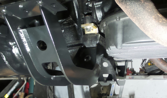

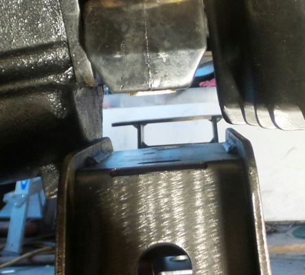

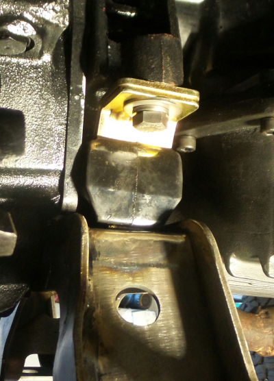

That's one side ... Threw on a few welds and will do a test fit on the truck ..
Test fit said .. "Close but no cigar !!"
Almost could bolt it on, but it would be rubbing on the pan ...
I'll do the other side ...

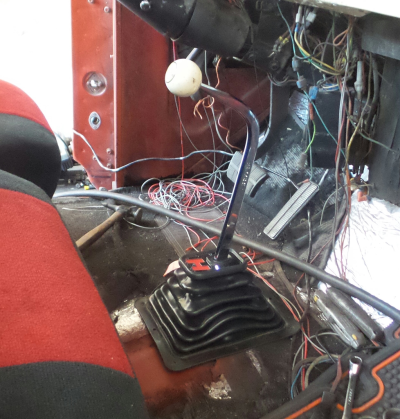

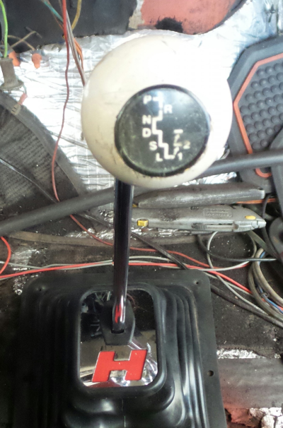

I like the idea of the longer shifter.
The longer one fits the persona of the build better..
Long it is ..
Dang ... I forgot to install the clutch pedal .. !!
( Never grow old. it screws with your memory ) Lol
Or did I ??
( Something still ain't quite right with this set up ?? )
I know what's up ..

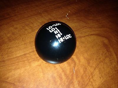

It's the wrong shift knob ..

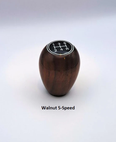

Option "B"
Think Ill go with a wood shift knob that will match the Caddy horn button and dashboard ..
Something on this order ...
Wanted to keep the wireless four channel knob in play, but with the long stick it no longer looks like it belongs

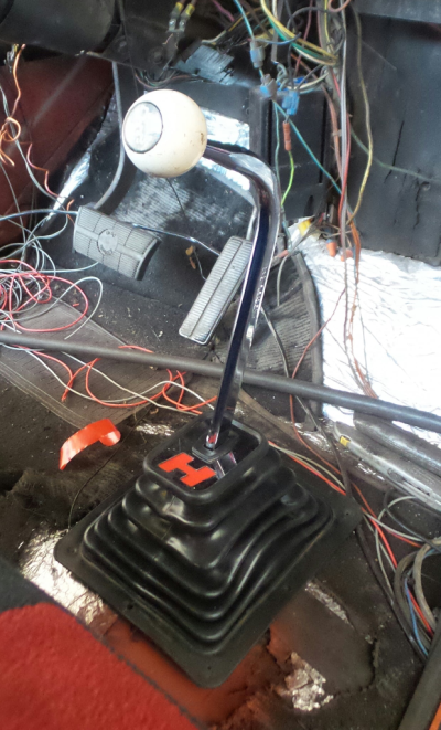

Looking Good! :cheers:

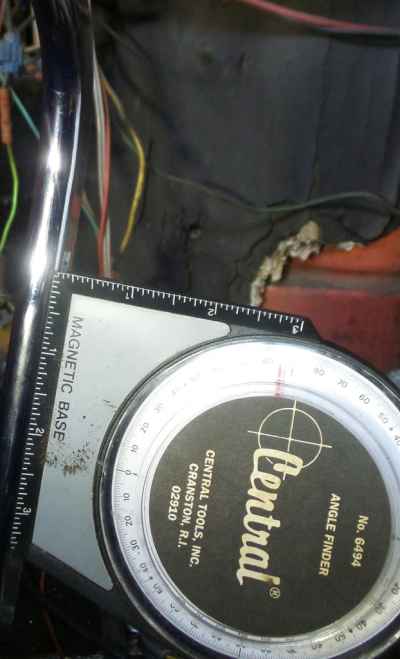

Almost ..
Got a small bit of lean going on ..
Got to take the T-case shifter off and heat up the welded on arm for a very slight bend ..
At the moment it's ...

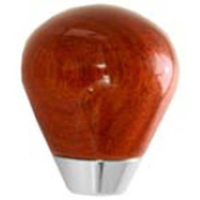

Found the knob that will be used ...
The chrome made the decision solid ..
( Dang old truck going to think it's a Bentley )
