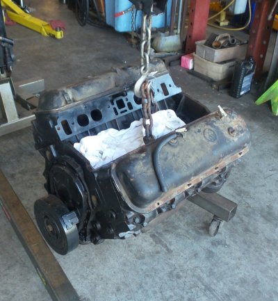

Really didn't need this, but it's one of those deals that you wouldn't want to pass up ..
Came out of a low mileage 1988 motorhome ..
One of these days the old Binder going to have a 454 Big Block in it ... Eek !!
I checked on the block's casting numbers .. Same block that the 1990 454 SS trucks has, meaning most likely it has 4 bolt mains, soon to pull the pan for a look-see ...

I'd bet money that's a 4 bolt...good find! :cheers:

GM did some wild stuff with the Gen IV Big Blocks ...
The casting number could be a two or four bolt block ?
Bout the only way to know for sure is to pull the pan ..
Found out something interesting about this motor ...
It could have four bolt main caps on a block that was drilled only for two bolts !!
Wouldn't be a biggie to drill & thread the other two outer holes in the block ...

It was a two bolt ...
Just as well cause I'm not planning to tach it past 5,500 rpm's ..
On the hunt for a set of 1973-up 049 oval port heads .. These have the hard seats, with a wee bit of port and bowl work, a slight increase in valve size might see around 550/600 HP ..
The motor came with peanut port heads, they are a alright head for a work vehicle, not so much a performance head ..
Dual plane intake, Holley 780 cfm vacuum secondary carb, long tube headers and a modest roller cam would be on the menu ..
I won't be in any hurry building it ... The 400 Mouse motor runs like day one ..

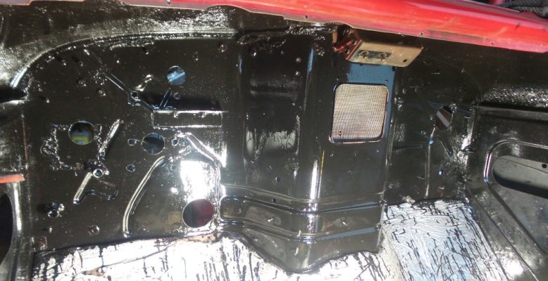

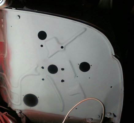

Onto another area of the build ... Wanting to get the firewall done ..
Laid down two coats of POR-15 on the inside ...
Working on the sound deadening matt under the cowl ..
Motor side is next to be worked ... It will see epoxy primer and bed liner ..

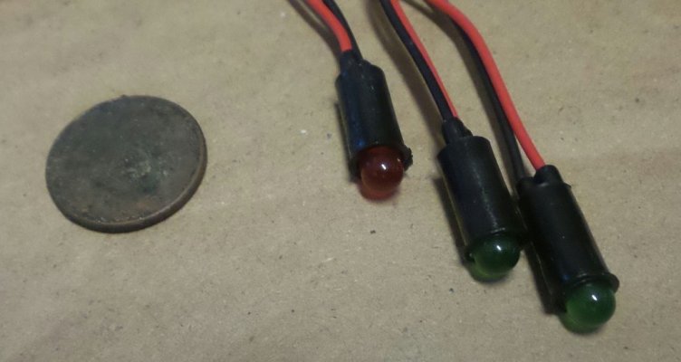

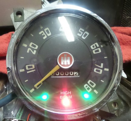

The dash is getting some finishing touches ..
Installing LED lights in the speedometer head ..
These puppies are so bright even Ray Charles could see em !
