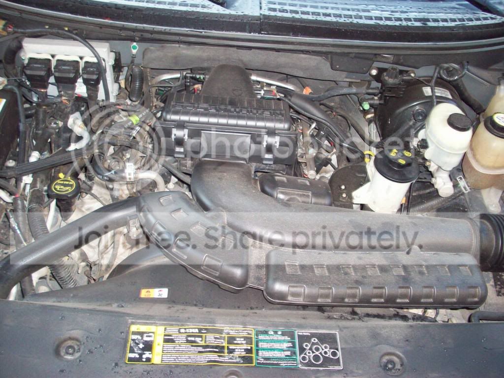

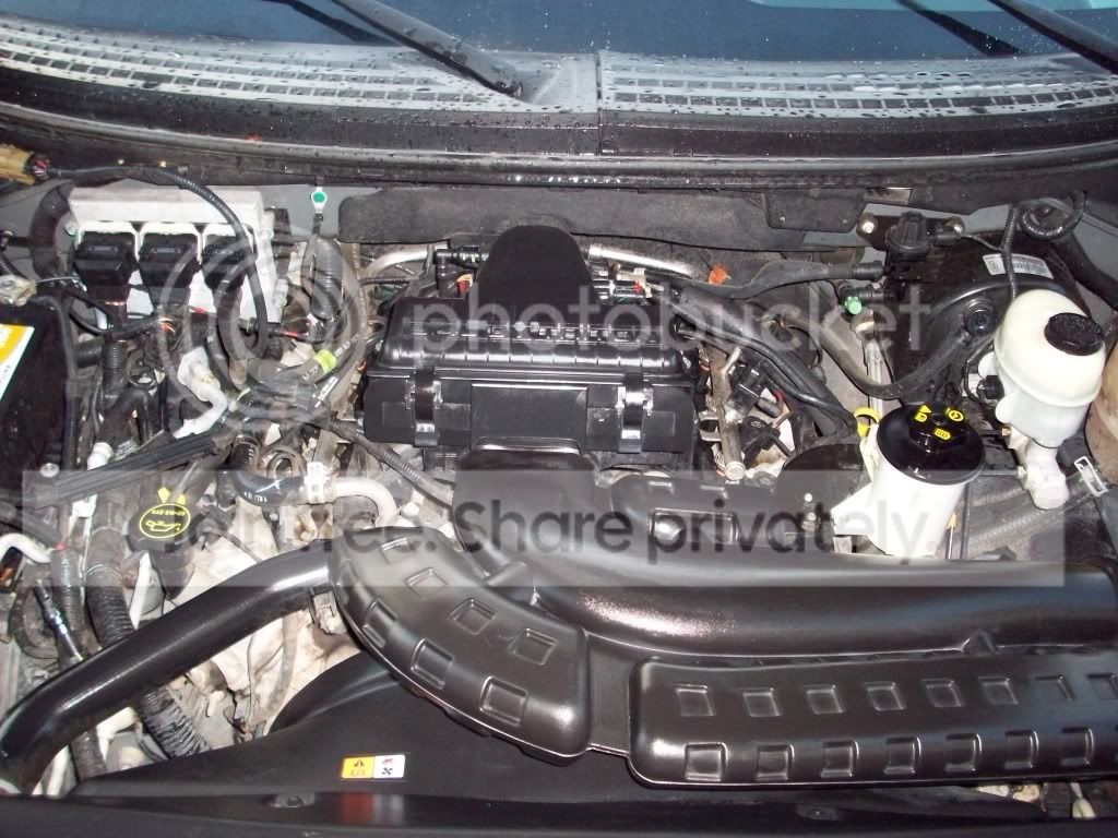

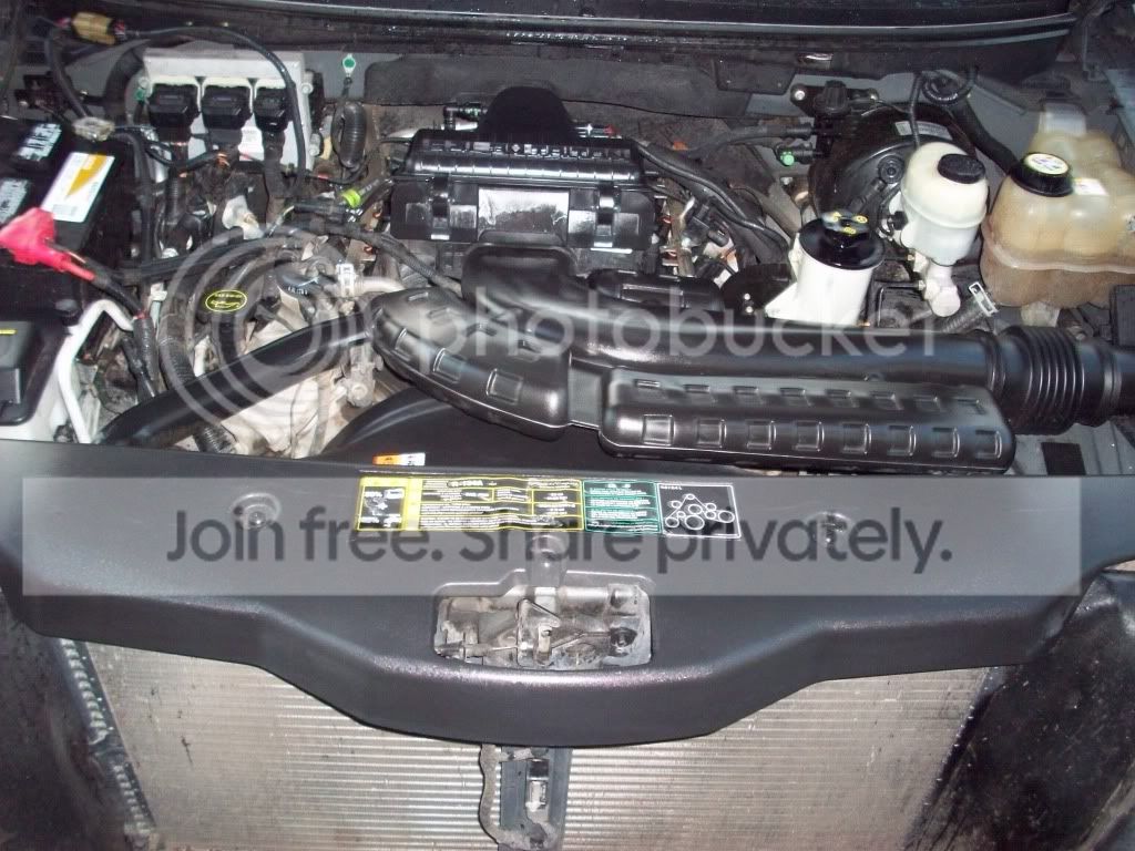

Open up the hood and see what you're up against. I did this a few months ago so it wasn't too bad just mainly road dust

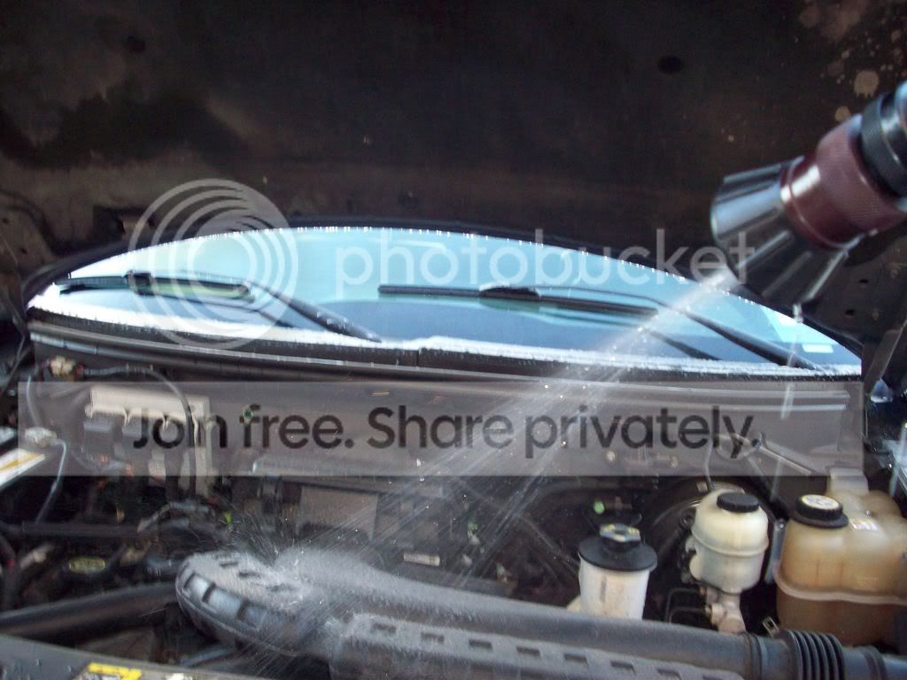

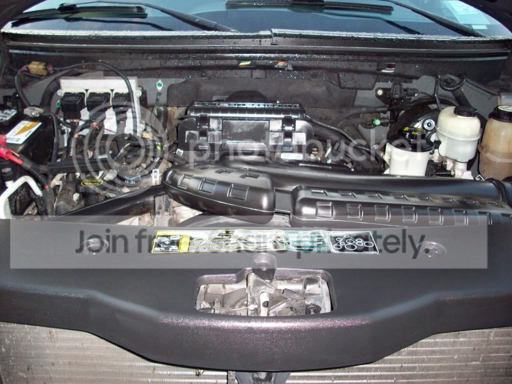

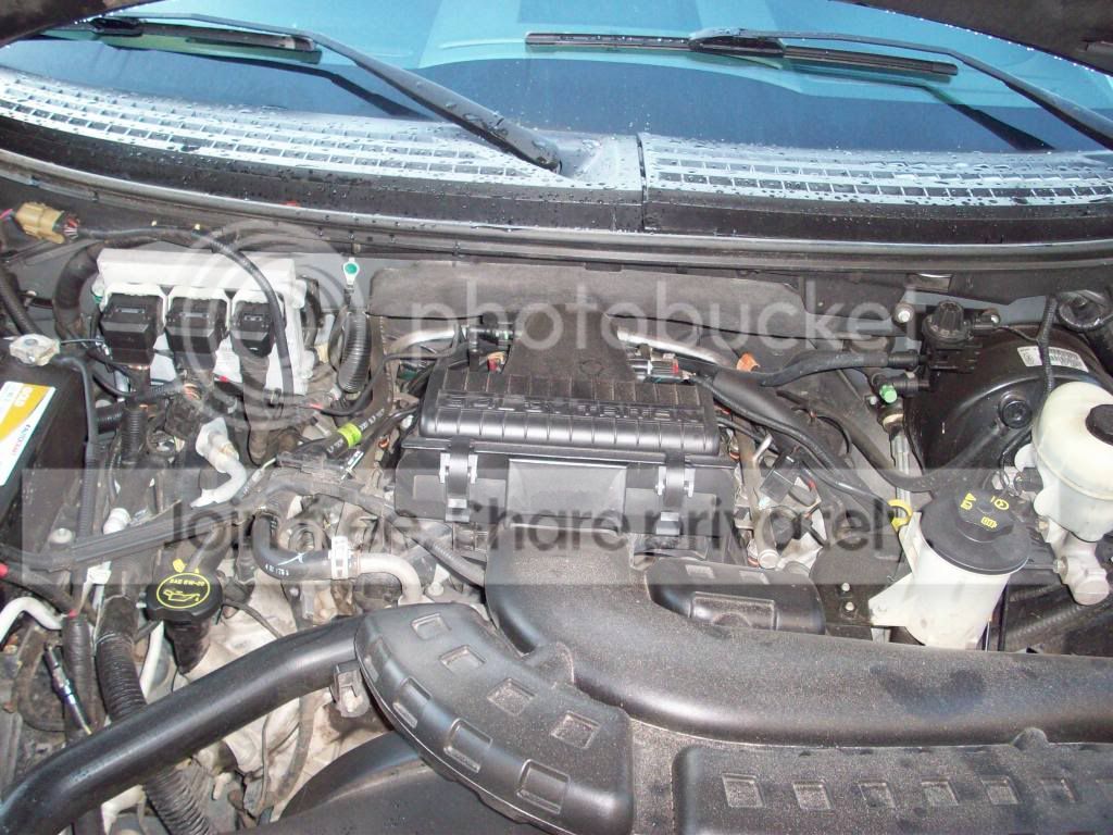

Start by using a light stream of water, easiest way to adjust is by pinching the hose and adjusting the pressure by feel

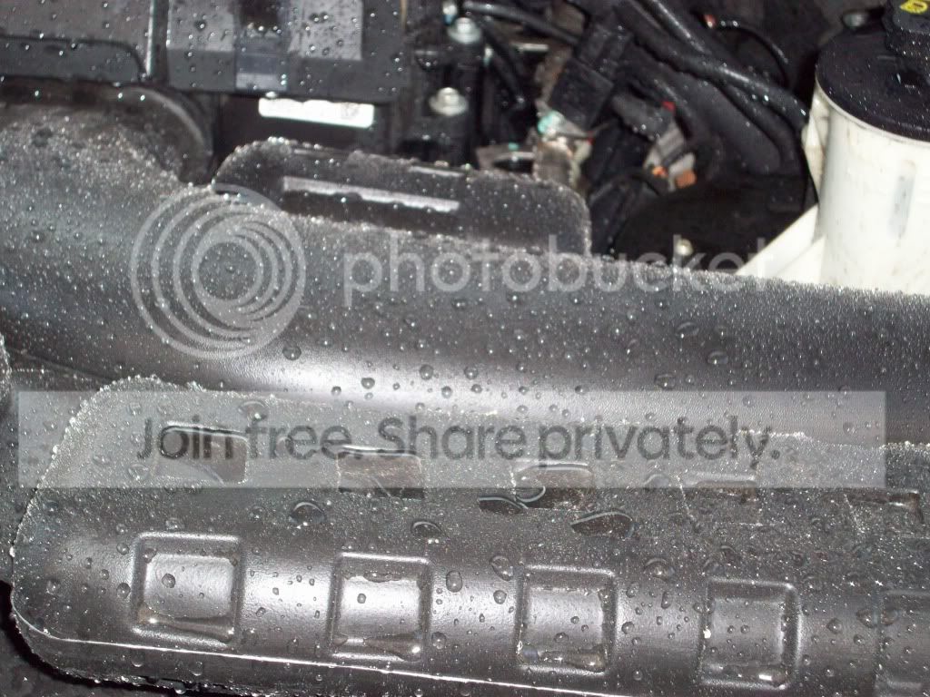

** You can see what SVRT does for you it beaded the water still after roughly 4 months under the hood :thumbs: **

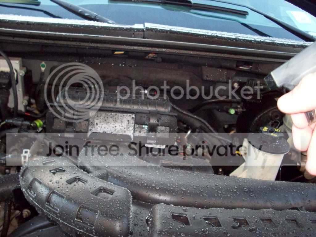

Let it soak for a second

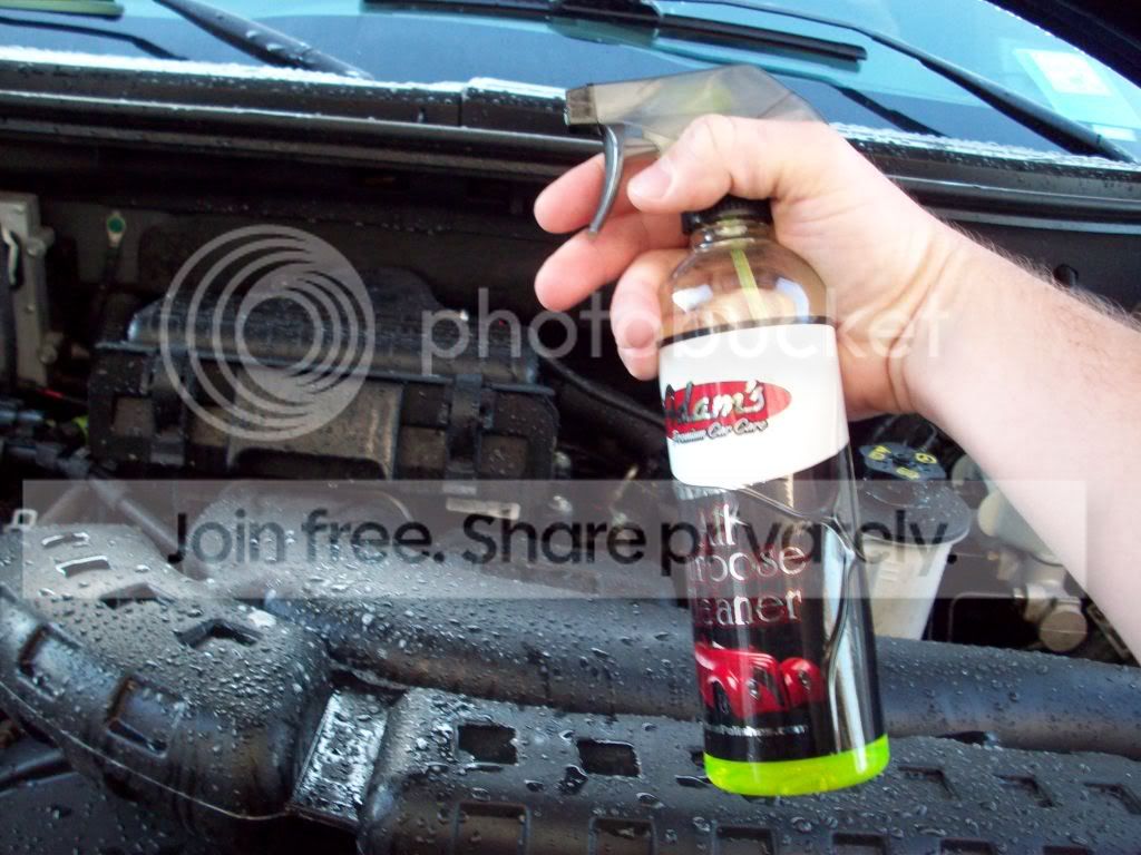

Spray down the engine bay with some APC

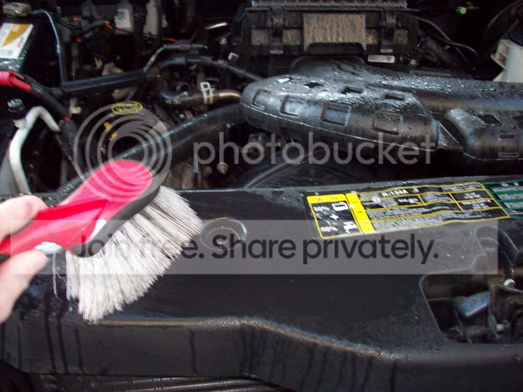

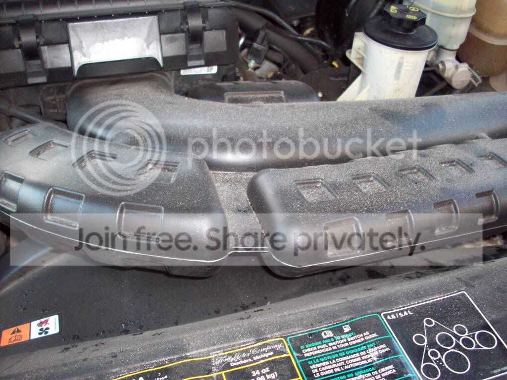

I used a small wheel brush from Mother's to clean the dirt off. It has super soft bristels that won't harm anything. Always be careful around connections and wires with it though
Then Rinse again.
Shut your hood and crank the truck for roughly 10mins or so. I vacuumed the interior while I waited.

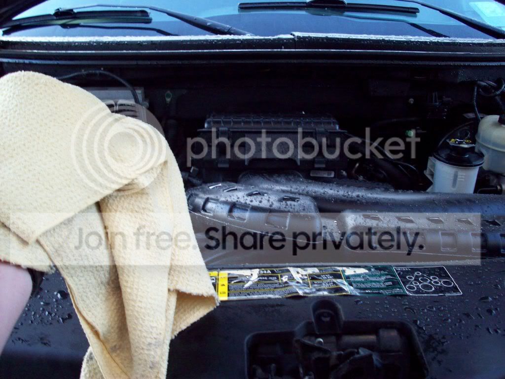

Open up the hood then Get to drying. I use an old Mequiars drying towel. Same towel I use to dry my wheels

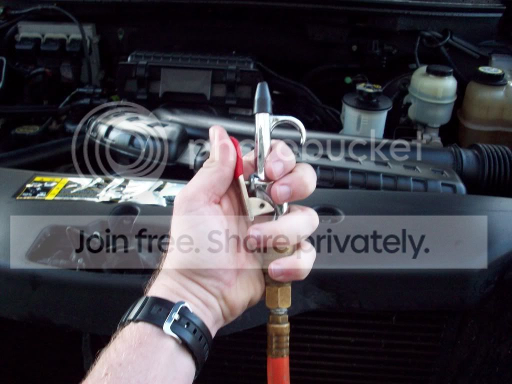

Get as much as you can with the Towel than get out your air hose and spray out the water in all the nooks & crannies

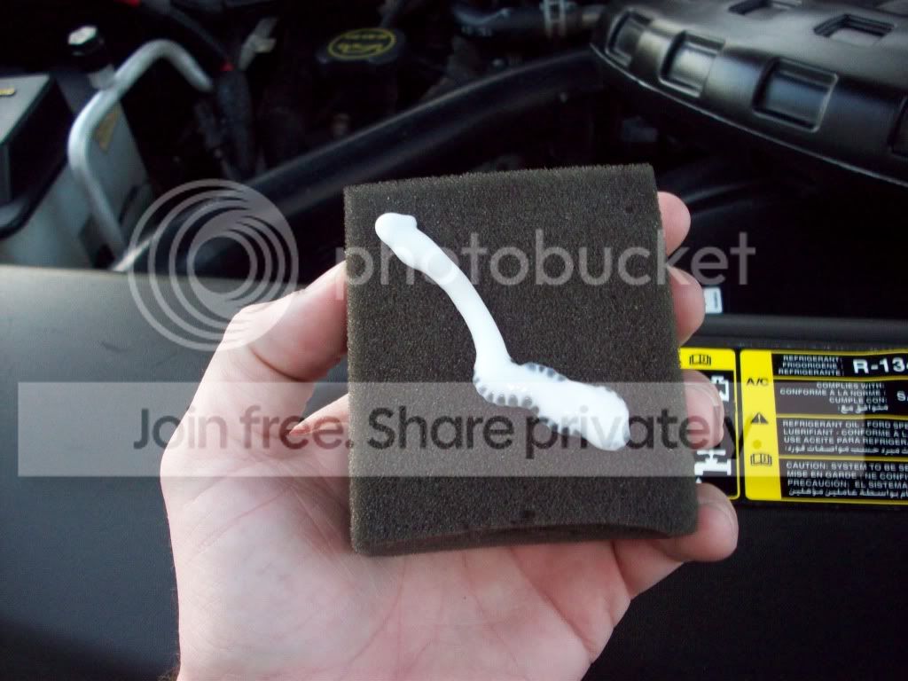

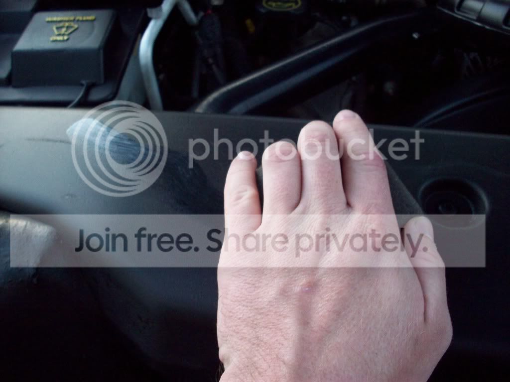

Apply some SVRT on to your detailing sponge and go to town on all the plastics and hoses

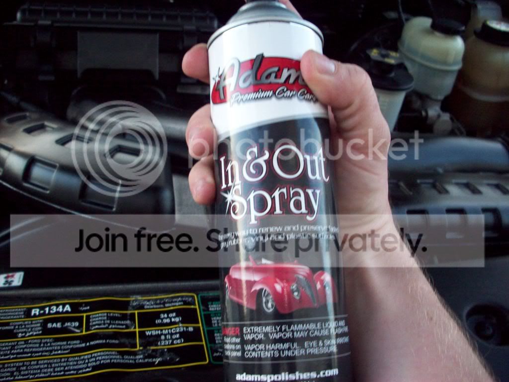

For all the areas you cannot get your hands to or for all the small spots and little areas use the ADAM's In & Out Spray
Now stand back and enjoy your hardwork
