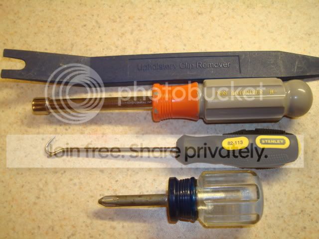

But the installation should be relatively the same on all 99-06 GM Fullsize trucks and SUV's. You will have to take off the top of the dash, its not actually that hard. You will need a 7mm nut driver, a stubby phillips screwdriver, a nylon prying tool (a flathead screwdriver might work, but may also damage the dash)and a hook pick type of tool.

Tools needed, nylon trim removal tool/prybar, 7mm nutdriver, hook tool, and a stubby phillips screwdriver.
