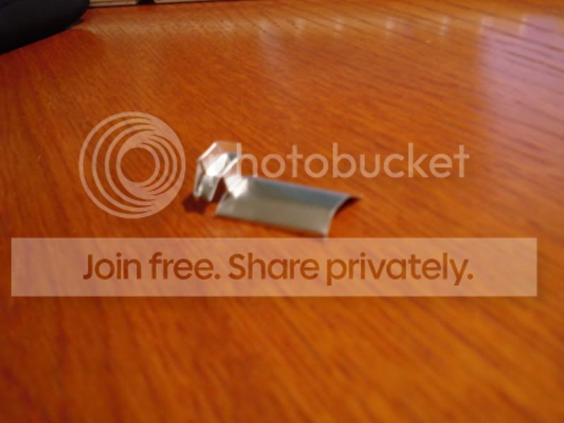

There are two options: retrofitting projectors ($$$$$$) or fit a custom "glare shield". Since I don't have the money for retrofits at the moment, I will be attempting to make a custom shield to cut out the glare. I will be posting as I go along and will continuously update with pictures.

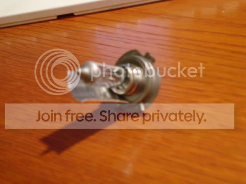

First thing on the list: buy a new set of HIDs for experimenting with. My old HIDs started having issues (bad brain box), and needless to say I wanted to take it apart. :D
Here's an idea of what I'm going to be attempting:

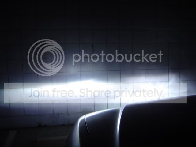

Before glare shield:

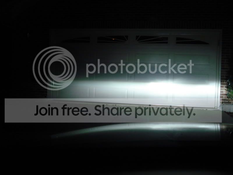

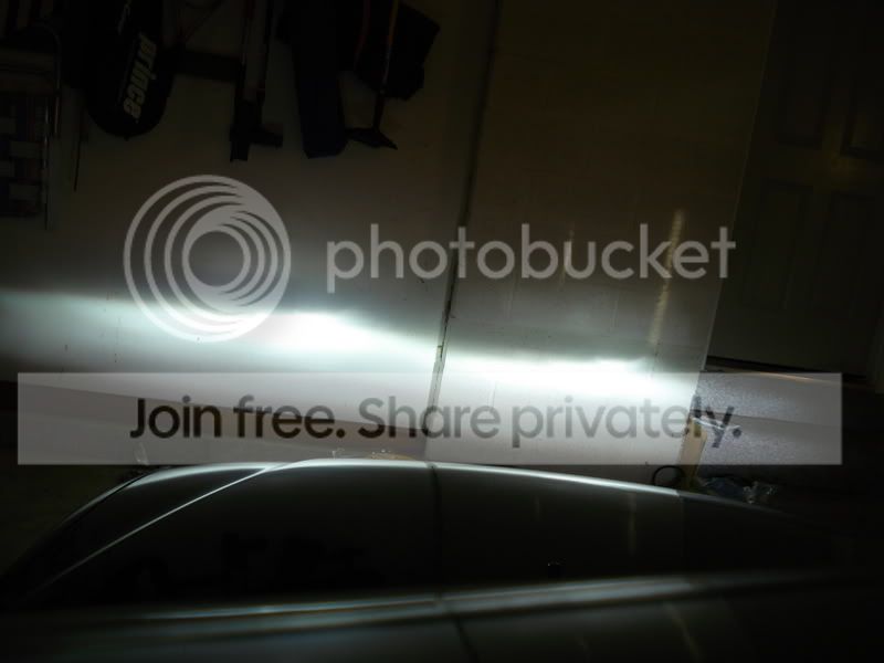

After glare shield (that cutoff is beautiful for such a simple/cheap solution):

What are you making them out of, and how are you attaching them to the bulb base, or are you opening the lenses and attaching them to the housing?
57,293
Seems like a valid idea. The only possible downside I see is it may shorten the life of the bulb if it reflects too much heat.
57,293
Man I have no clue there.
57,293
Might just work fine if that's the case! :thumbs:
