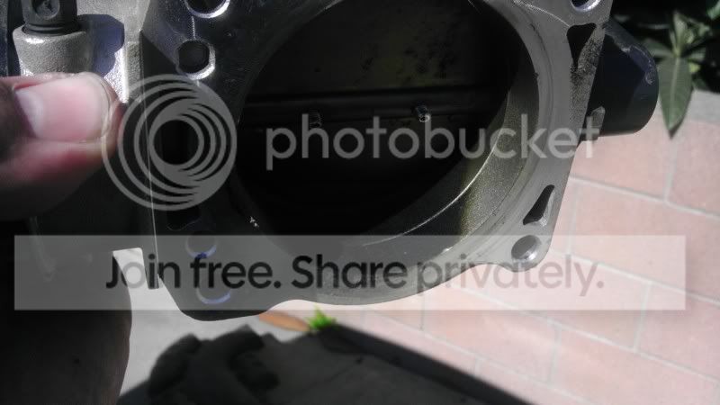

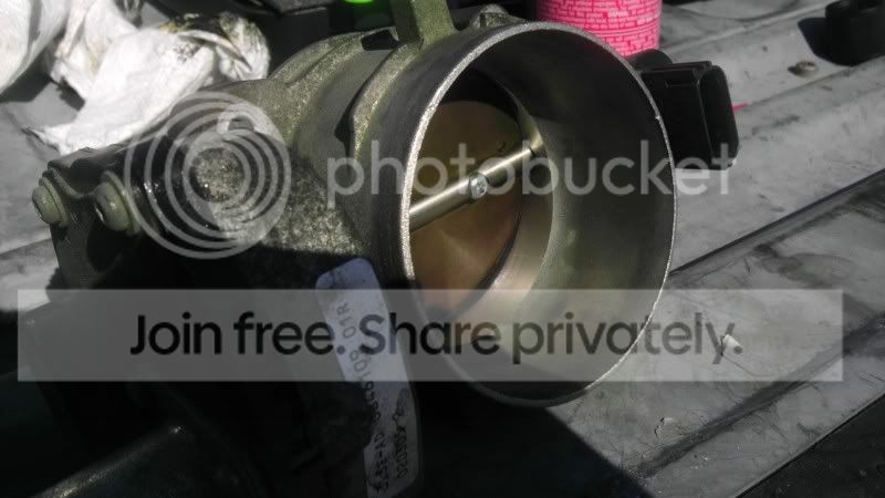

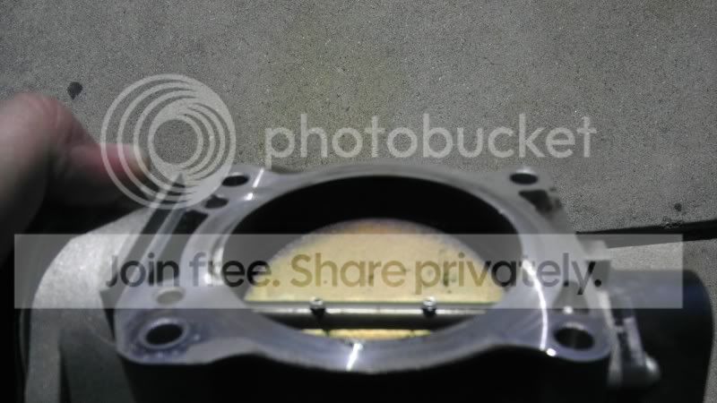

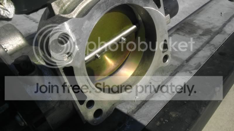

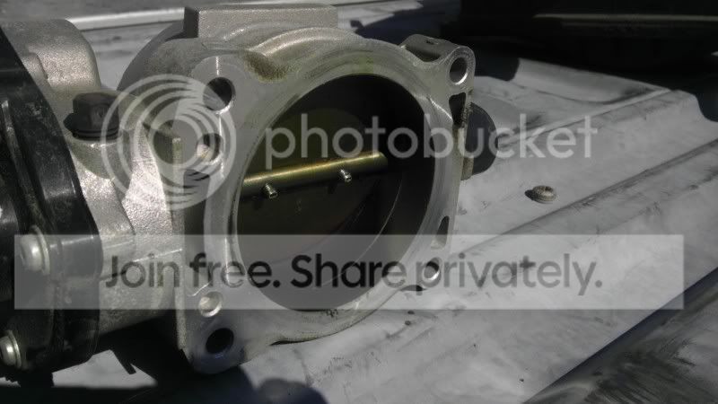

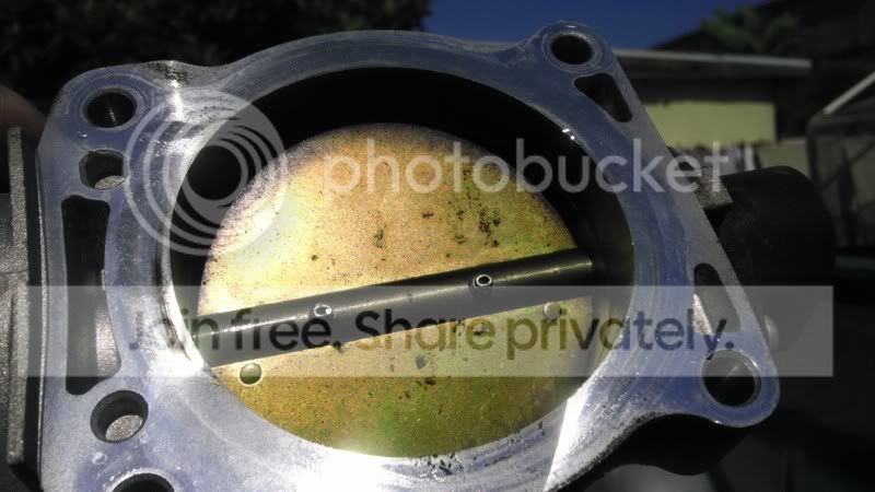

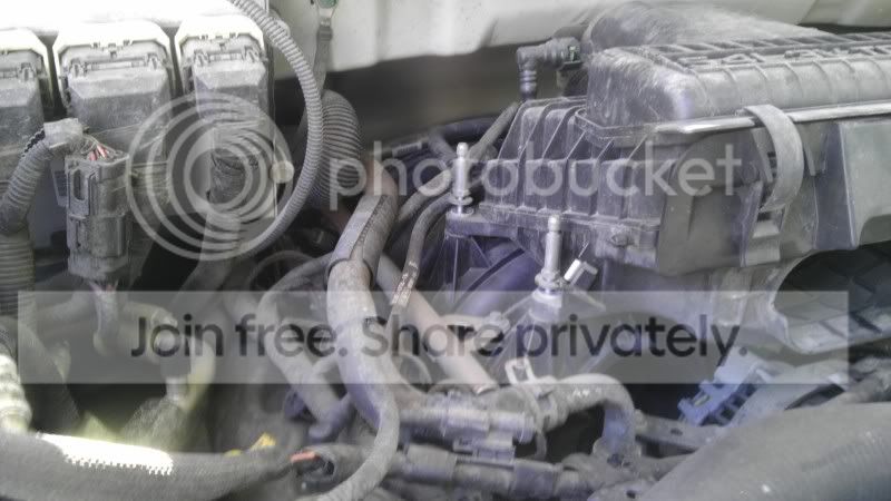

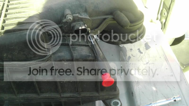

    Took the air cleaner assembly and the throttle body off.
    [​IMG]
    Its hard to tell from the pics but it was filthy.

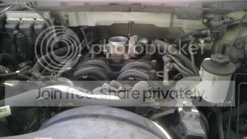

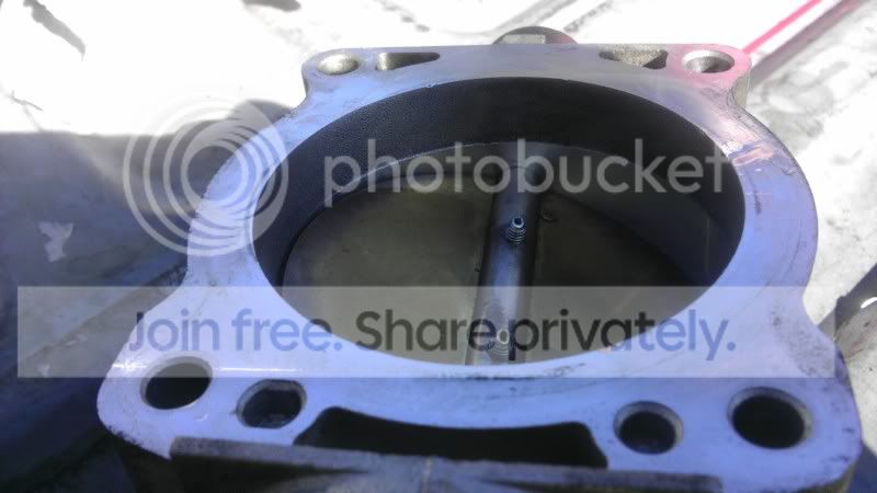

    Gave it a good cleaning.
    [​IMG]
    [​IMG]
    [​IMG]

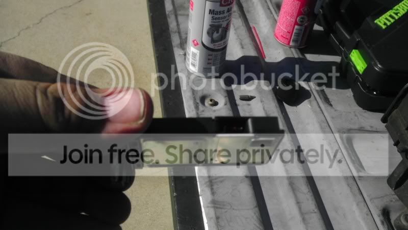

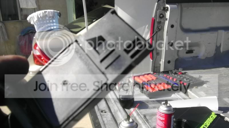

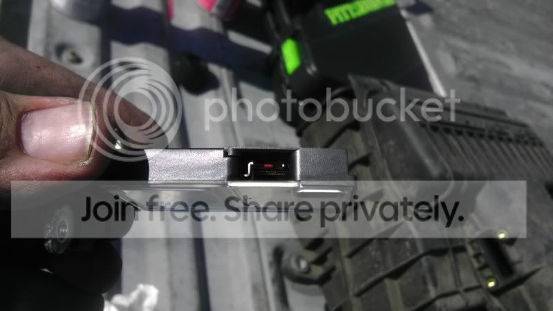

    Time to clean the MAF sensor.
    [​IMG]
    [​IMG]
    [​IMG]
    [​IMG]

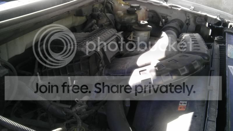

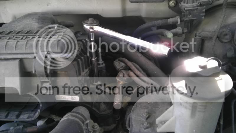

    Now to put it all back together.
    [​IMG]
    [​IMG]
    [​IMG]
    Took all the proper steps for the trucks computer to get used to a clean throttle body and MAF and took it for an 18 mile drive to test it out.
    The verdict:
    Throttle response is 100 times better and acceleration is much smoother. I even took the truck out to Eagle Rock to test it on a steep hill, well still got the miss. :(
    At 100K I knew it was most likely the plugs, so now a good chunk of my next pay check is spent. Felt good to work on it again! :thumbs:
