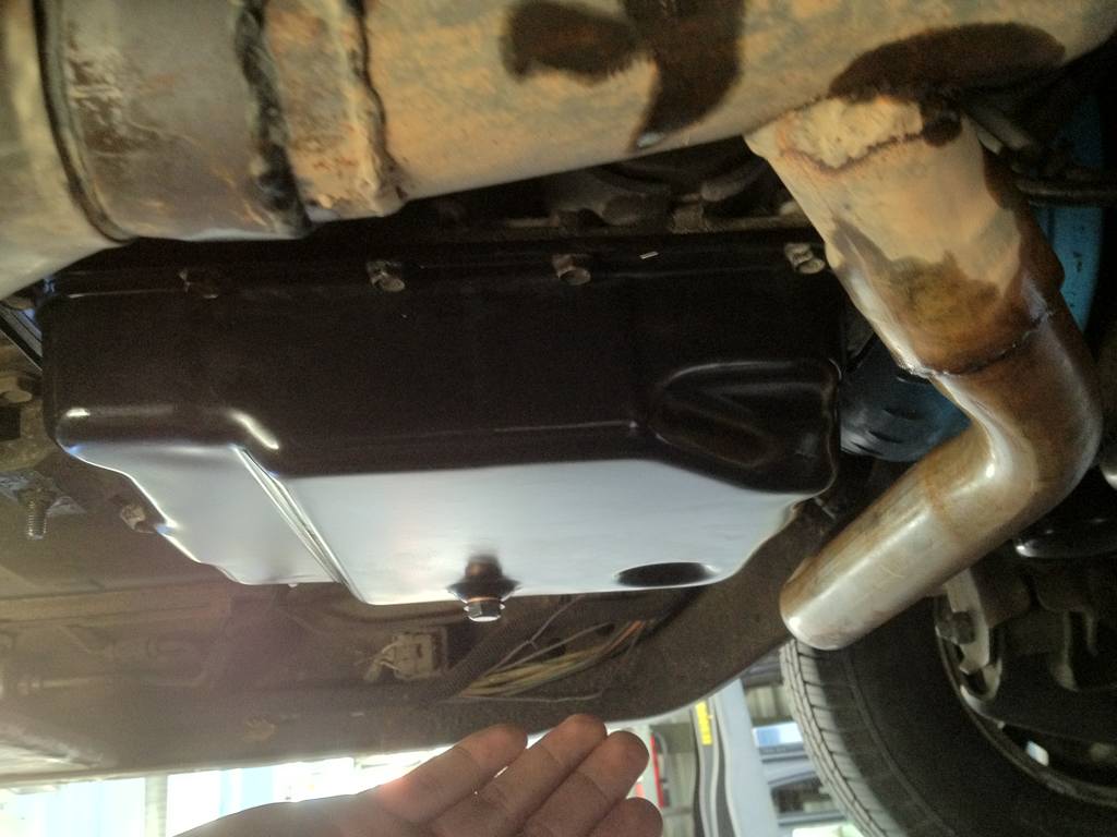

I saw that,thought that might be the one you bought.....no pic though.Dorman is good stuff and I wouldn't hesitate to order one,eventually. :thumbs: So,seeing as it holds two more quarts I'd have to assume it's a bit deeper,deep enough to drill a hole into it to put a temp gauge in?

You could drill a hole in it but I'd put the probe where the drain plug goes. Less likely to leak. I was actually thinking about moving mine there, right now it's in the test port. Here pic of the pan installed on my truck.
