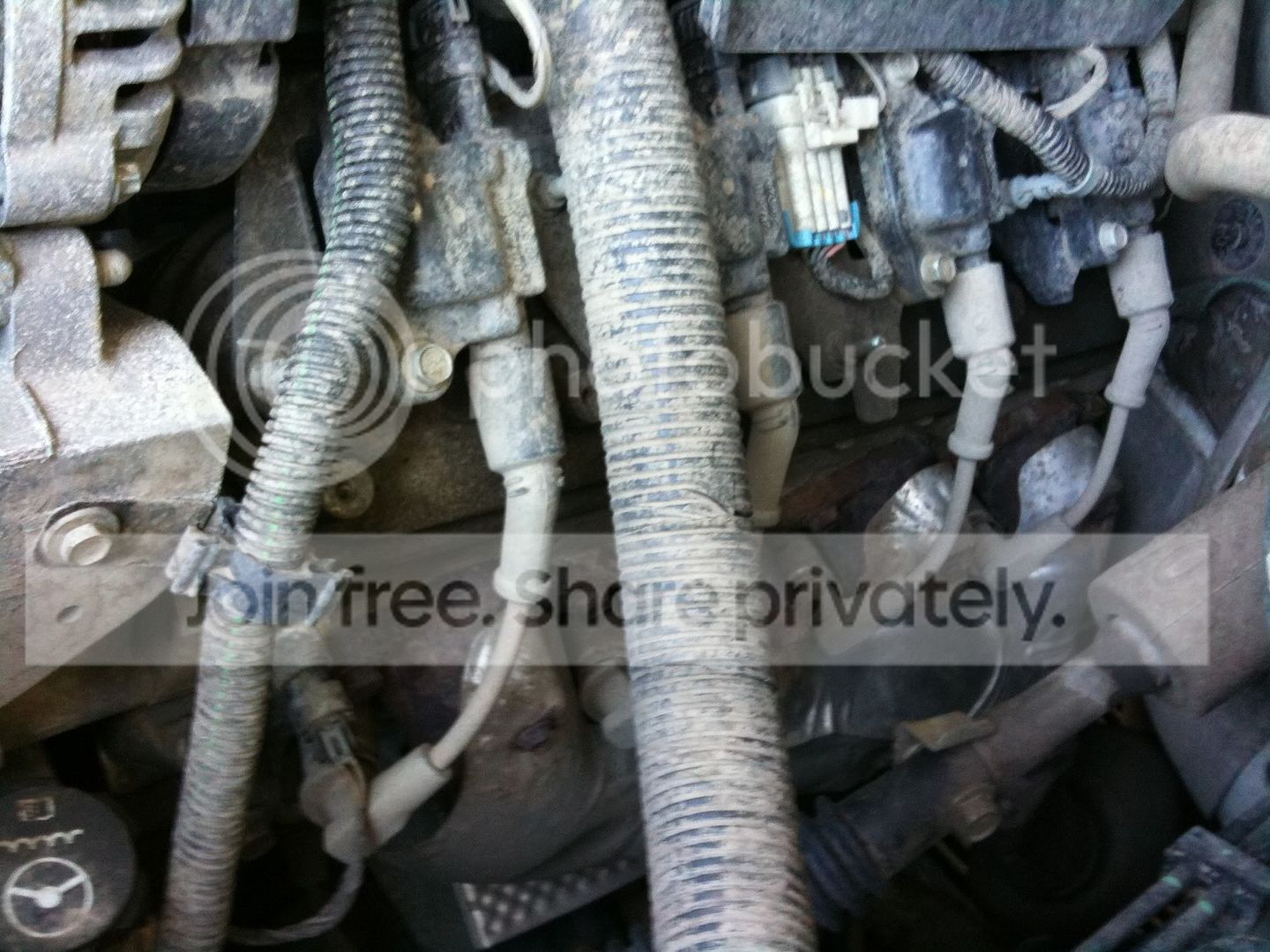

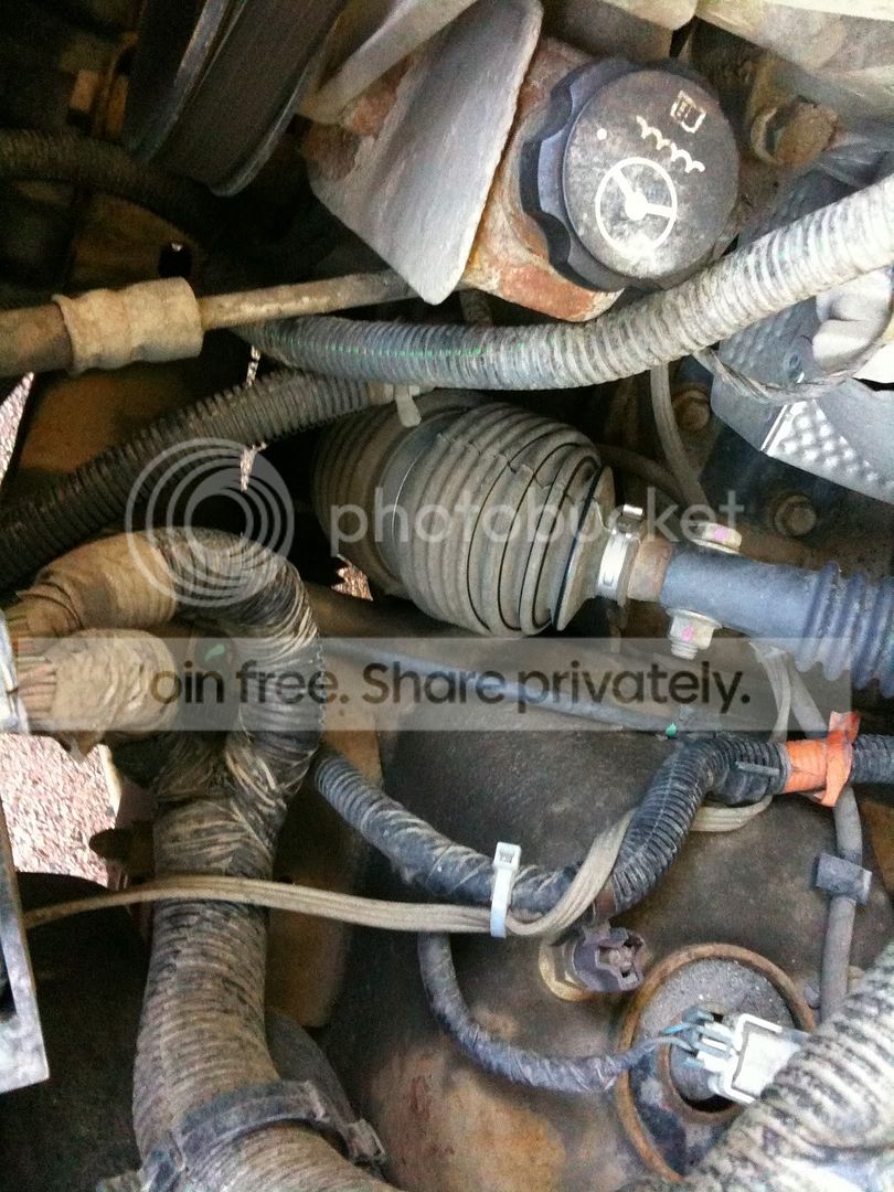

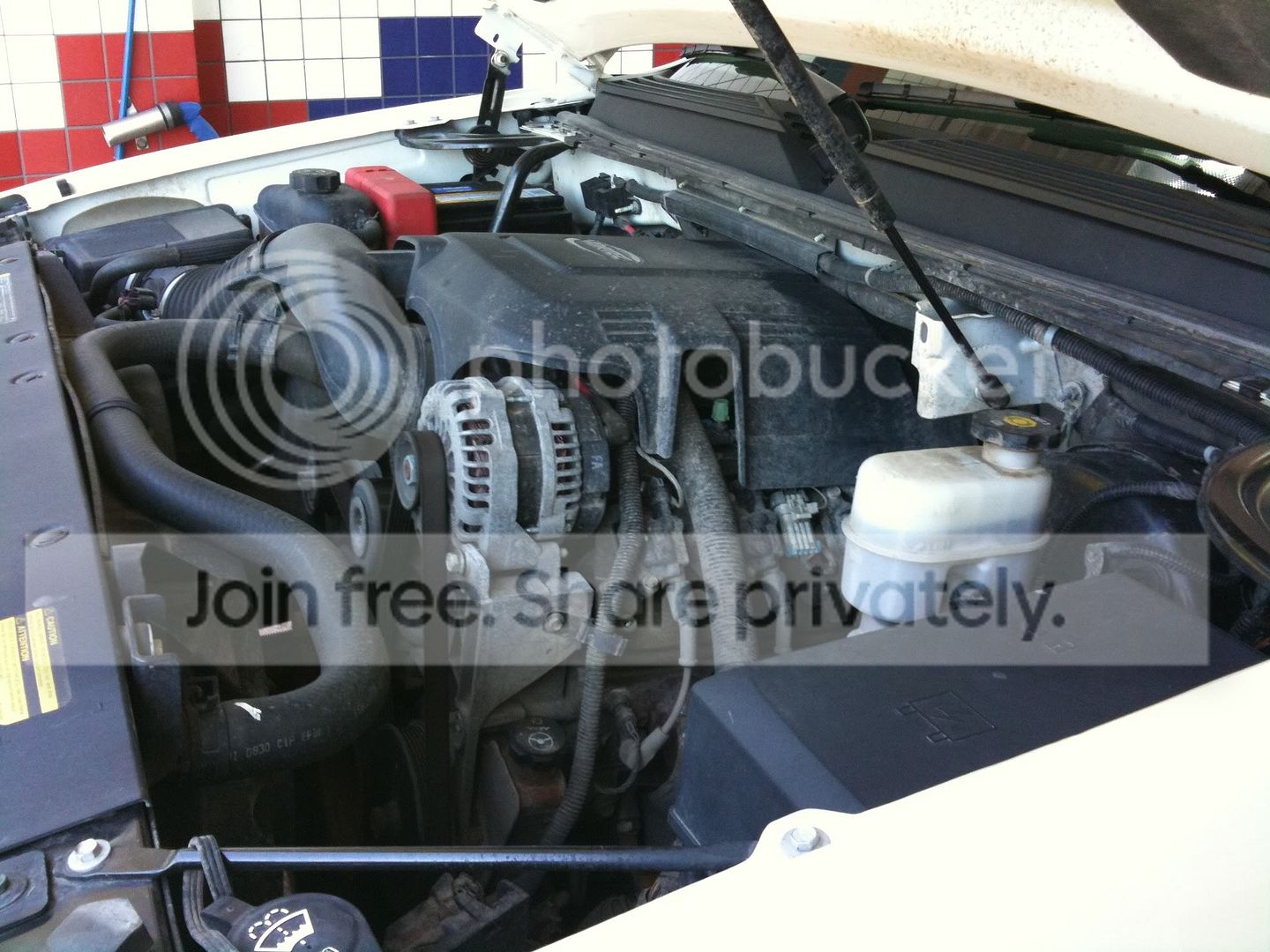

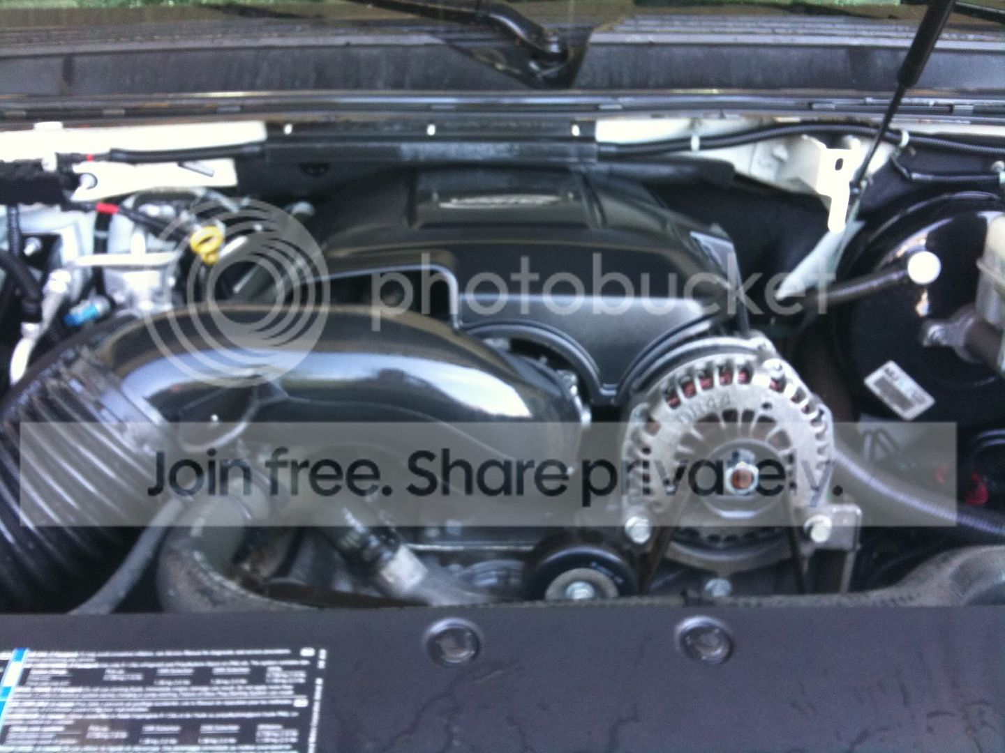

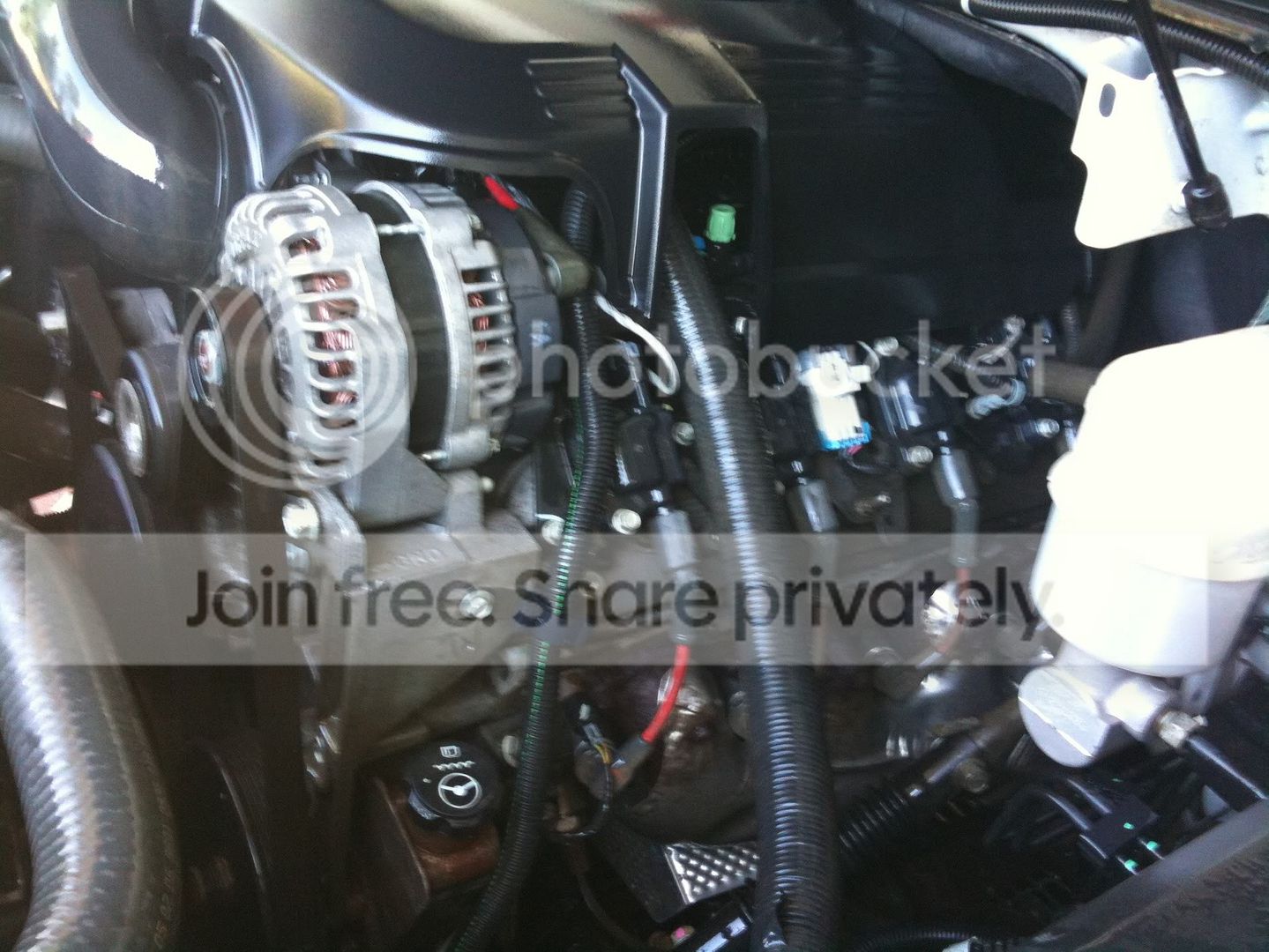

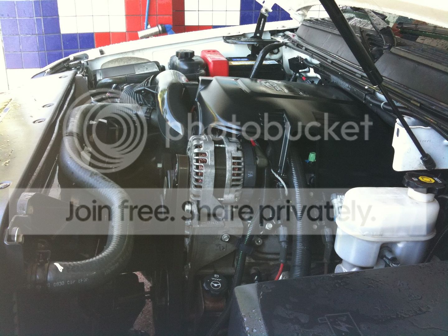

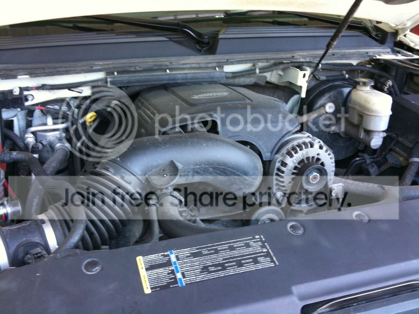

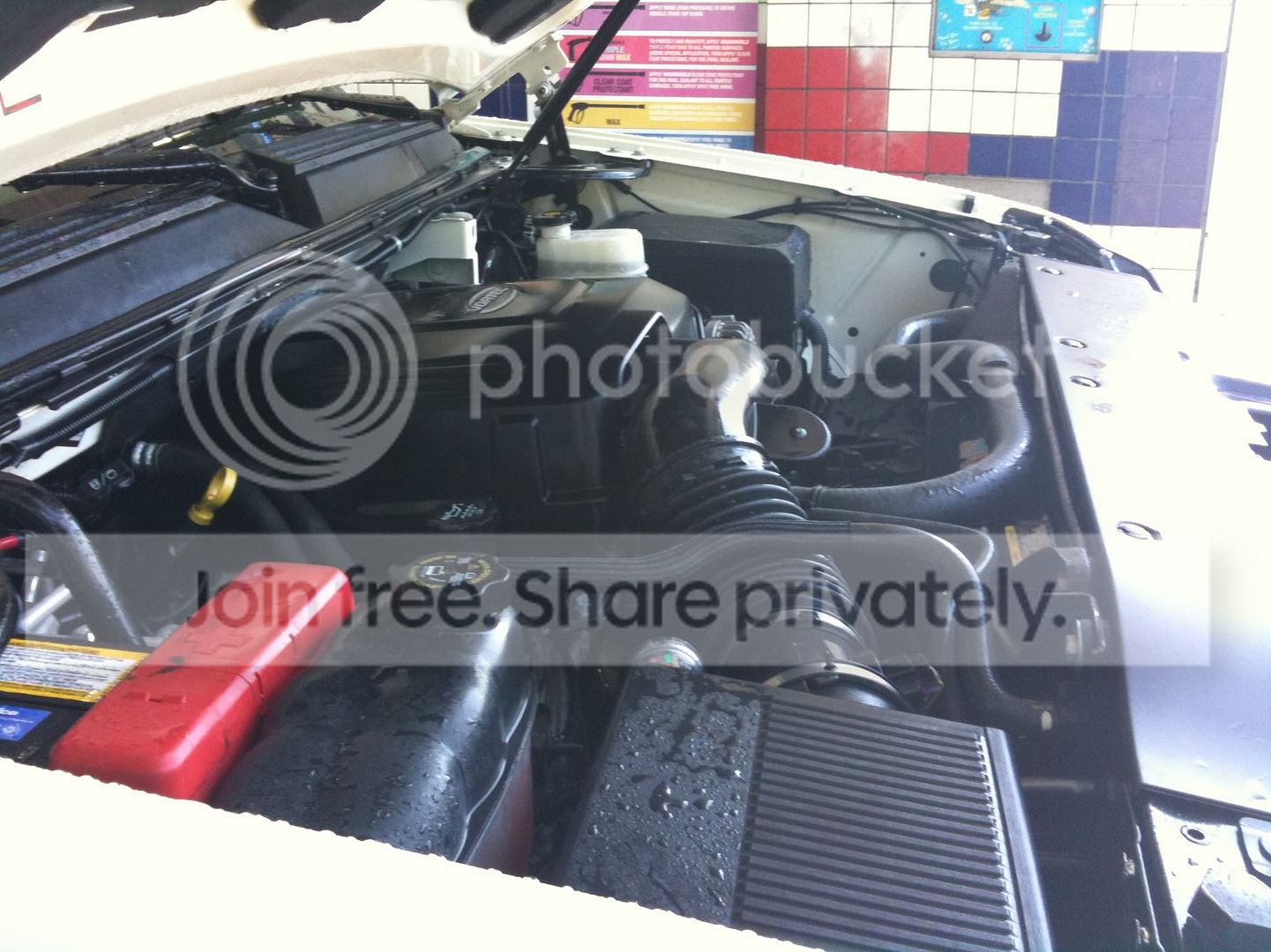

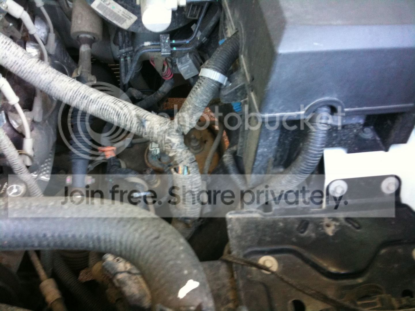

My truck's engine was just filthy. It was full of dirt and small rocks (got to love Canadian winters). I went to Canadian tire and bought a bottle of Simple Green's MAX degreaser. I decided not to pressure wash it at home. I then headed to the local car wash which has several bays where you can wash your vehicle. It is a good idea to spray the engine first, and then use the degreaser.
NEVER wash a hot engine. Be sure it is has cooled down before you start.
Product used:
Before:
After:
Note: Covering up your intake box, fuse box, or other electrical equipment is a very good idea. I didn't do it, but doing so, you can potentially avoid a disaster (e.g water getting in the intake).

Nice job. I clean my engine bays with a 4:1 water/simple green ration to clean.

:thumbs: Look's real good. The only thing I cover up when I do mine is the distributor.
