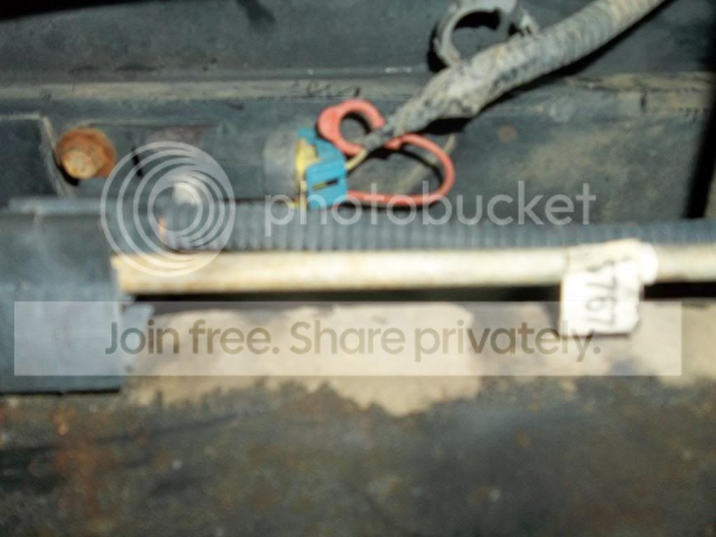

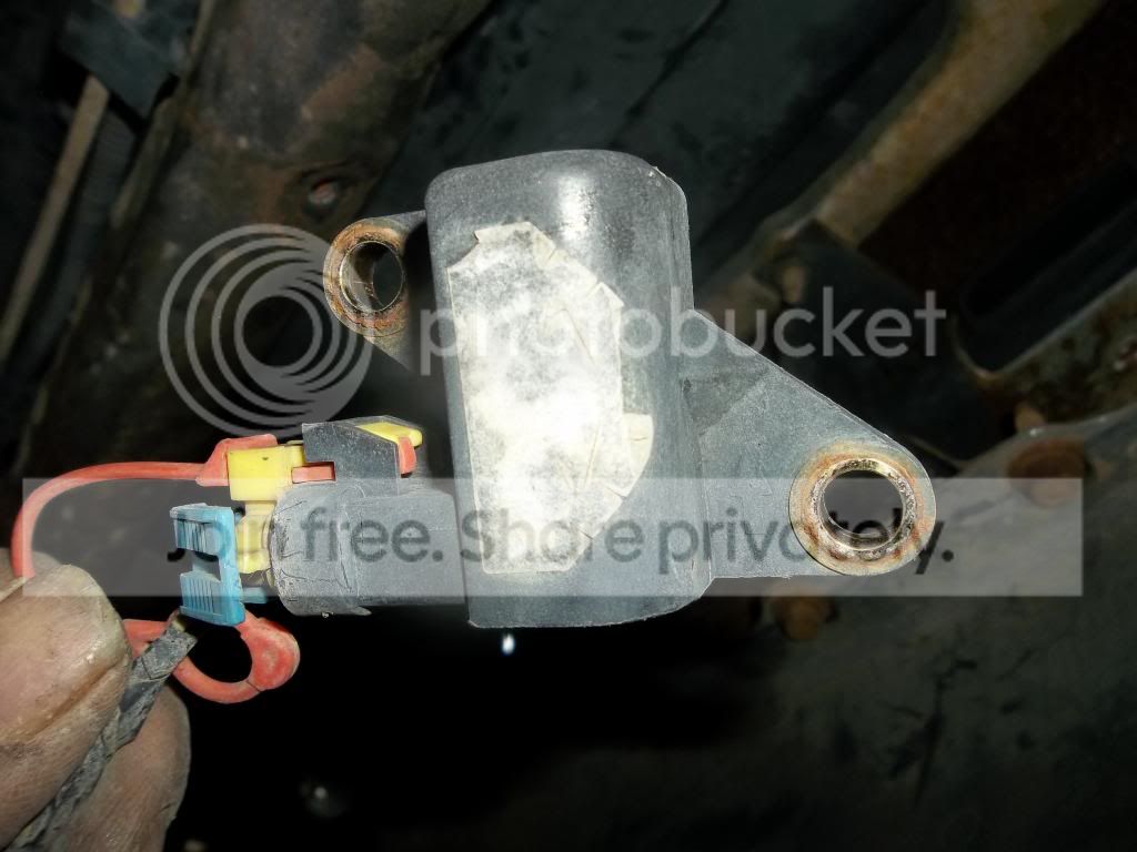

Because I'm replacing all 3 front light sets on my '02 Silverado, I decided to go through and re tape wiring as well as adding new wire loom. I found this piece on the frame in the center of the front in the run to the passenger side.
What the fWONk is it? :dunno:
Thanks for any help. :cheers:

put it back ASAP. that is the front end SIR discriminating sensor....jostle that little thing hard enough and you will be redoing more than wire replacements.

WOW :eek: The damn thing should be BRIGHT red with warning labels on it. :lol:
Good thing I TRY to practice safety and siconnect the battery when I'm fWONkin' with electrical shiz. :thumbs:
It's back on and the truck is running.:cheers:

Its cool, the dead give away is the bright yellow connector and the large red retainer. All the airbag connectors look very similar to that; it is very hard to actually disconnect the physical connection because that retainer is so hard to remove.
Yeah well my dumb ass DID have a hell of a time taking the retainer out then putting it back in.
Good thing I didn't fWONk something up.:ohnoes:
