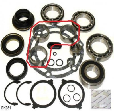

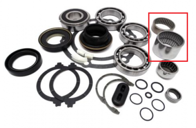

I bought a BK-351 rebuild kit for this transfer case and it is the one that has 3 identical needle bearings, about 2 inch OD and about 1 inch wide but there's another kit (same number) that has just one of these and instead of the other 2, what looks like the same OD needle bearing but twice as wide with 2 rows of needle rollers.

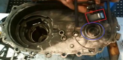

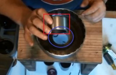

The front output shaft uses one short needle bearings for the rear support and it seems the other 2, or the double wide one, go into the clutch housing to support the clutch hub (see pics).
Scouring the internet, I found pictures that only show the dbl wide bearing but there are also exploded diagrams that show 2 of the same bearing going here; however, when checking the PN for these bearings, the clutch housing and front output shaft bearings always have different PN's.
My guess is that the 2 separate bearings was for an early version of this transfer case but now the single, double row bearing is used. Also, more than likely, the PN info was updated but the diagrams were not, so they still show 2 bearings for the clutch housing. This is somewhat backed up by service bulletin 05-04-21-005 which states:
