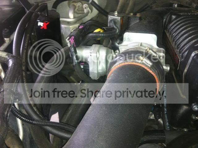

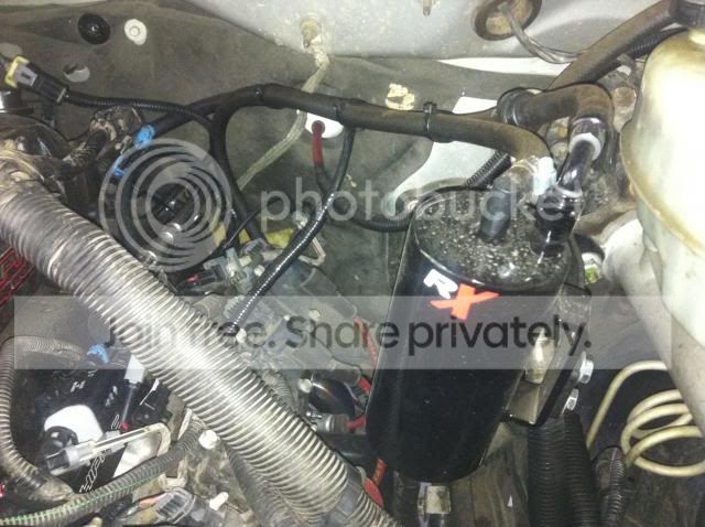

    Just one on the dirty side or drivers side is enough. I catch about a teaspoon a month.
    I do run two RX catchcans. One on each side. Added insurance, I guess. I would of purchased one that collected from both, but since I already had the one, I got another instead of combining.The one on the passenger side does trap oil vapor, but not enough to see drain out. It is aiding in not coating the intake tube though.

    Thanks for the pics! I do think I will stick with the single on the drivers side.

    I had a light oil film on the intake side. For added insurance, I added the can so further accumulation doesn't get on the rotors and bypass valve. Since I put it on, probably a drop or two has come out, if that, a month.
