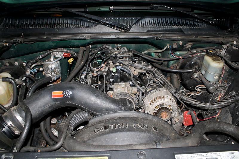

Looks like you got a kit for an '05+ truck with the electric fans. You need one for a '99-'04.
In this picture, you can kinda see how the front of the tube is flattened out to fit the fan/shroud.
http://i213.photobucket.com/albums/cc275/2000Silverado4x4/Knock Sensors/IMG_0404.jpg
You've got two options, convert to e-fans, or get a different intake.
Then why buy the whole kit when all i would need is the air filter? cause my stock tubes would be pretty much the same thing as a CAI kit.
The tumors that act as sliencers in the stock tube are where most of the restriction comes from.
That said, the most you're going to pick up from a CAI is throttle response, and a FEW ponies. Nothing noticeable though.
If I were to do it again, I'd just put a good reusable filter in the stock airbox, and get the Airaid MIT (Modular Intake Tube).
